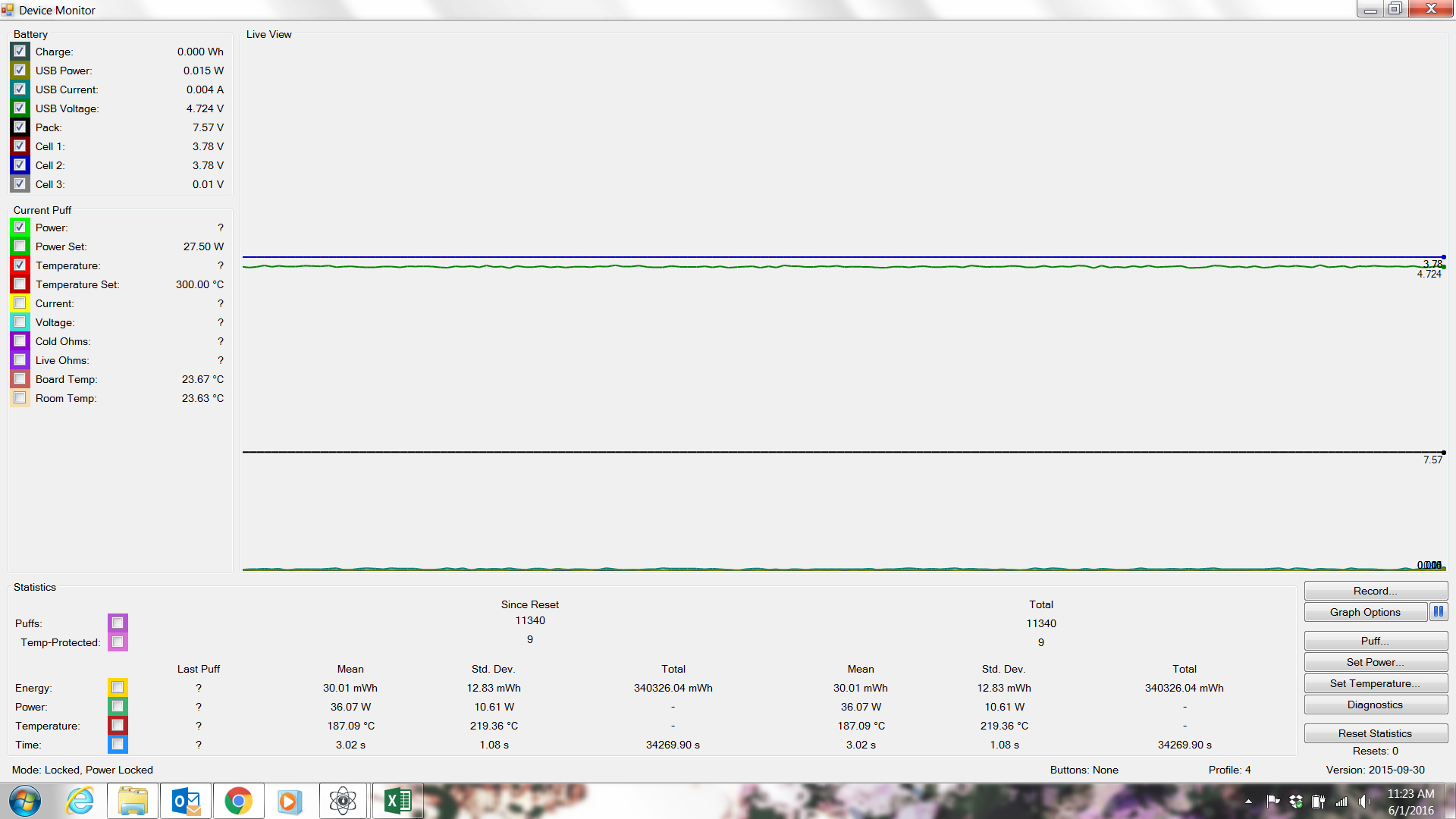

  2. Guys I have encountered a Warranty Service error on not 1 but both my DNA 200 mods (Lavabox & HCigar VT 200) at the same time. Previously it was already indicating but nothing severe. I even connect to Escribe prior to check if it was a firmware issue but it isn't. Now both my mods are not able to charge and it is worrying especially when both uses the 3 cell lipo battery pack. Kindly advise.
  3. Tried a hard reboot but to no avail too.... I believe it could be like what you guys are saying, a bad lipo or joint issue. If anyone has other solutions, I would be glad to try it out too while I resolve this issue with the vendors.
  4. Yes it is running at 3 cell. Is there anyway to rectify this? It is a HCigar VT200 mod.
  5. Hey there, Nope it does not rise to 0.5.... the most is 0.005...
  6. Having the same issue. Can any kind soul advise? Already did recovery charging but to no avail.
