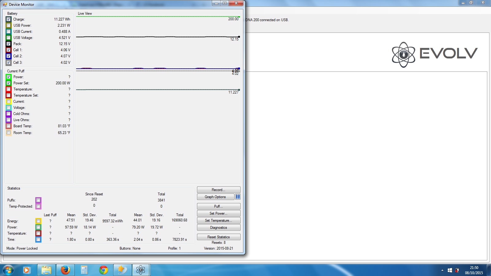

Hooked it up to escribe, all cells reporting 4.1V which is expected, but the issue is when i try to fire the mod. cell 1 drops to 3.89, cell 2 drops to 3.59 and cell 3 drops to 3.66 so would i be thinking along the lines of a weak cell? -

Is this likely to be a dead mod or just a dead battery? -

If i set the battery capacity incorrectly, does the chip automatically stop charging at 4.2V in each cell or will it keep going until the set WH is reached? Just a little concerned because in Escribe my battery pack voltage is fluctuating between 12.60 and 12.61, still charging at 0.5A and is approx 300wh from full charge.

Ok ive just seen on another thread that they got 1150mah from the battery analyser inside escribe. A couple of hundred mah i could understand or tolerate, but not under 2/3 of the claimed capacity.
