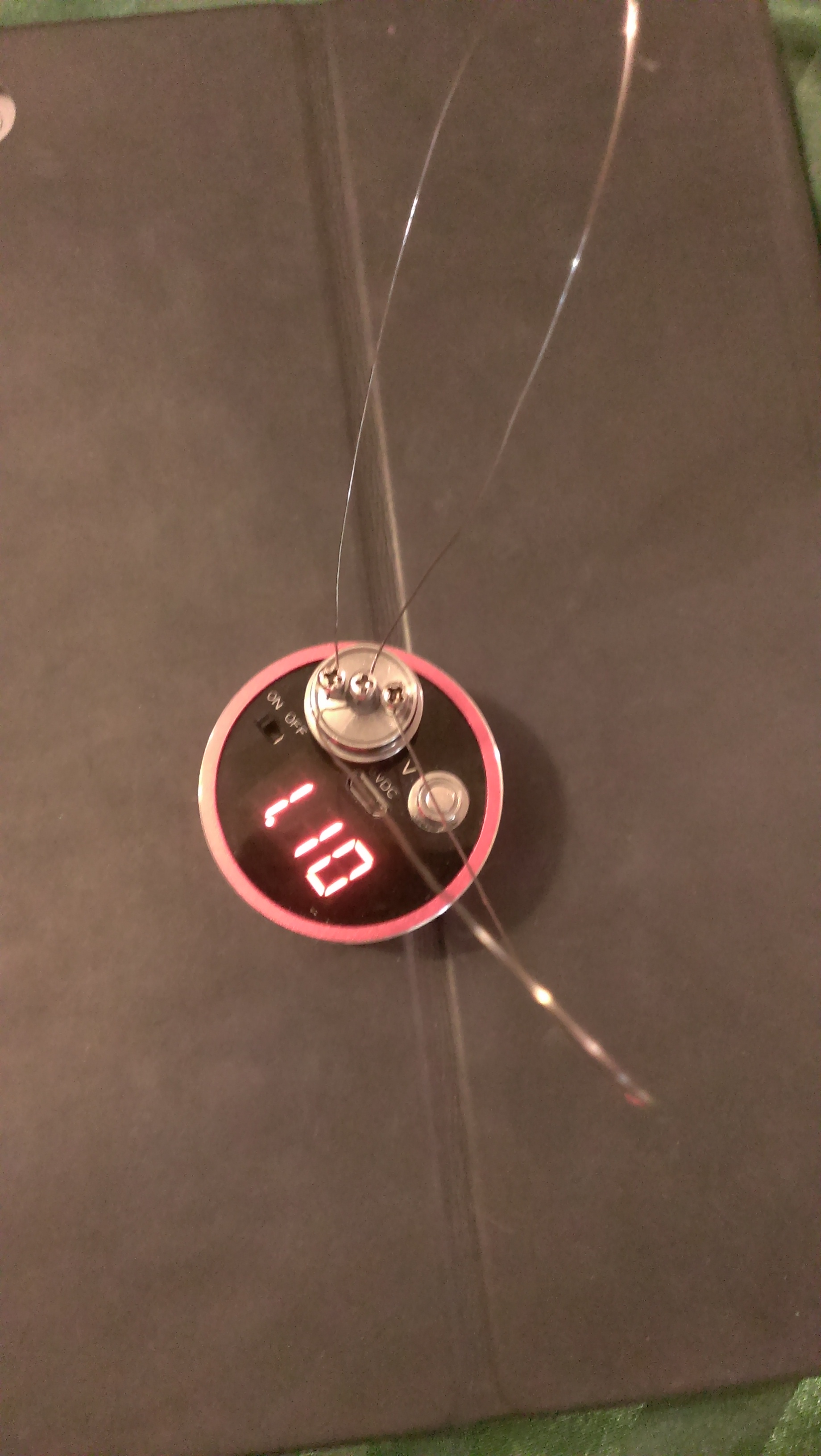

Yea just make a loop or a couple loops depending on your atty and just place it on top the device for the loop to air cool.
Wouldn't bother making coils, they retain to much heat on the atty. Just make a loop or a parallel loop and there's little to no heat retained on the atty / 510. Think the one I used was a couple 6" long strands of 26g kanthal coming in a little over 1? and worked fine.

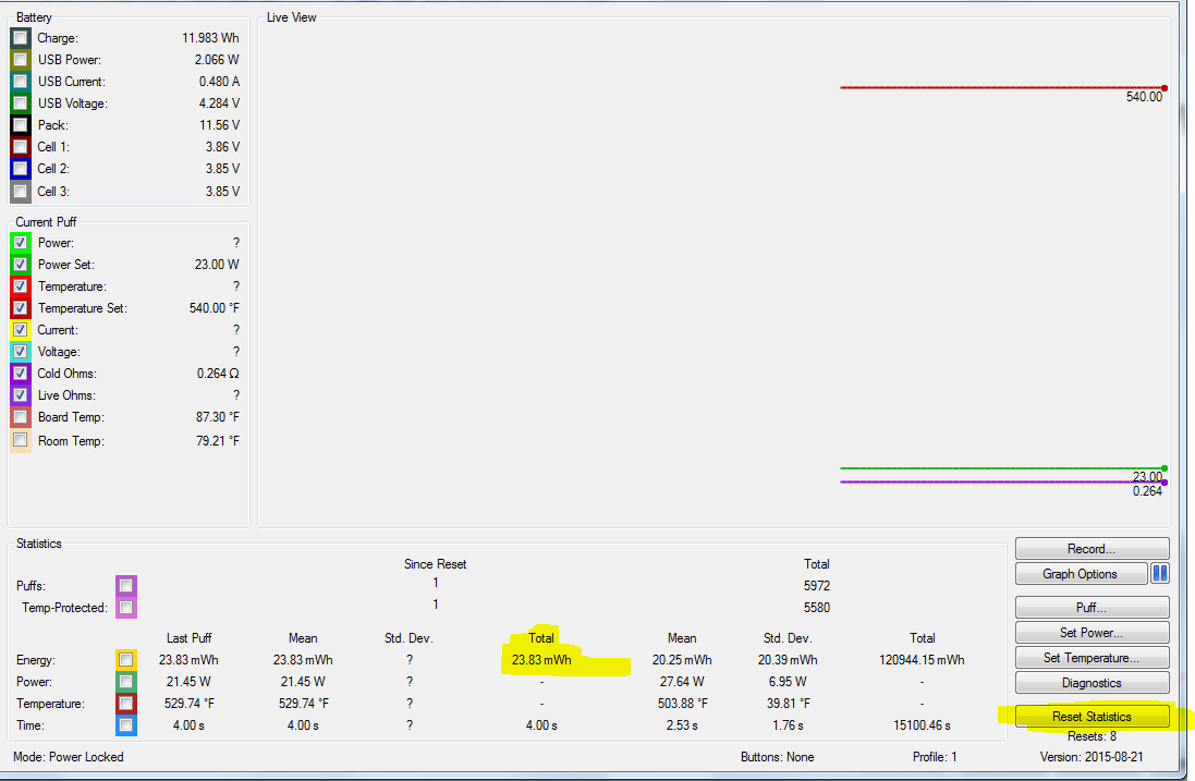

Something else to consider, looking at the specs of the Istick 50 that I seen showed 4400mah 2x18650 parallel, The Hcigar VT200 listed 1300mah 3s series so the watt hours calculate out at about 16.28Wh for the Istick 50 and about 14.43Wh for the VT200. So if the specs I seen are correct and my calculations are up to par there is more capacity with the Istick 50 so it makes sense to get some additional usage from the Istick at lower power settings, not necessarily what your seeing though.
Hopefully I'm understanding statistics correctly, if not someone can correct me. But it's kind of hard to compare battery capacity to someone saying I get a day out of mine when they may take 4 second draws every 15 minutes or so and you may take 10 sec draws every 5 minutes. If it were mine I would put a full charge on it, and either Reset Statistics in Device Monitor or write down the Total Energy mWh then use the device without charging it any further until I received the Weak Battery notification (making sure Cell Soft Cutoff is set correctly). If at that point your Total Energy is around 14Wh then it's performing pretty close to specs. If it's a little lower it may just be over stated battery specs. If it's significantly lower it may indicate a bad battery pack or something within the device.
I think the screen charge% is based off of what you've configured in the Watt Hours in Escribe and uploaded to the device. Also I looked at my Battery Analyzer log to see roughly where it was at when my cells were at 3.87V and it was slightly above 50% through the test. just for comparison, I have the same device & battery as you so I suggest letting it charge & balance fully and putting a build on that's within the Data Sheets specs for the power setting your trying to achieve.
If I read the data sheet correctly you cant get the full 200 watts with a .501? coil. It appears you can only get the full 200 watts from roughly about .075? - .41?. And as mentioned your cell 3 isn't balanced very well you may be running into a sag problem until the battery is fully charged and balanced. Also your showing 10.62 watt hours on your charge but cant see what you have it set to in your Mod tab. I would make sure the battery charged and balanced fully (should be 4.2V on each cell) using a coil under .41? and see if you can achieve the 200W. And to your other question, from what I've read if the device detects data lines it's supposed to limit the charge current to .5A so going through a PC USB I believe that's correct. Charging through an external charger I can get 1A charge but on my PC it's usually under .5A. Only a couple times it's been at .9A but I believe that to be a bug in the charging logic and I'm unable to reproduce it. Also if you have windows 7 look for Snipping Tool, makes screen grabs much easier than taking pictures.
3.8V is not fully charged it should be 4.2V. Guessing your seeing 100% charged on the device due to the 9 watt Hr or whatever Escribe has as default where you have roughly 14.5Wh. According to the 1800mah it would calculate out to 19.98Wh you could give that a try. A screen capture of your mod tab settings and Device Monitor might help but it doesn't sound to me like you have a charged battery at all.

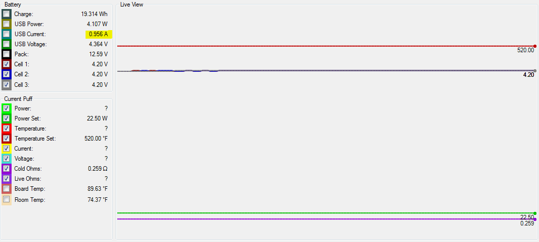

I'd recommend to any of your customers they not charge overnight and only charge while they can monitor the charging cycle. I know I've read one of the admins state the board will not charge over 4.2V and that as the battery gets closer to full charge the charge rate is trickled lower so not to overcharge the battery pack. But from personal experience I can say that's not always the case. I've seen on a couple occasions (which I haven't been able to replicate) that the board was pulling close to 1 amp instead of the typical .5 amps or under when being charged through PC USB, while the battery pack was at or close to full charge. Disconnecting the board and reconnecting it brought the charge back to the normal .5 amp or under in both situations. I'm not sure what scenario causes this issue but since the DNA 200 board is in control of the charge rate I assume it has to do with some of the logic on the board. I'm a bit concerned with this charging anomaly so whenever I charge I keep a close eye on the Charge, USB Current and USB Voltage. Attaching a screen capture of the second time this occurred. Make note of each cell voltage of 4.2V, USB Current at .956A & USB Voltage at 4.364V while the pack is practically full charged Pack at 12.59V. Most of the time with a battery pack this fully charged I see the charge rate trickle down as expected and only see a few milliamps but not always in this example. No idea why it was pulling 1 amp (twice what it normally is when connected to my PC) or why it hadn't trickled down when the cells were reaching 4.2 volts. Possibly something similar happened to your customer and caused the issue while being charged unattended? -
