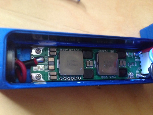

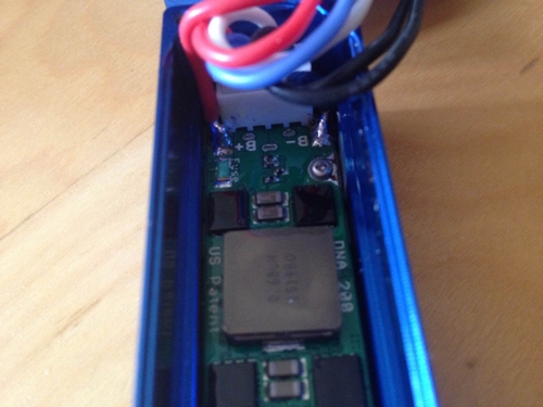

  5. So they indeed fixed it. (See picture) Yes there is a connector. That must be the balancing. This is why i was confused. There are two thick wires from the battery soldered to the board. My device was setup on the 6th August by hana modz. So it seems they fixed it a month ago. Yay! Now if someone could show me a fixed ground i would be very happy. I am an assembly programmer but i know absolutely nothing in electronic :-( Reason i ask is because my resistance is sometimes read very low when cold. Even at 250C i get a cool vape. If i lock it 0,010- 0,015 higher then it vapes fantastic. Also despite the case analysis, the room temp is often quite off... Not sure how important the room temperature is for temp control other than to calculate cold resistance. I appreciate answers to my questions. Thanks guys and sorry if i ask stupid things
  6. Brandon, i see you mention the JST connector. I have seen people talking about JST connector before. Are you talking about the one going to the "+" and "-" on the board? It seems earlier version of hana modz had two connectors and users could remove their battery. now, there is one connector, but + and - are soldered to the board.. you can't change the battery unless you unsolder the cables. I am interested to know if there were indeed two connectors or if i miss understood. I don't know anything about electronics and connectors.. Also i wish someone would post a picture with a properly grounded hana modz.. i see a lot of posts about it.. but no picture, nothing.. Attached picture of my board.. Let me know if this one still has JST connector problem.. it seems the ground is empty, so i suppose it is not properly grounded still.. please help.. i get some weird 510 reading sometimes, i have to lock ohms to vape correctly
