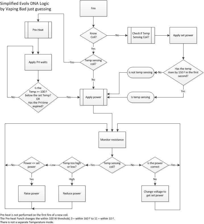

	That diagram is very helpful actually. Hopefully just for future people Evolv will come along and say "Yeah VapingBad was correct again!" Thankyou for explaining it
	So with that logic... If the punch is on 11 (and 200w) it will ignore the power and go for the Temp-10 degrees... So I'm guessing the mod will just go with the lower of either when it goes to fire?
	So lets go with 100w 1s and preheat SOFT and preheat HARD on 400F? If it throws 100w surely it'll always have the same punch?
	Thanks for the reply Vapingbad. This is how I imagine it to work and understood it to work. However if setting the punch defines how close to the temperature it gets why do we set a power option aswell? In my head... Power = temperature - raising one raises the other... So how can you set the power and have the punch change the heat temp? If possible I'd love to see two number examples (even if not completely mathematically accurate)
	Hello all, If using a temperature-sensing coil you can define the preheat. This makes sense and I understand it's purpose. It is also very easy to understand the time limit... However. if the preheat power is 100w what diference does the punch make? If it's soft does it hit 90w or if it's soft does it take a second to get to 100w? Another question on the matter, if the preheat power is 100w and the power setting is set to 50w will it fire 100w for a second then 50w? Could somebody explain the exact way it works for my understanding? Thanks
