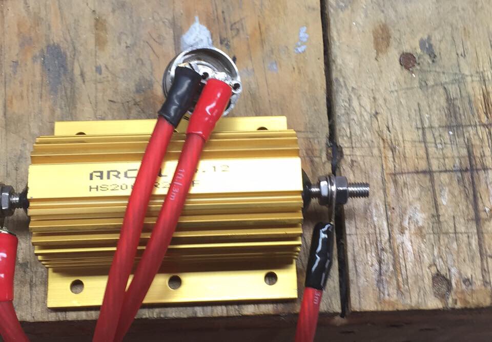

  7. I use a 200 watt .29 resistor

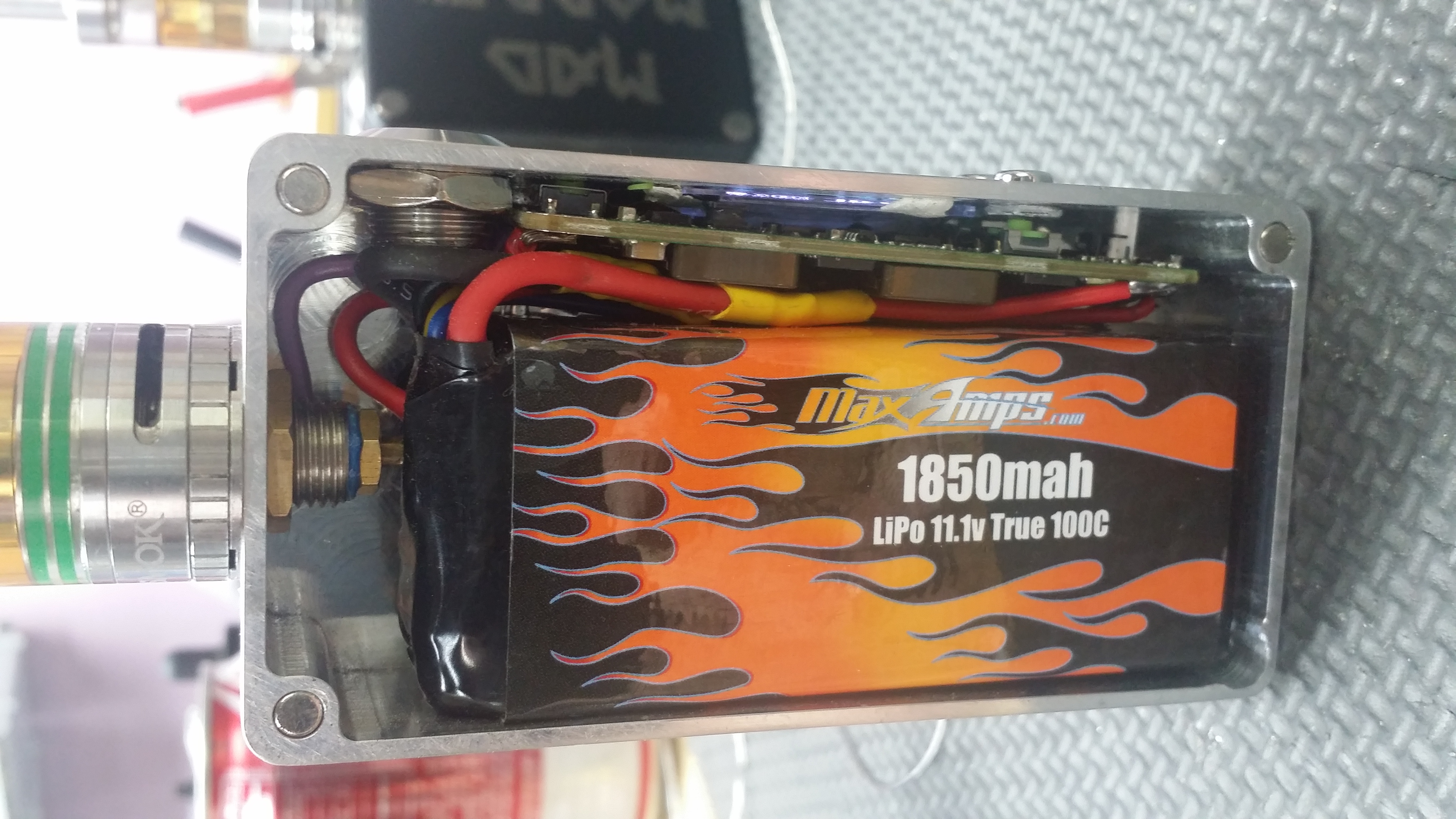

  16. Here is my prototype
