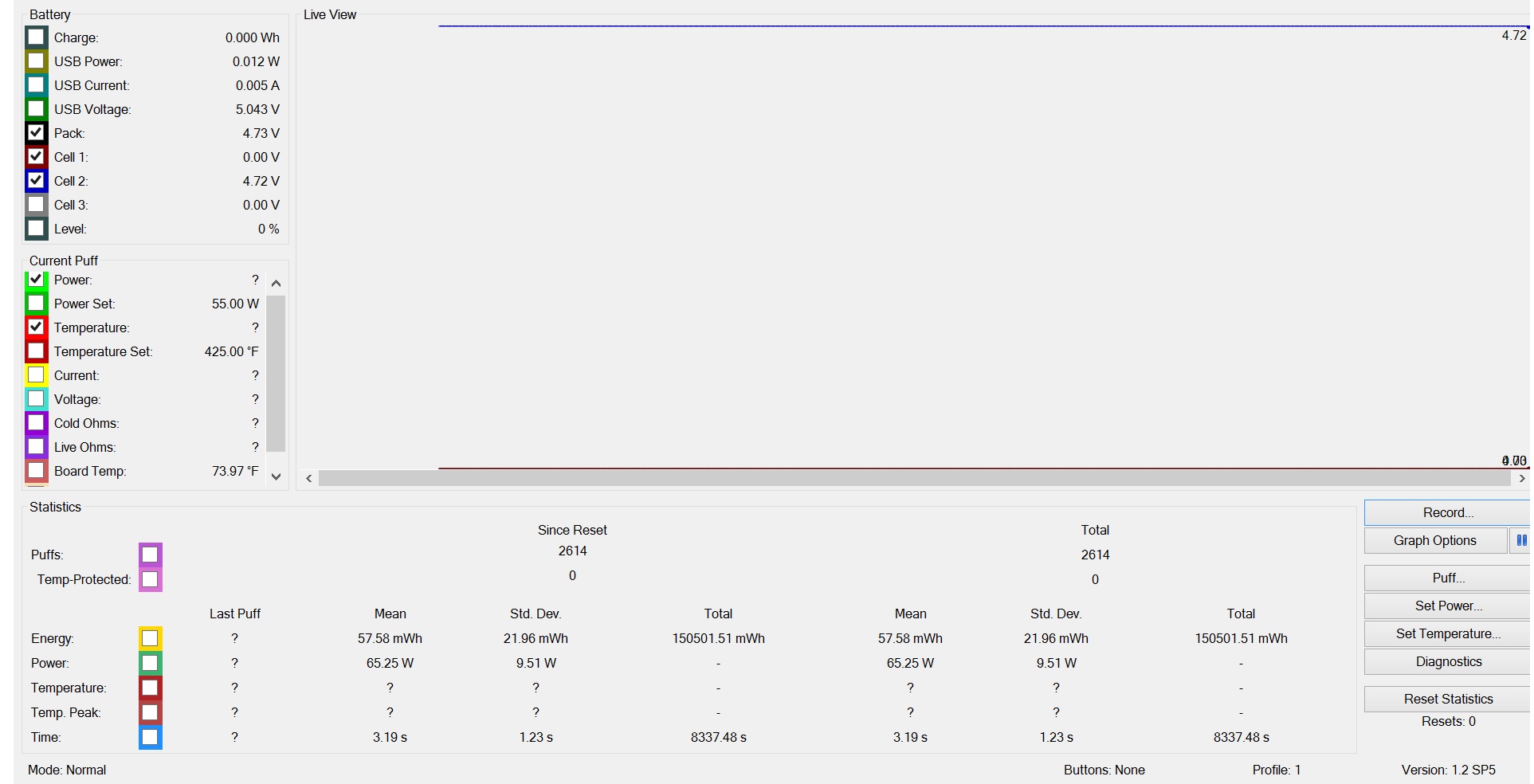

YES! with two Samsung pink 30Q 3000mAh 3.7Vs, it boucnes around a bit but stays at: Pack: 7.56, cell1: 2.34V Cell2: 5.22 Dual 18650 mode: I press fire get CHECK BATTERY and battery bar is empty but %100 charged on an external, barely used these cells, I press fire it says CHECK BATTERY if connected to escribe, but if i disconnect from escribe and press fire it say EVOLV DNA250 for as long as I press fire. 3 cell mode = pack = 11.78V , cell 1 = 2.34, Cell2 = 5.22, Cell3 = 4.22V I got these cells right here: https://www.ebay.com/itm/SAMSUNG-30Q-Rechargeable-Battery-High-Drain-Flat-Top-3-7V-18650-VAPE-LOT-MENU/172954891880?ssPageName=STRK%3AMEBIDX%3AIT&_trksid=p2057872.m2749.l2649 evolv DID grant me a rewarranty for this but maybe it's the cells? The other two batteries I was trying were 2 sony greens that when I put them on an external Xtar charger one says NULL and won't charge. The other seems fine. I think I tested with these Sonys before but I did also just test with the sansung 30Q pinks and got CHECK BATTERY. BTW, the Sonys have some strange markings/burnings or something shown here but people are saying there that it shouldn't be a problem but I won't be using these cells again and will recycle them now that I see it saying NULL on the Xtar: https://www.e-cigarette-forum.com/threads/what-happened-to-these-batteries.911913/ -

Had a problem with a new Hcigar Vt250s DNA250 described here: Basically, it was saying CHECK BATTERY and could not be used. It was not possible to change escribe MOD Tab 2-cell to 3-cell (VT250s is dual or triple cell). Changing that was the usual fix I read others used but it was not possible to change (dropdown menu wouldn't respond to mouse click). Someone said in the thread linked above that it was probably the charging chip on the board and to warranty it. I sent it to evolve for warranty and got it back today. I put 3-cells in but it was doing some weird stuff like I would vape at 25W and put it down for a minute or so and it would be back at 55W. I did an escribe factory reset and everything was fixed in 3-cell. But I STILL can't change it back to 2-cell in MOD tab. I even linked my thread above when describing my RMA issue.. The drop down menu just doesn't respond to a mouse click. If I put 2 cells in it, it just flashes DNA 250 and can't do anything with it. If I connect escribe with 2-cells, it says CHECK BATTERY and all 0s for screen parameters. Device Monitor says 4.14V for each cell. I was hoping they just changed out my board with a new one but it seems they just had a software developer attempt to fix this but maybe didn't? I already paid shipping to them once for warranty. Do I have to send it back again or what? Many thanks.

thanks for the suggestion on my thread. It seems a lot of 250 boards have this problem but most I read were solved by simply changing escribe's Mod Tab to 2-cell or 3-cell depending on how the MOD is configured. But I can not click the drop down to change that. It just won't let me change it. I Restored all setting etc and tried it in 3-cell etc but nothing. I started a RMA like you suggested. Anyway, can we even buy those charging IC chips separately? And if so, do all those "spider leg" wires need to be individually soldered (in such a small space while avoiding bridging solder from one spot to another), or do they sort of fold in on the other side of the chip and need less solder points? I never soldered such a small thing but I have a micro solder gun and not much to loose if it goes wrong, the MOD I'm considering this for won't USB charge anymore (not the one in my thread I just got 2 weeks ago, a different DNA200 from 17 months ago, past warranty). It suddenly won't charge via USB. It may be due to extremely leaky non authentic TFV8 premade coils leaked like 10ml in a week on the mod I had to keep wiping it, then it stopped charging. I had plenty of leaks before this and it always charged but it was exceptionally leaky before it stopped charging. Having said all that, I'm still sticking with DNA boards only. I like to charge USB and they're safe for that, and they have good warranty anyway.
