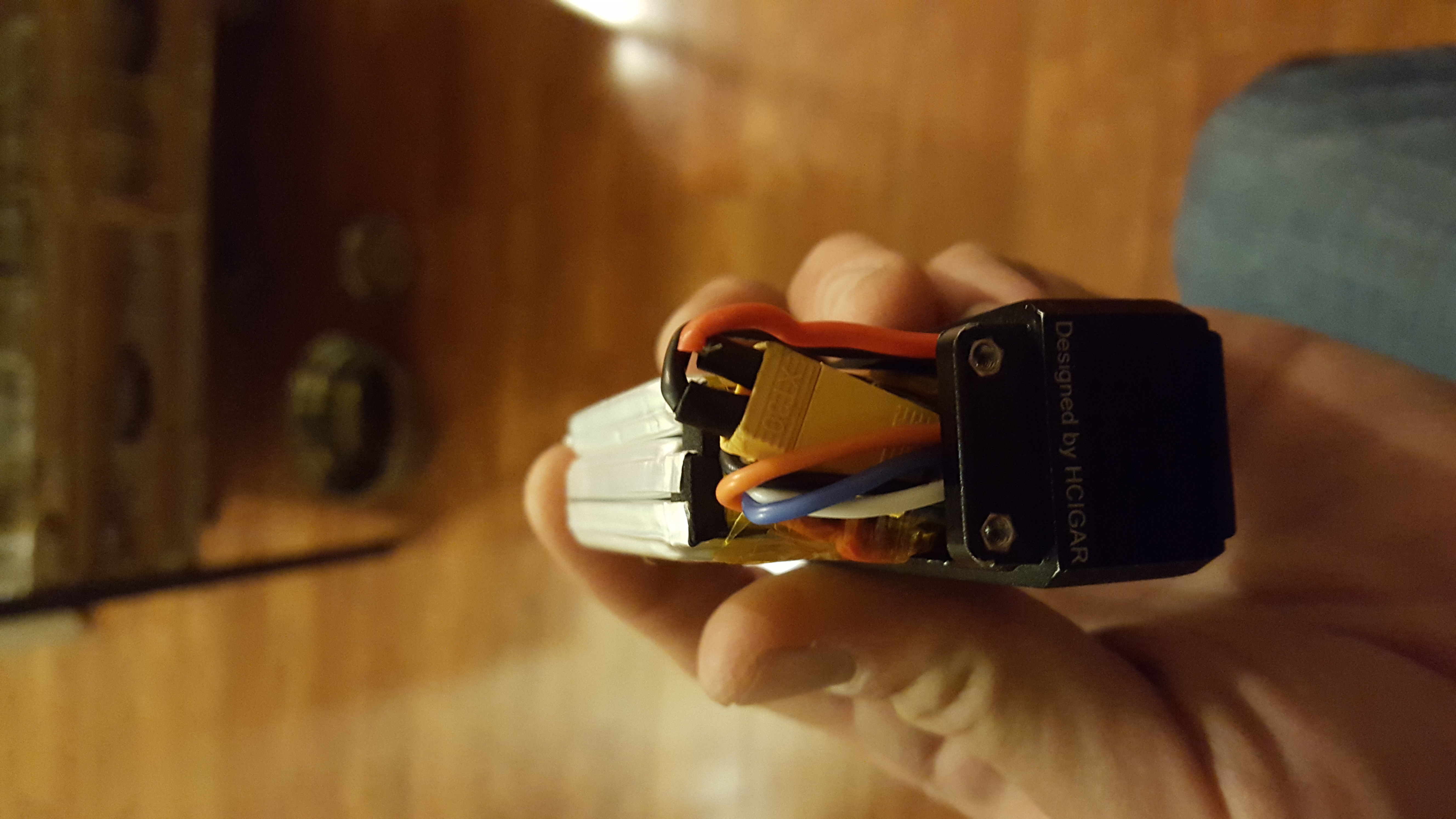

i just installed the thunder power 1350 in my vt200. had to remove the plate separating the chip and battery compartment . had to shorten the leads from the chip and change the plug on the battery. i removed the tabs on the battery side of the case also. i removed the lipo wrapper and rewrapped it with electrical tape. fits good and i got 14.23 for the first analyser test
