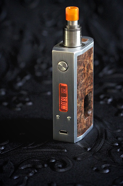

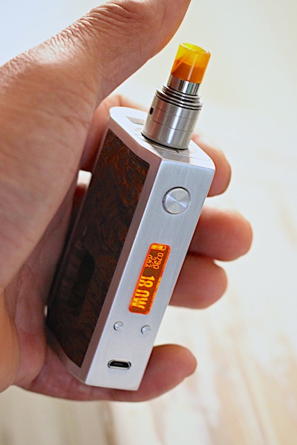

I built my 2s dna200 with the main reason being making a small device. I managed to cram everything into a 83 x 38.3 x 25.5 DIY enclosure. I don't go above 20 watts.

Now that is machinist porn lol. What tools/machines did you use? Looks like every little detail finished to nth degree. Beautiful.[/QUOTE] Thanks Mad Scientist. My missus bought me a Proxxon micro mill last year for my birthday last year and it stopped working just after this birthday. I used this years birthday funds to buy a swig 1XL mill/drill and it's been great. I also use a dremel and needle files to finish off.[/QUOTE] Nice. I have to see if Santa might be willing to spring for something that expensive lol. Your experience shines through though. I am no expert machinist but I know enough to know that ain't easy.[/QUOTE] It seems as though it's expensive but I haven't bought a mod in over 2 years lol

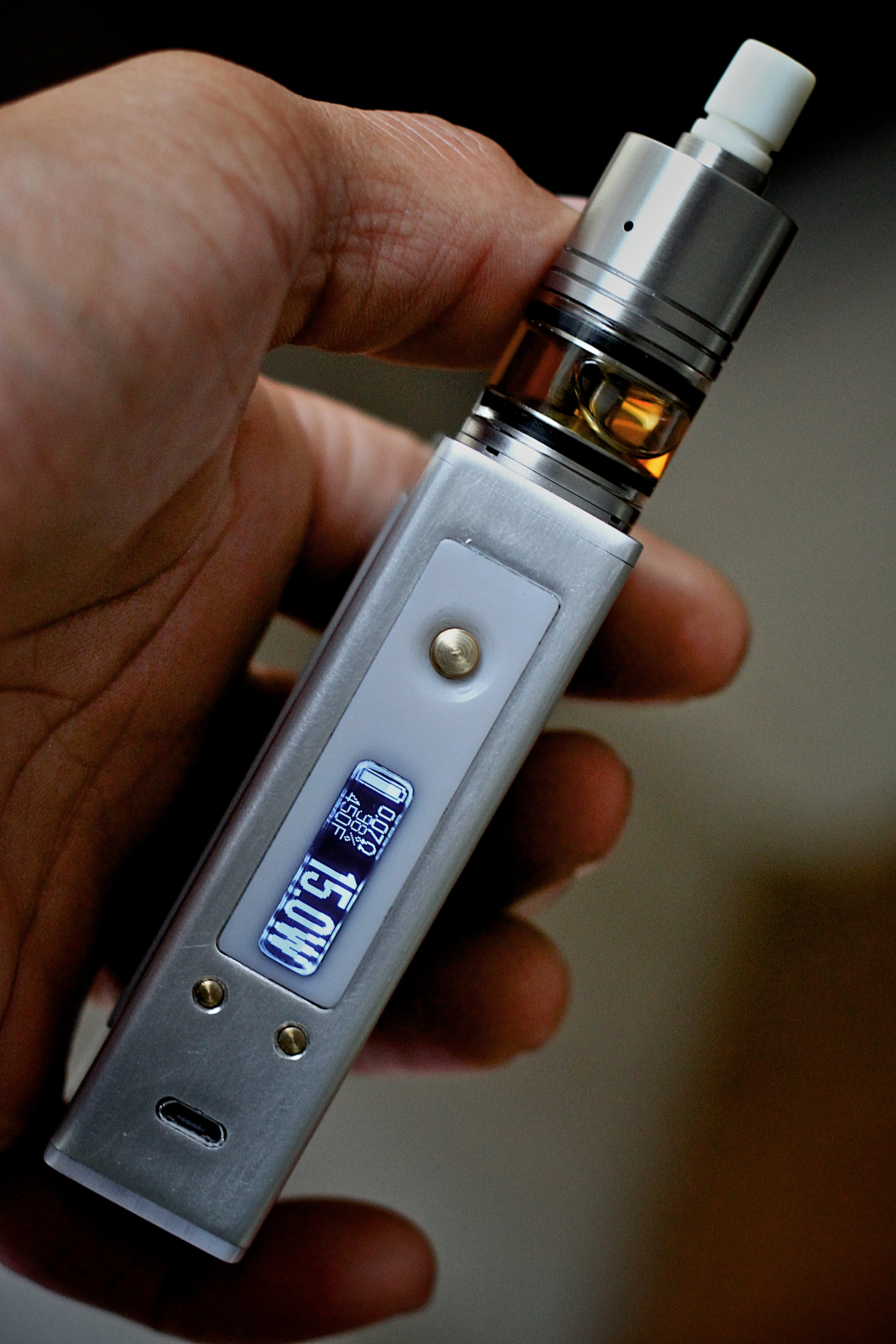

Hi Podunk Steam. My one is the aluminium one (I wish the wooden one was mine too lol). It's got a 3s 1000 mah nano tech battery. I haven't run it down completely but it should take 3 hrs to fully charge it from empty, charging at 1amp.

Thank you. I made all the parts myself using a micro mill.
This is my second DNA200 build. It uses a 3s 1000mah nano tech battery. I had to remove the tap connector and wire it directly to the board because it wouldn't quite fit in.
I've always cover the screen in my DNA builds. I started with Hammond boxes and used pieces cut from a CD case. These days I use 3mm aluminium enclosures so I cut a piece of 3 mm Perspex. Like blueridgedog, it's mainly for aesthetics, but it does keep the dust out.
