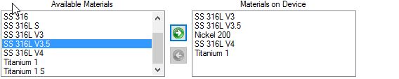

  1. Hi guys, have updated the firmware on three of my devices for awhile. Found that material tab on one of my device (a diy box) would not arrange materials on device alphabetically (not even in order of adding, rather a fixed specific order with v3 and v3.5 ss on top) as compared to my other 2 VT200. Anyone experienced the same? edit: fixed by swapping mod parameters with working saved files. (sorry that I saved over the faulty file but its all fixed now )
  2. I have tried troubleshooting, on my own. This issue was fixed on the newer boards I received from Evolv dated November previous boards are made in august. It's a board issue as my own DIY got the same problem, after RMA every thing works fine.
  3. I have the exact same issue, tried your troubleshooting methods. After which gave up and created a ticket and RMA'd the chip, from what Nick had told me its an "interesting" issue hence prompting me to send the chip instead of going back to vendor. On the other hand it seems to drain and heats up on idle, not entirely sure if the batteries are killed as I've tested the battery on other mod which worked fine. Higher chance the chip's capacitors are doing something funky within which we'll not know unless full component and layout is given. (Something not advisable to do for a company)
