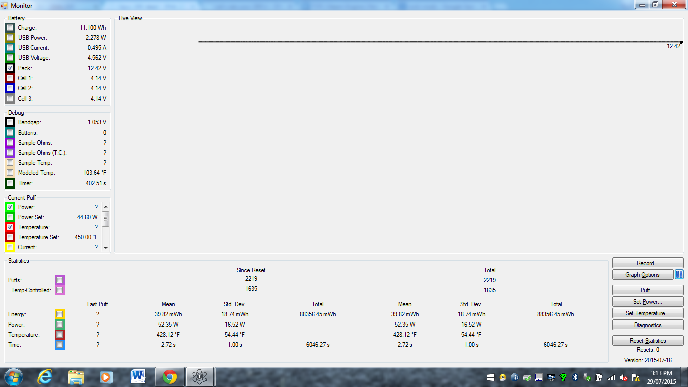

Hey there Did my first dna200 build today all was good connected to escribe fine. Started changing some settings like battery WH etc and was about to do a case analyser. Screen went dead and i lost connection to escribe. Message came up on my pc, usb device exceeded power limit, power surge on usb hub. Fuse looks intact but i can see where something has shorted on the board

i just unplugged from usb as the mod does feel warm just from doing the above in escribe
i charged it up last night and sat it down ready for the next day. Grabbed it this morning had a puff and it seem lacking in taste. I dripped and fired and thats when i heard the pop, so mid puff. The mod hasn't left my house and has never been dropped. The usb socket is a little wobbly like on my vapor flask, so not sure if thats normal because this is my only dna200 device, but its like my flask Thanks for your help so far John I appreciate it!!
its completely dead without usb connected, powers straight up when it is connected. but only fires for a second to about 2W then error comes up
No idea I just plugged it in and took the screen shot All I know is it went pop and screen blanked out, powers up and charges when plugged in to a charger or computer. It is chucking ohms too high, check battery, check atomizer, it fires sometimes but only low watts then warning messages appear.
