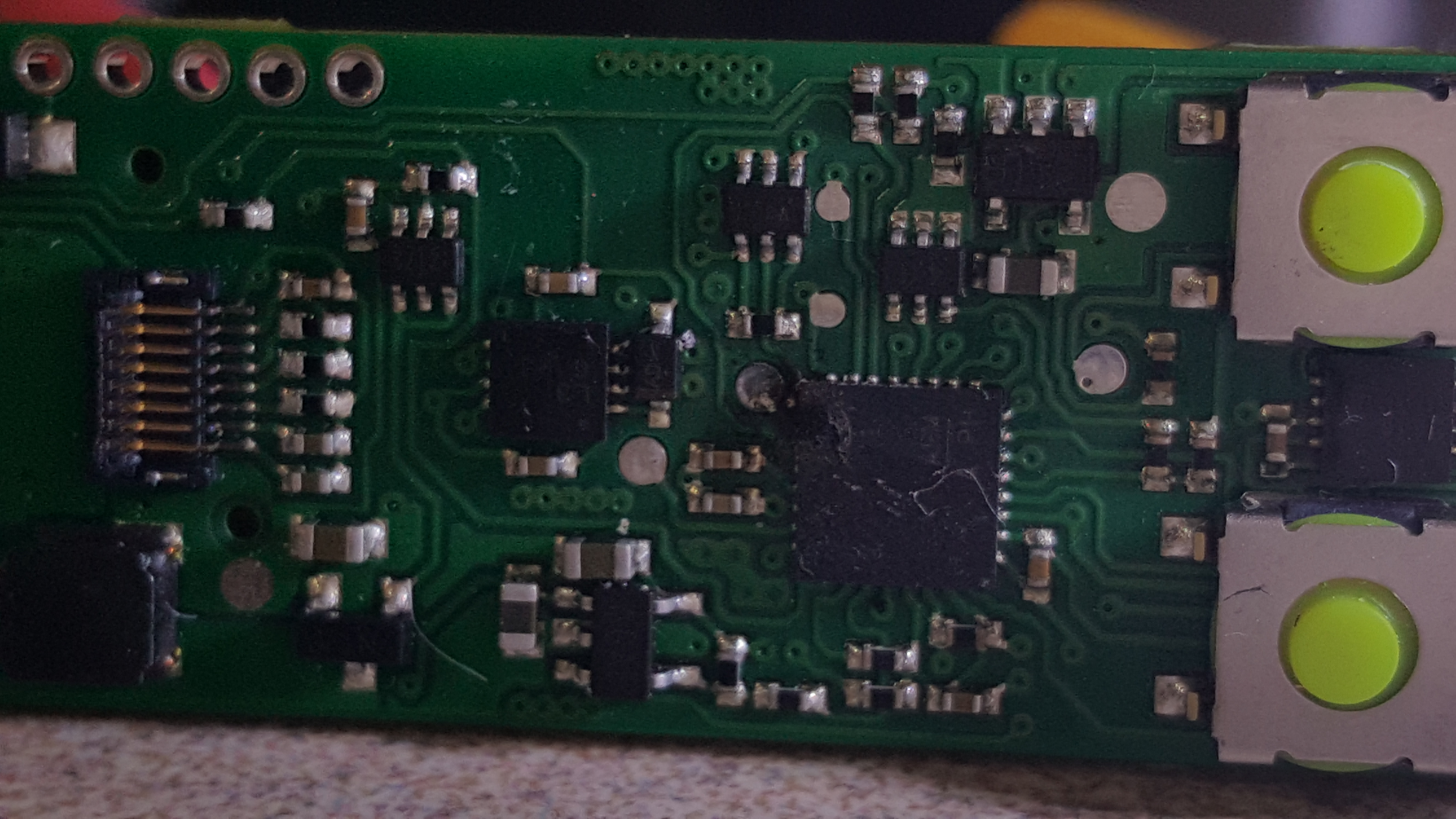

  8. Hey there Did my first dna200 build today all was good connected to escribe fine. Started changing some settings like battery WH etc and was about to do a case analyser. Screen went dead and i lost connection to escribe. Message came up on my pc, usb device exceeded power limit, power surge on usb hub. Fuse looks intact but i can see where something has shorted on the board
  9. Roger's email to me said he needs the unit for a couple of weeks because he's waiting on evolv to get back to him with a reason and solution. He didn't want to just replace the chip and send it back without knowing why it's happening. I'm just glad it's getting fixed in the long run.

  12. I will purchase a beta unit John =)
