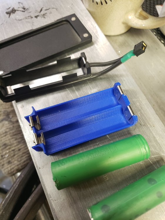

Who's got the best sleds? I'm really tired of the sled or the contacts in the sled being the weak point of my mods. I've been using a couple different sleds but none last long. The best I've found are the Brimstone's with bigger contacts in them than they call for but I would love to find a better sled. I'm considering going away from a sled to dual \ triple 18650 shrink wrapped with leads that have mini deans connectors, like a RC battery pack. That's the best setup I've figured out but I would love to not have to do that.
