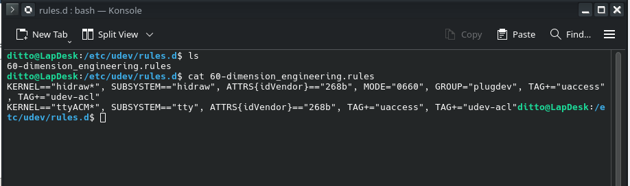

  2. Hi James I run this to get pkexec But where can i find the 60-dimension_engineering.rules
  3. Hi James, Thanks form you fast response user is part of group but there is no files in /etc/udev/rules.d and also there is no /usr/bin/pkexec How can i fix this issue?
  4. Hi I am getting this message.... Any idea of how to workarround this message Debian 13

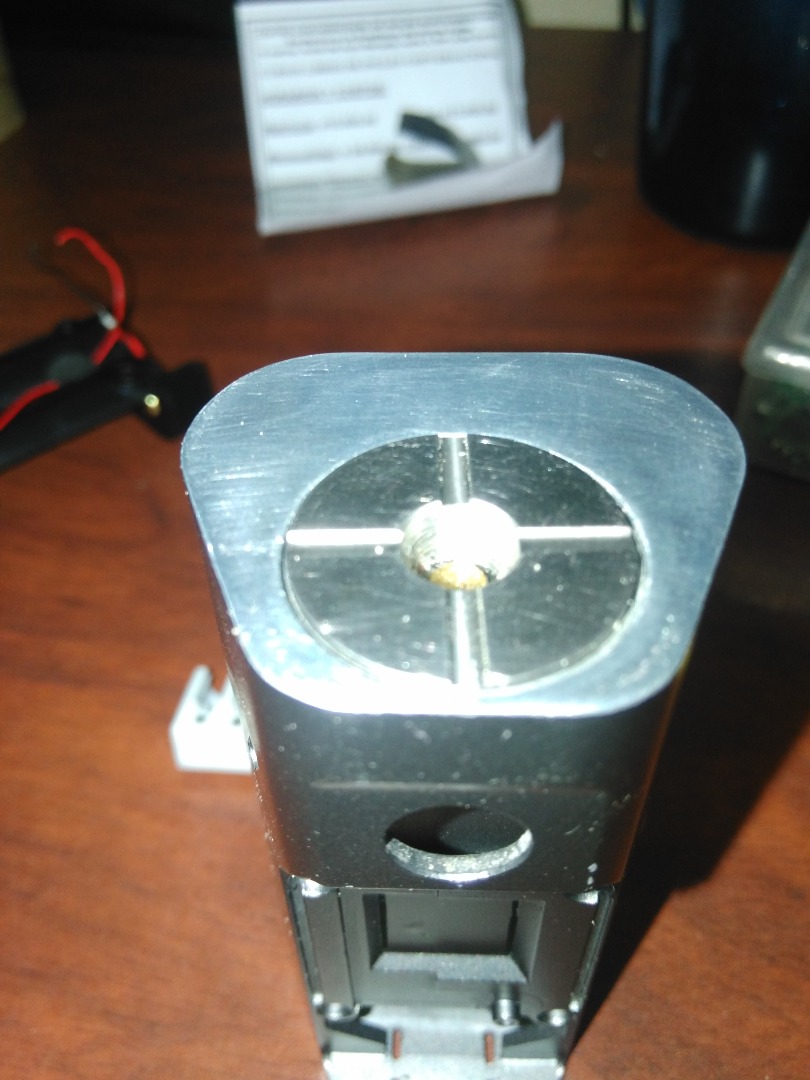

  10. I order a dna250 board from protovapor last thuesday, I live at Costa Rica. As soon as I get it, I wiil document the complete process: Disassembly510 changebattery tray wire changebalance tab wiringRe assembly
  11. Board Incomming!! As soon as I get I will take the pictures of all process. Step by step

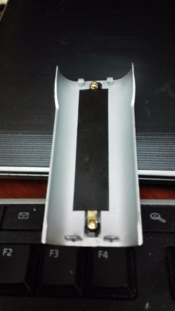

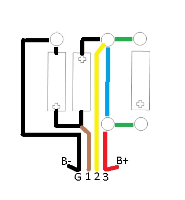

  15. Whe user (me) jajajaj switch from the 2 battery backcover to the three ones, the blue line dissapper and the batery located at the otger cover, represented by the green lines takes part into the circuit and rise the voltage to 11.1v tara!!!! full 200/250w after changes the battery at escribe

  17. the Other change than must be applied is to use proper gauge cables in order to avoid the loose of voltage/current that the actual ones induce in the circuit. This is the main reason why rx/3 has this poorly batery life.

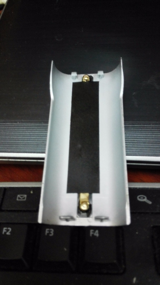

  18. Ok I figure out the connection using both configurations When the two battery cover is installed the cover represented blue the blue line acts as a jumper between tap 3-2 at the balancer connector when the tripple 18650 cover is installed it will use the releaux config. there is no blue jumper. Can anynbody please check this connections? The gnd is jumped to b- and the tap 3 jumped to b+
  19. Ok at the moment I am makinfg the plans to swap the board. I will make a screen suppor in order to center the dna200 screen over the rx2/3 front panel
  20. The initial question is related with this fact: How to wire the balance charger tabs as a normal way in 3 18650 since the conver acts like the la 1860? and setup the dna200 as 2s or 3s in escribe dependending on the cover I will use?
