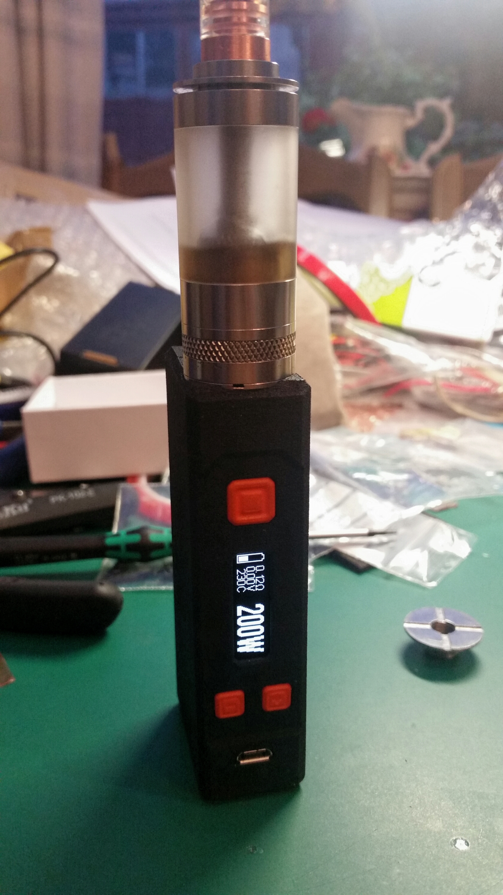

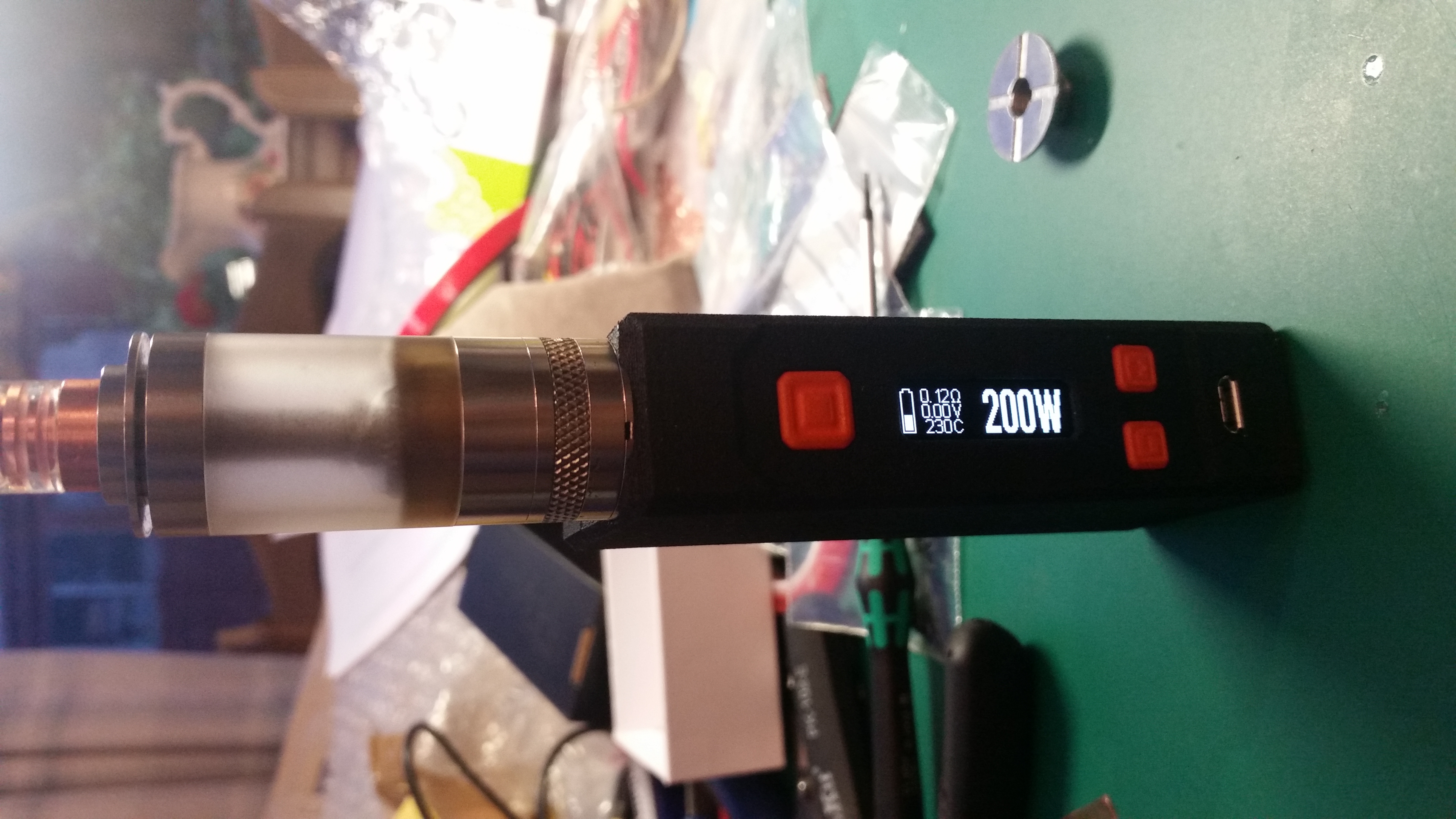

  10. Looking for help I ordered a 200 a couple of weeks ago here in the UK. Mod built yesterday after waiting for the 3D case to be printed. Screen blanks on firing randomly, sometimes it's blank on firing 5 times in a row then it stays on for 1 or 2 fires then blank then on. The frequency is random. The problem is the same with no Atty or Atty attached, reflashed to latest firmware, reset the board, hard reboot its always the same. The board always fires even when blank, there is no screen glitching. The only issue is on firing. Anyone have any ideas?

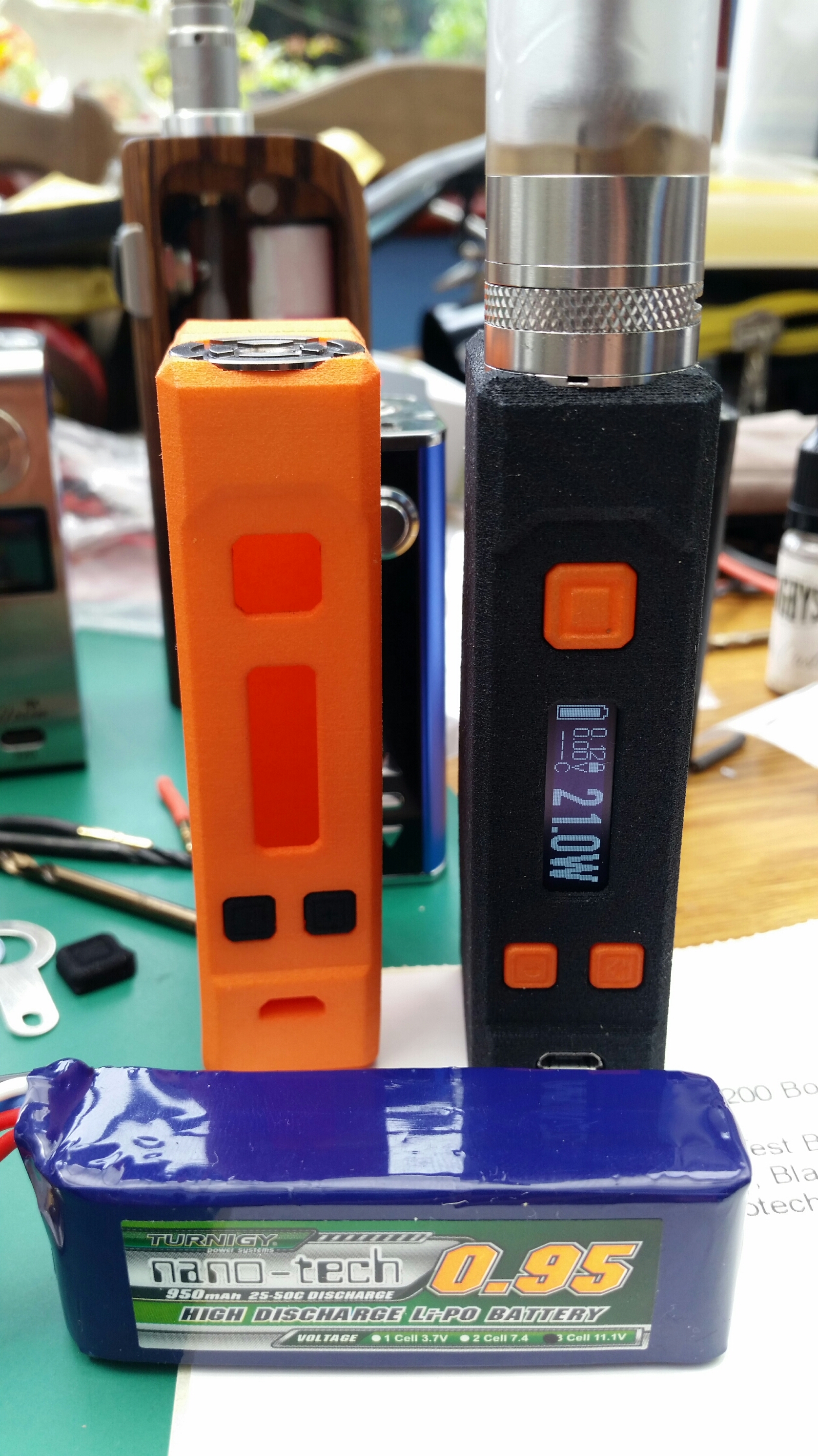

  11. Does anyone in Europe have any idea what equlivalent screw sizes will work in a 3d printed reference case? The 0-80s board mounts seem to be m1.6 ? 5 and the 2-56 case screws m2.2 ? 20 we have m2 and m2.5 here will m2 be too small for the case screws?
  12. Thanks for the post mamu, what size of wrap do you use for the Turnigy 950mAh pack?
