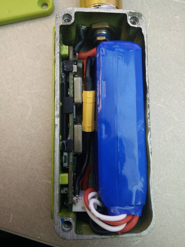

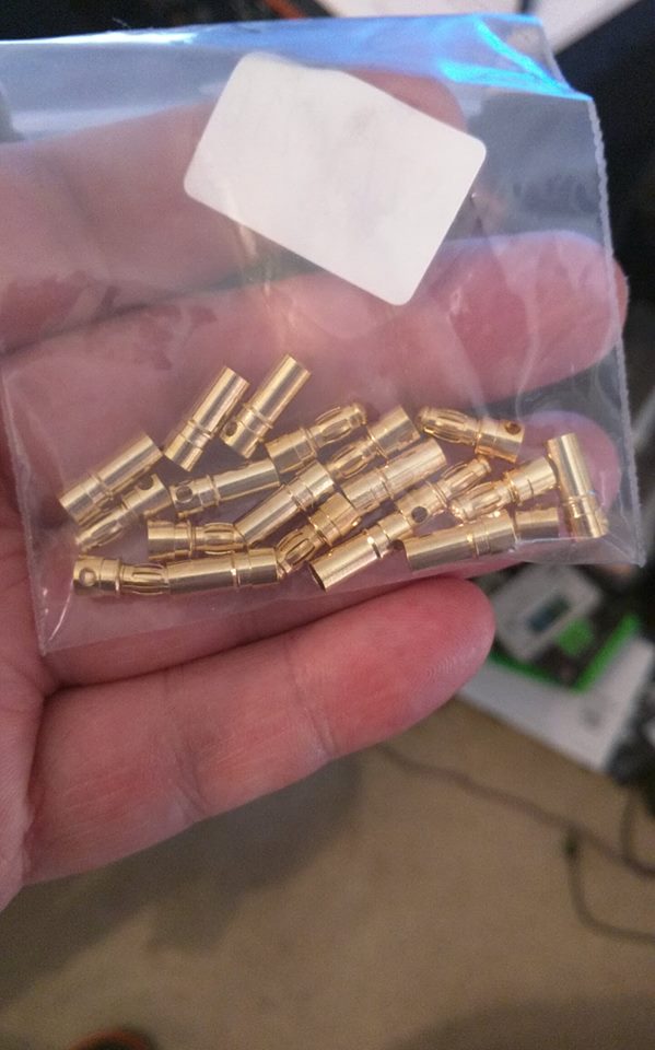

Unfortunately, you predicted the future here... blew the fuse on the chip and the battery has light scorch damage on the wires. I tried to remove the components from the box to do some cosmetic work (bigger buttons carbon fiber wrap) and since i had to hard-wire the battery it was left prone to mishaps made worse by a stripped screw. So the box, battery and chip are beched. The FDV box was cool and I like design, I wish it had more rounded corners and edges though and the finish sucked, you need to do more to it. I do not recommend hard-wiring batteries, I am rebuilding James with a venom 1300 35c (85*30*19.5mm) this leaves room for plugs. Maxamps is a great battery, but two of these venoms would have been the same price for 2600mah with plugs. I am going to see if I can get maxamps to repair and test my battery, they seem to have excellent customer service, lets see how good. As far as my chip goes, I am not skilled enough to remove and replace the fuse. What should I do here? It's an 80 cent fuse. I would like to save my $80 chip.[/QUOTE] yu could always used bullet connectors to save space. They would have fit with that maxamps 1850, in the enclosure you had.

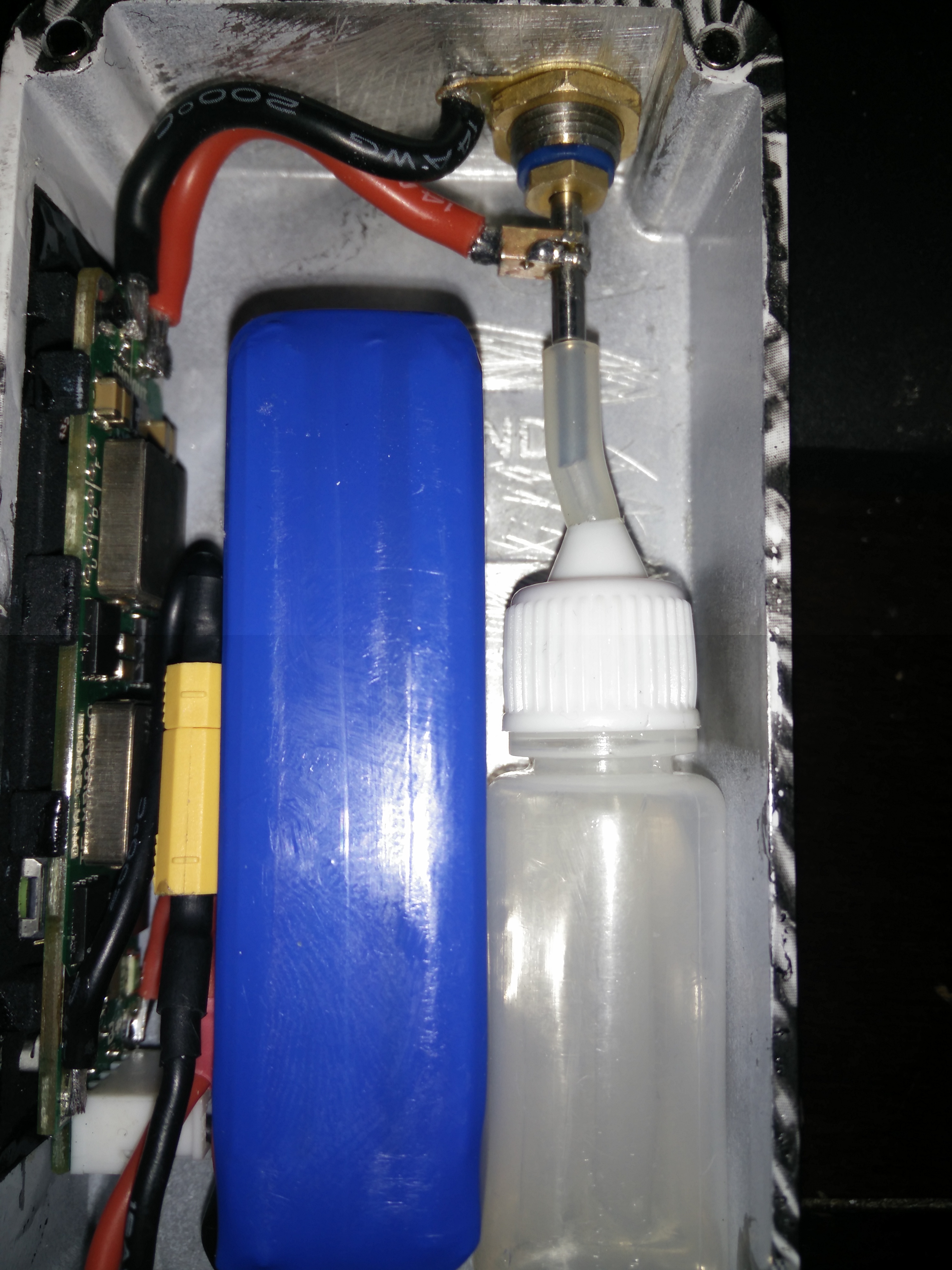

SQUONK-LYF. DNA200 Sqounk, FullyMax 900mah lipo, 10ml squonk bottle. I've got 2 doors for it, both are pictured. I haven't cut a squonk hole yet. not sure if i want one. The last picture is the squonk with it's little brother a dna40.

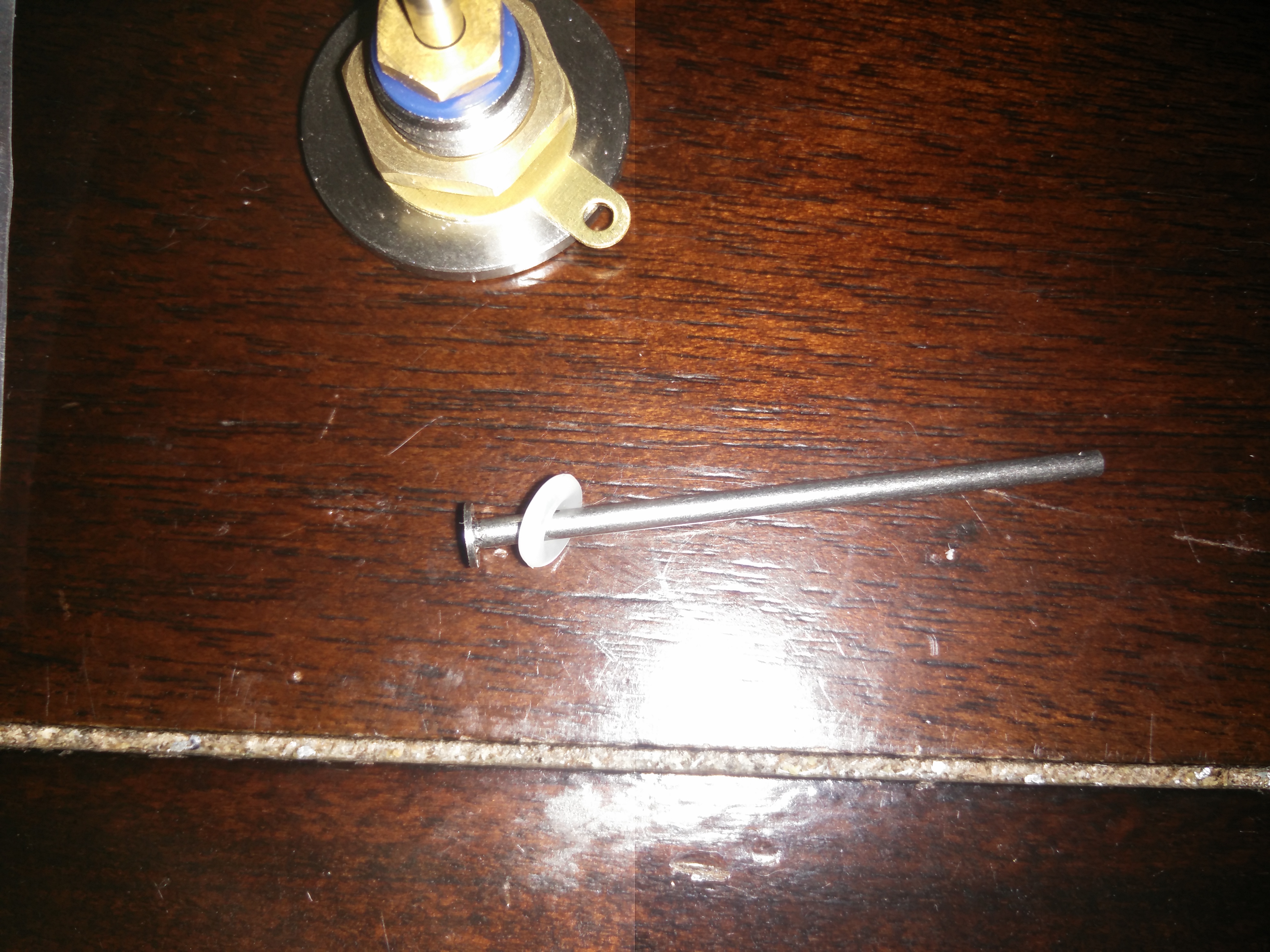

So i solved the issue, and it was defintely the squonker below. below and to the left is the newer fatdaddy vape squonk 510, it's a stainsteel shaft. the right is an older fatdaddyvapes squonk510 with a brass shaft. pictured below that is the metal tube that goes inside the shaft connecting it to your bottle. see that little oring, that's to help leaking. okay so initially i have the newer 510 installed, had teh tube, and oring installed. the 26ga nickel would fire in temp mode. so i took the oring out to help wit the connection. still the same issue persisted. so i dug in my parts box and found the old squonker 510s. installed it, with the tube and the oring. same issue. i took the orin out so the tube was directly connecting to the bras pin, and BAM!!! she fired right away. no issue at all. it's weird, but it's fixed. i see he has an even newer version of the squonk pin with japanese SS, it looks dull, so maybe that will help with the connectivity issue. Going to order one and find out.. -

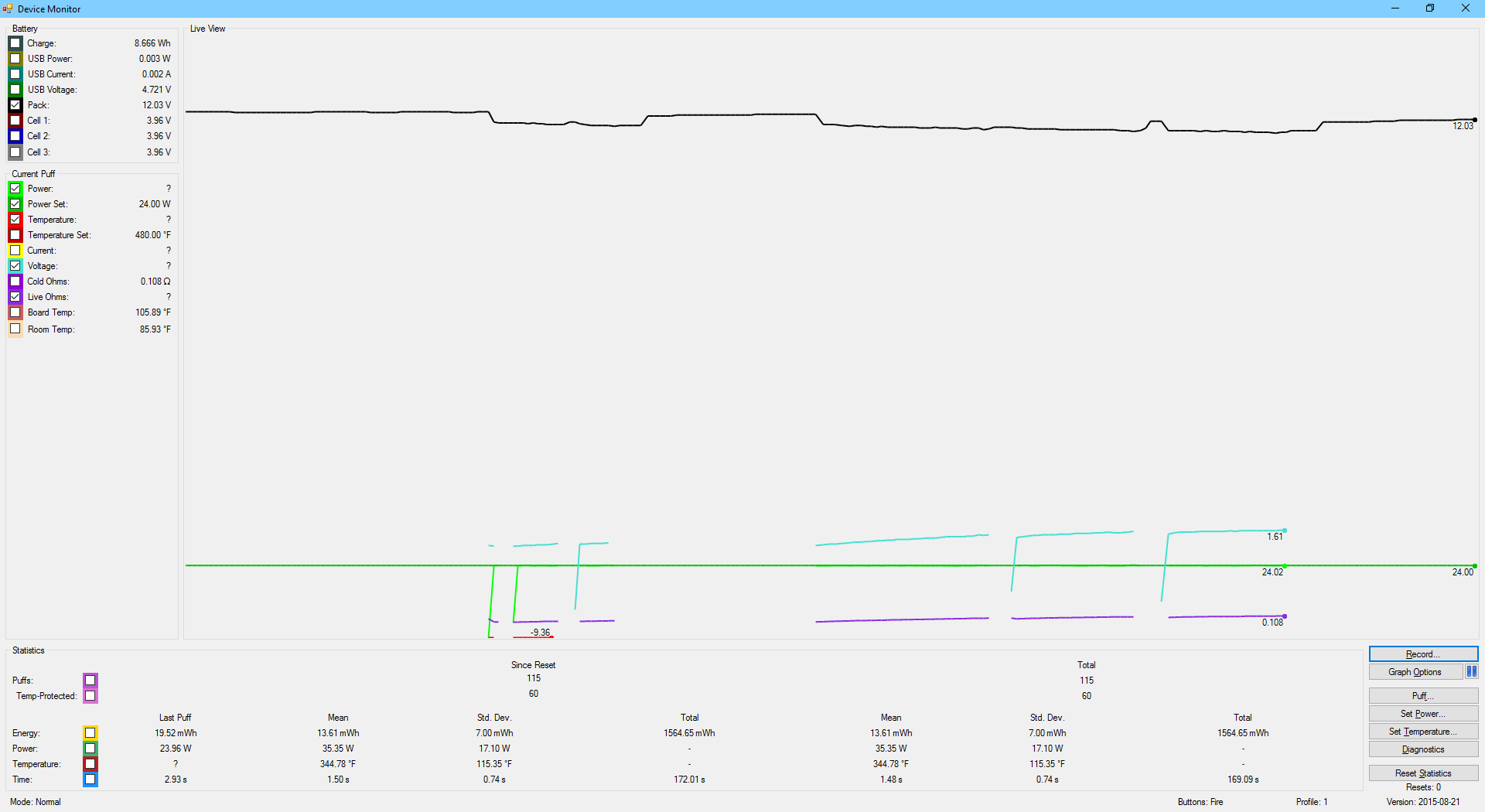

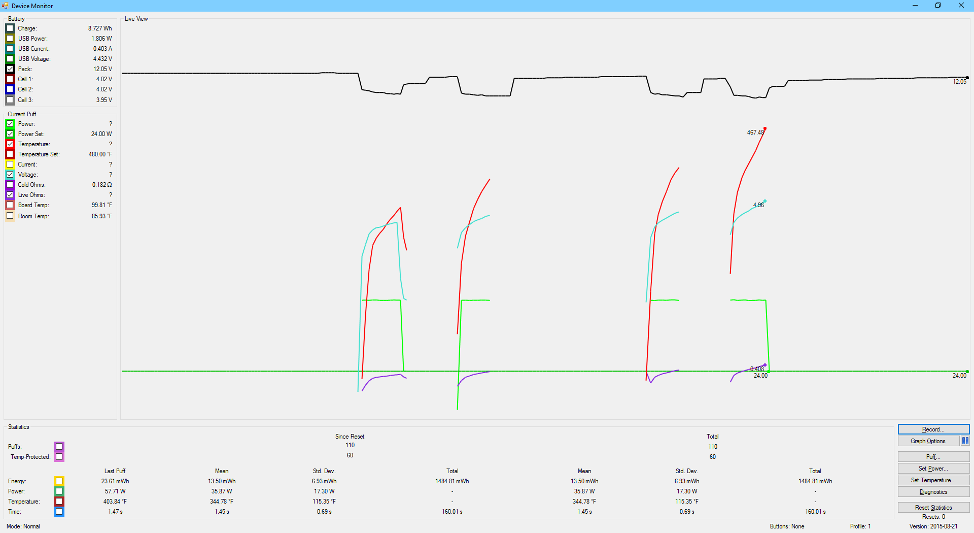

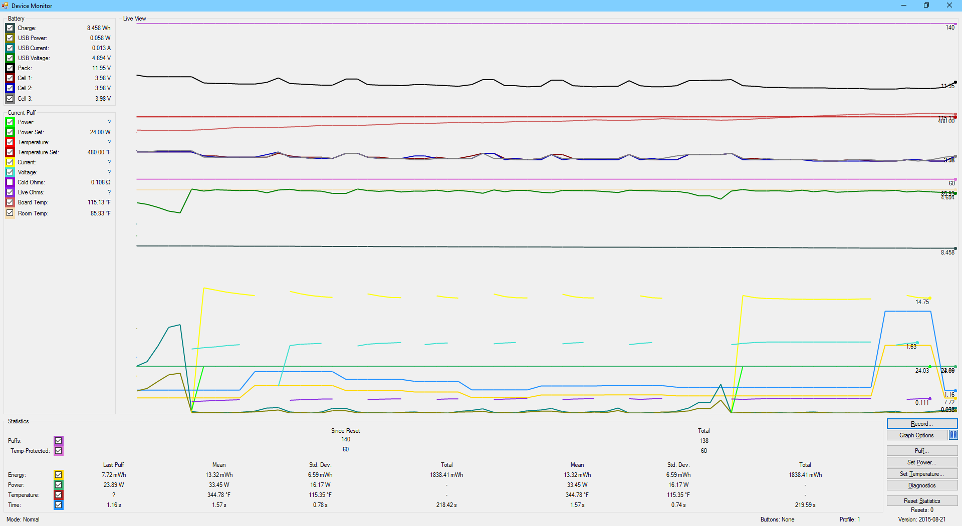

last night I finished building a squonk box, and noticing something weird with the temp control. with one atty i have a standard 28ga nickel single coil build sitting at .14 ohms rested. works just fine on the new squonker. I have another atty build with dual 26ga nickel coils sitting .08 ohms. the temp will flash at "3354F" them go straight to non-temp mode barely firing. I've taken this same atty and out it on 2 other devices i build and it works fine. I've also take several other attys with similar guage nickel setups and achieved the same results. I've taken the squonk apart, checked, and redid my solder connections just to make sure everything was fine. even filed the top of the box on the inside to make sure it was properly grounded. put everything back together and was able to get the same results. it seems like if i get below .10 ohms with nickel it acts wonky, above .10 it fires just fine. I'm going out on a limb and thinking it's something with the 510 squonk connection. anyone else built on the 510 squonk pin from fat daddy vapes and experience a similar issue? -

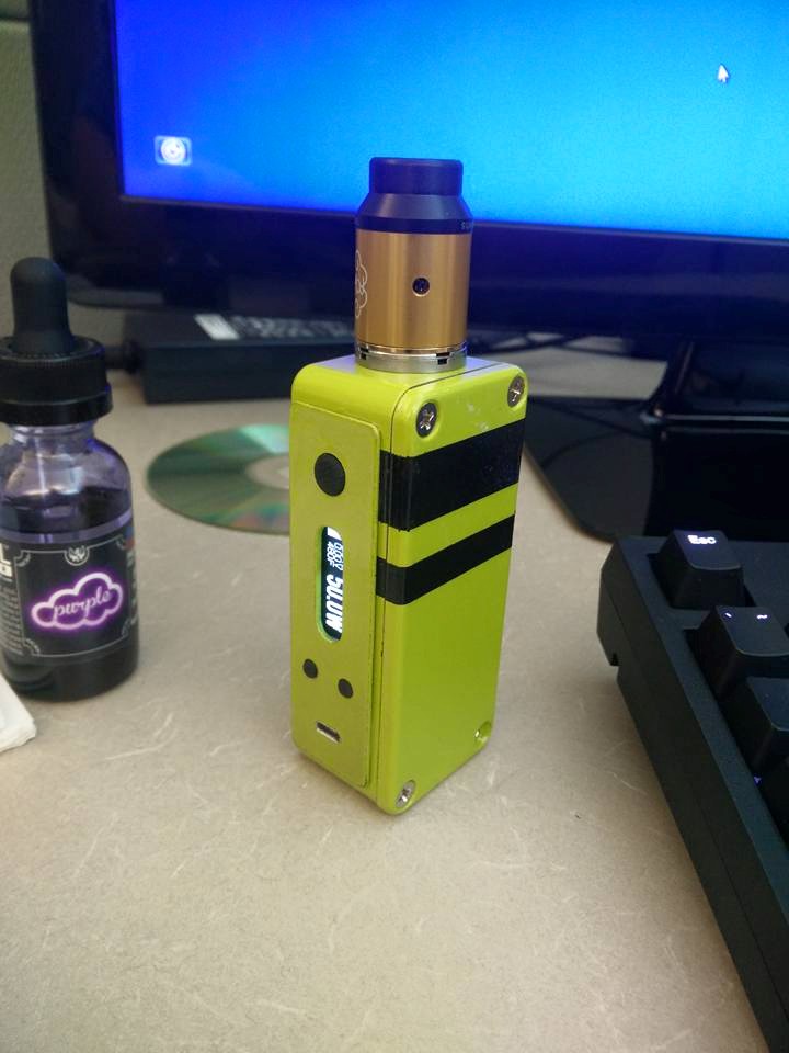

So the hydro drip on the case peeled off badly. you can see the in the screenshots above. So i went and peeled it all the way off, and painted it myself. I call it the Super Bee. Mopar inspired.
