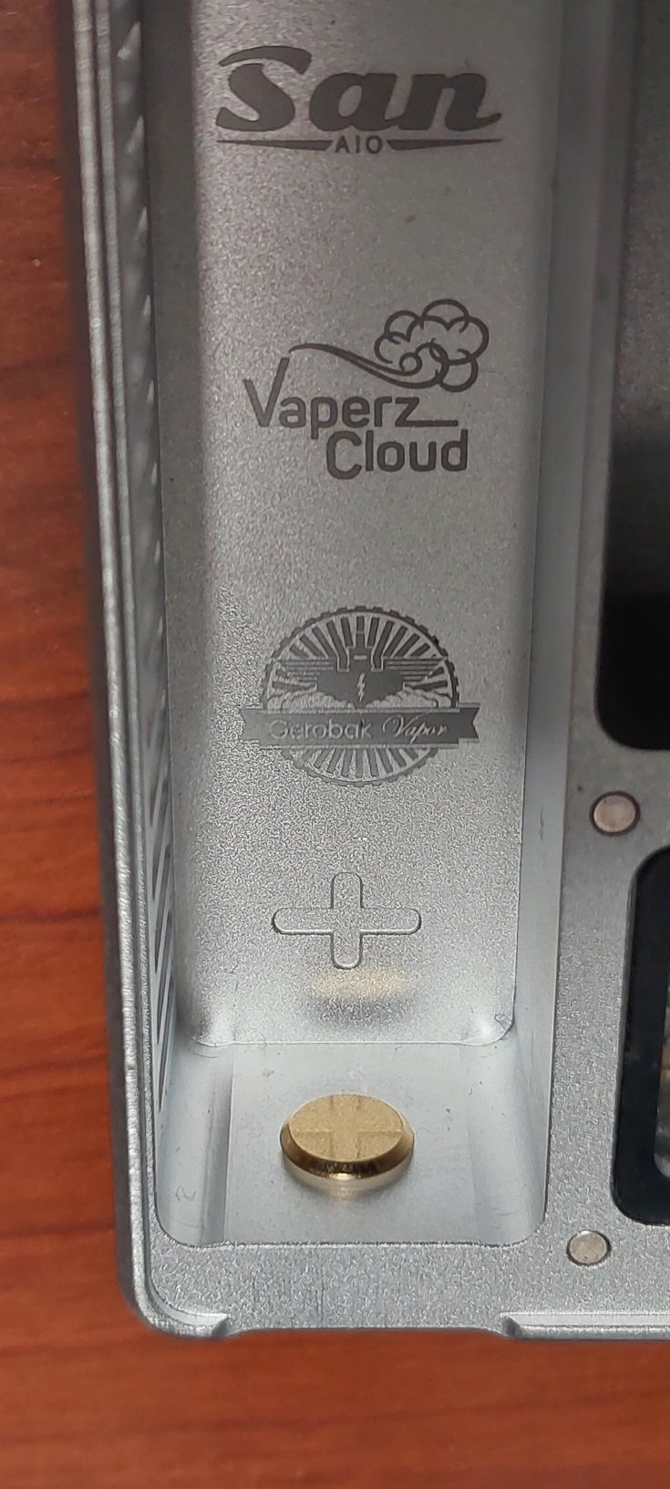

Does the battery drain without using the device? Because the San's positive battery post is really close to ground (see picture). They say e-liquid isn't conductive. But VG and PG absorbs moisture and then it becomes conductive. And if e-liquid was there, it would likely drain the battery.

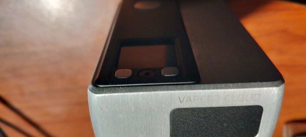

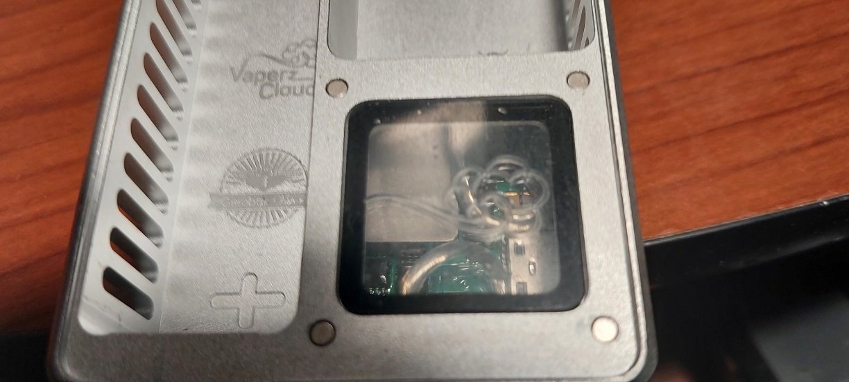

Careful! I wouldn't pop that window out on the Sans. I know what @dwcraig1 sees and Evolv's example probably the board does come out from the window side. But the San's window is smaller and is glued in (and juice proof) and it is framed unlike Evolv's. And there is no way the board can be removed through that opening even if the window was removed. I would not mess with that window on the San. It looks like everything comes out through the other side. On the bottom of the San, see that rectangle on the bottom (picture below)? It looks like there is a screw under it that connects the positive battery connection to the board through that lower wire (picture above). I would not mess with this and find out if you could exchange it at the place you got it. Telling them it has poor battery connections. If that fails, try Evolv by opening up a ticket. If you are stuck fixing it yourself. The ground screws looks like they are on the other side under the panel. If the ground screws doesn't solve it, then it is likely that positive battery connection under that rectangle on the bottom. I can't tell if it is a sticker or a plate. I think it is a plate and a hair dryer should soften the glue to lift it off (hopefully). EDIT: That is a Vaperz Cloud logo on the window.
