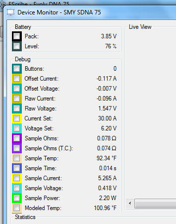

Until the experts reply, I don't believe you can reset from the mod. You may well already be aware of this, but you can reset by going into the Device Monitor and selecting "Reset Statistics", though. This resets all the fields, including the puff counter.

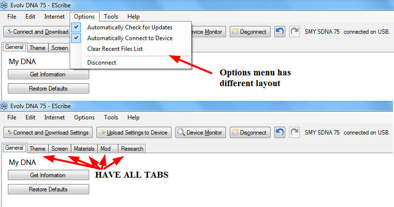

I'm not seeing a 'service menu' nor a 'screen disconnect' field anywhere- is this from an older version of escribe? I'm using escribe software version 1.2 SP3 w/the latest SNY SDNA mod firmware. Is there a screen disconnect field, and if so how to access it.

Okay, thanks. I just went into Device Monitor and have some different looking values on the left side- is this related to me trying to see what the "Screen Disconnect" value was? ETA Pls disregard- I closed/reopened escribe and all's well.

@Vaping Bad- Below is what I see regarding the 'Options" dropdown. This is version 1.0.56 / 2016-05-02. Again- everything appears to be working fine, just wondering if the difference is due to the "cleaning up" that was done to the app?
Okay, got that- thanks. But when I click on âGet Informationâ, the mod is still listed as a 200. No big deal, as long as it interfaces as it should w/escribe- which it seems to- it's just an oddity is all. And I appreciate the help.
@Vaping bad- Does that apply to the DNA75, because I'm not seeing that box...
