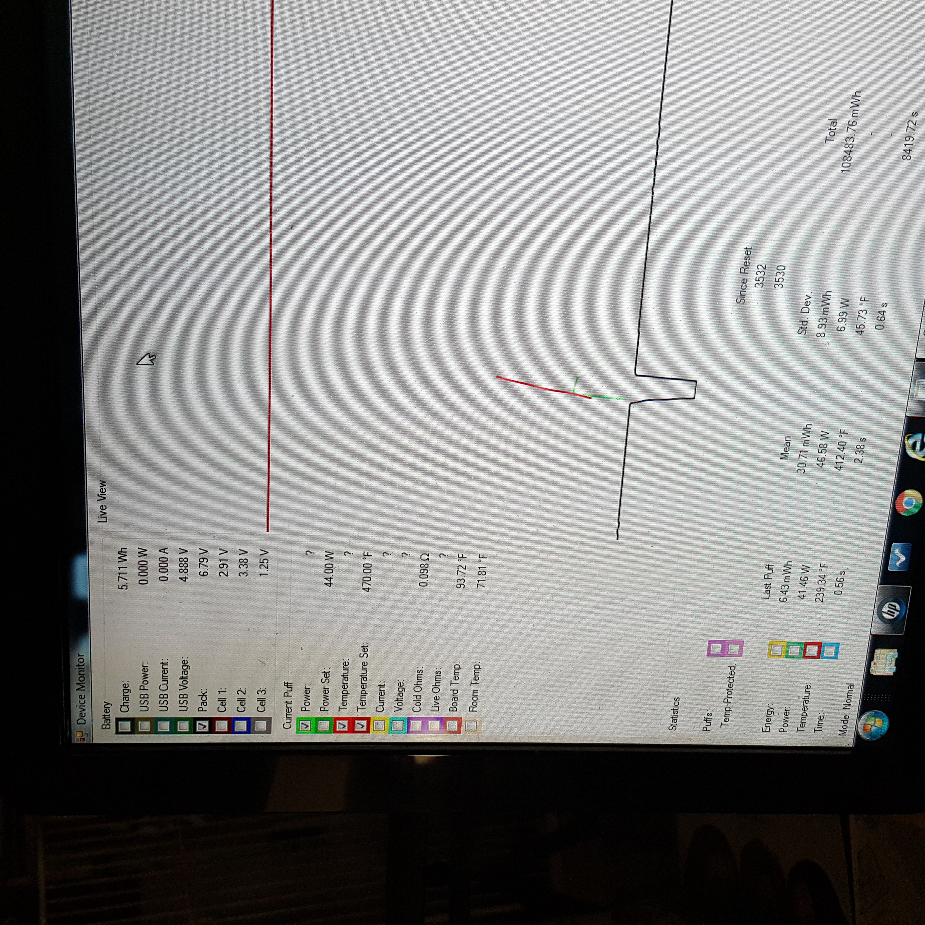

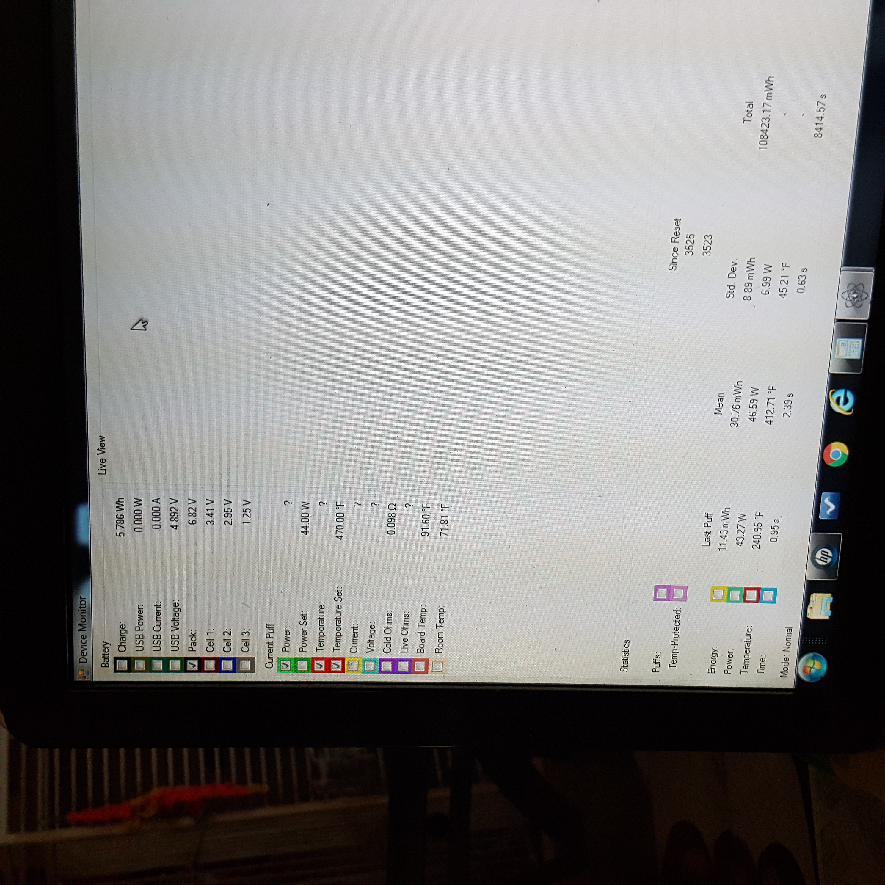

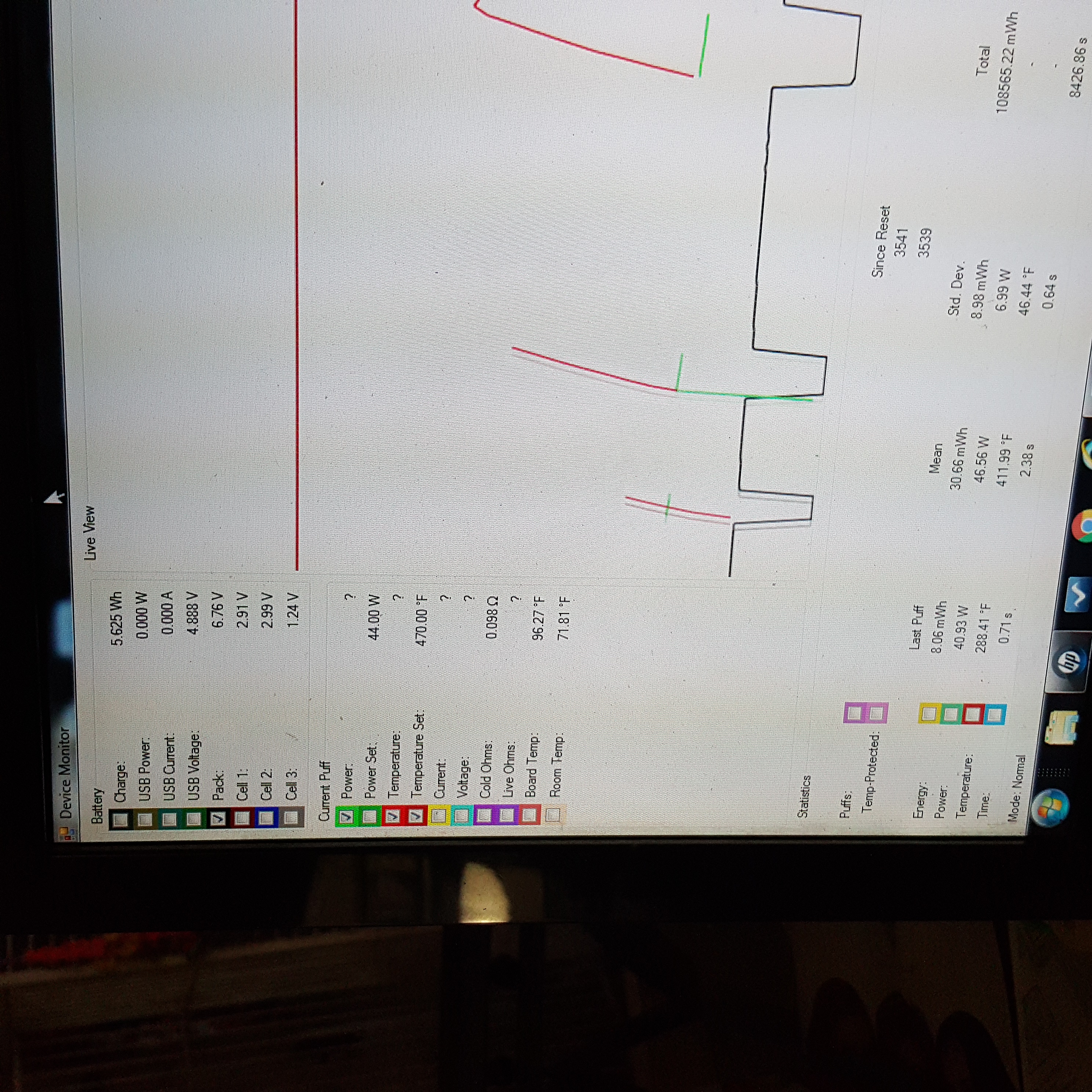

Not the batteries! Something bogus happening elsewhere but today I ran the brand new freshly charged pair of hg3000 mah down until I got weak battery note (set at 2.9v). Plugged into escribe at that point and this is what I got. . 3.4v batteries sagging down to 2.9 is not right. Not only that but I noticed that some times it doesn't register any sag,sometimes both sag, and sometimes only one or the other sags. .. I used 18ga wire and it's less than 2 inches long so I shouldn't think it's wire size. ..I am at the point now where it seems to be clearly not my batteries or my wiring. .kinda only leaves one culprit.
Mad scientist, where I'm at right now is I lowered the soft cell cutoff to 2.9 . I was out of town all weekend so I didn't bother trying to run down cells as I couldn't monitor them so I just swapped batteries at 50 percent and did not get any weak battery notifications like I normally would have when using my regular seasoned 25r batteries. So Monday (today)I put in the freshly charged seasoned set of 25r batteries and used it all day at 46 watts. I just now got the weak battery at about 90 percent drain on my meter. My meter is a hodge podge mix of the new hg3000mah watt hours with a discharge curve that of the lg he 2500's. So I have been more interested in hitting the soft cell cut off 2.9 and then measuring my cells regardless of the meter anyway. .when I pulled the set today after getting the weak battery they measured at about 3.5v so the sag is still very evident with those particular batteries. I'm putting in the fresh hg3000mah set right now so tomorrow evening I will have them run down and will be able to check them and I'll have the definitive answer as to the cause of the massive sag either being battery related or not. This has made notice the battery life in my other mods using these same batteries and I feel that in the end the batteries will end up being mostly to blame but we'll find out for sure tomorrow. ..

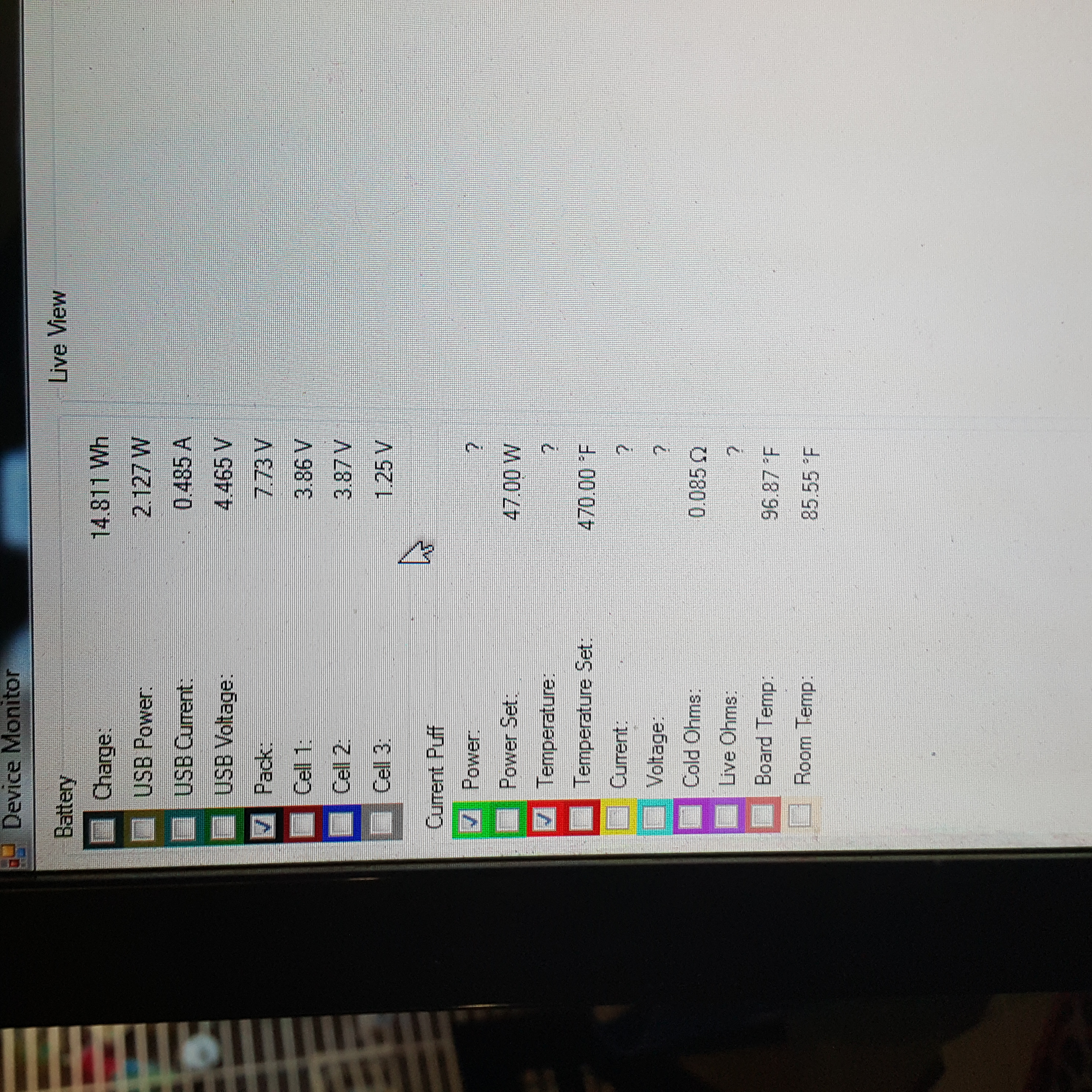

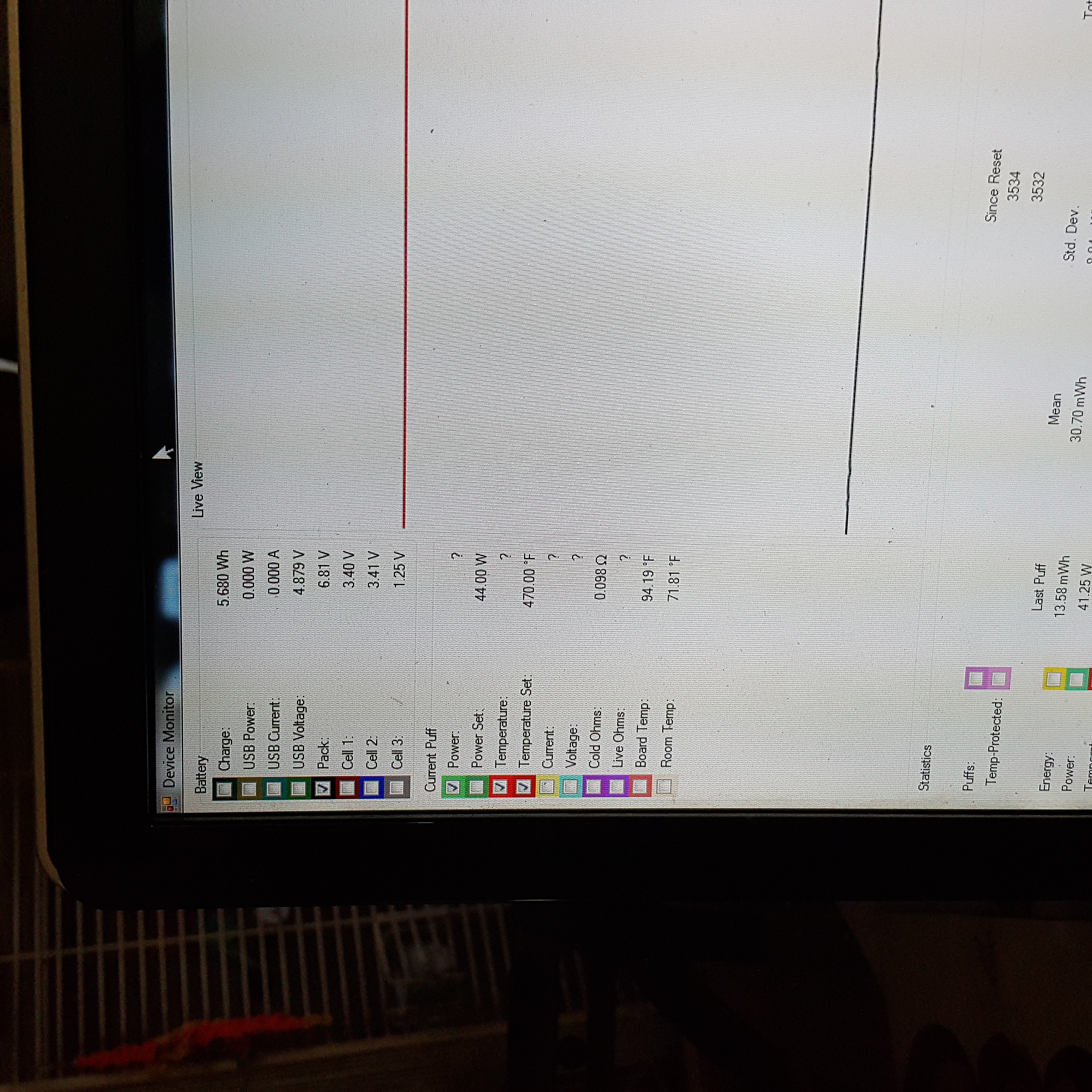

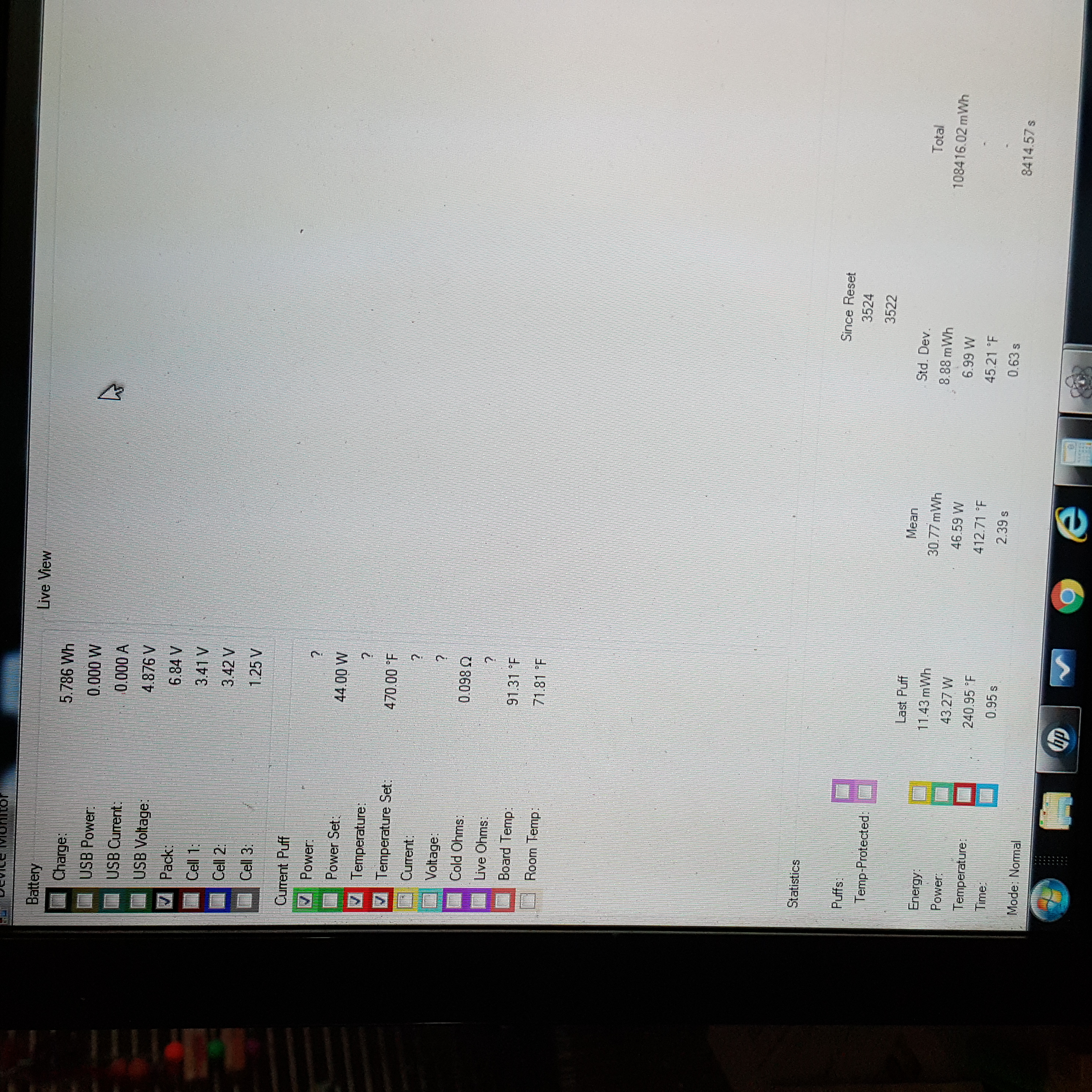

I do have 1 issue left to resolve. I keep getting a weak battery alert on screen when my battery bar is 3/4 full still. . I plugged it into escribe and the picture here is the readout. Everything looks right. Cells 1&2 reading 3.8 and cell 3 is reading 1.25. I know they set the limit to 1.5v on cell 3 so I'm under that. . Only thing I can think of is maybe the tap connection at the battery tray is not perfect and if it jumps up over 1.5 it causes the chip to enter 3s mode and then thinks the battery is low on that 3rd cell. But it never gives the message when the batteries are fully fresh and you'd think a connection issues could cause the message to be seen at any time..any other thoughts before I warm up the soldering iron?

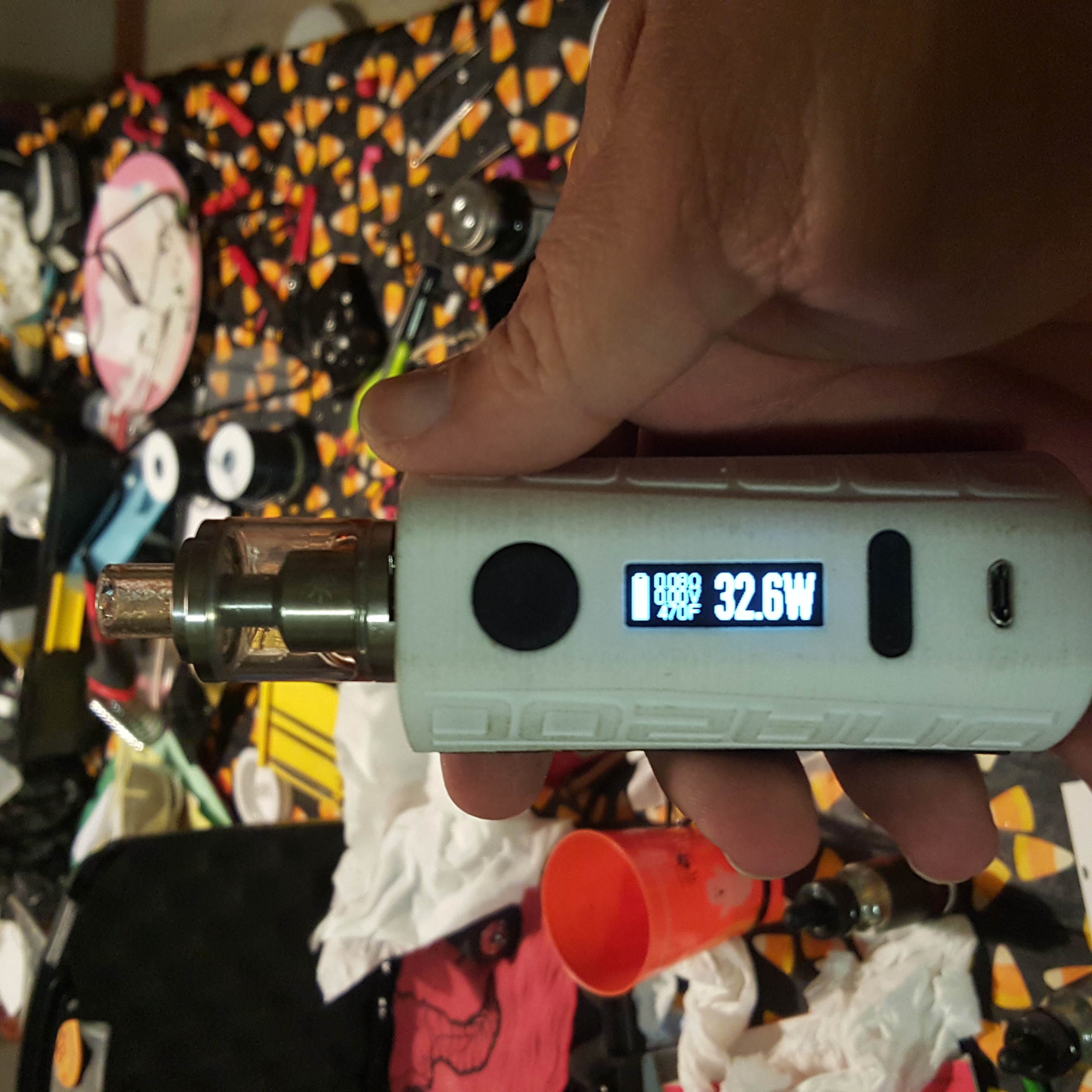

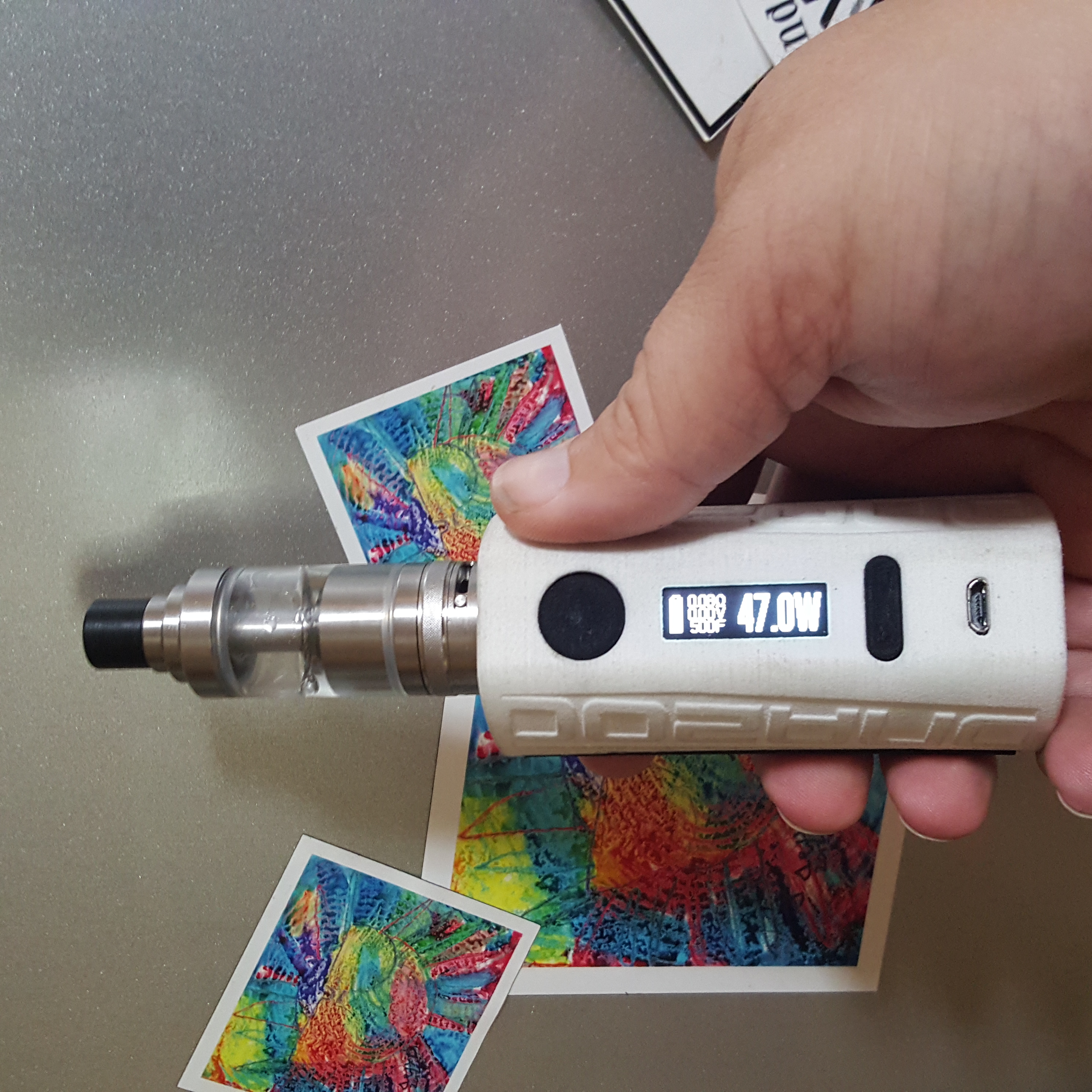

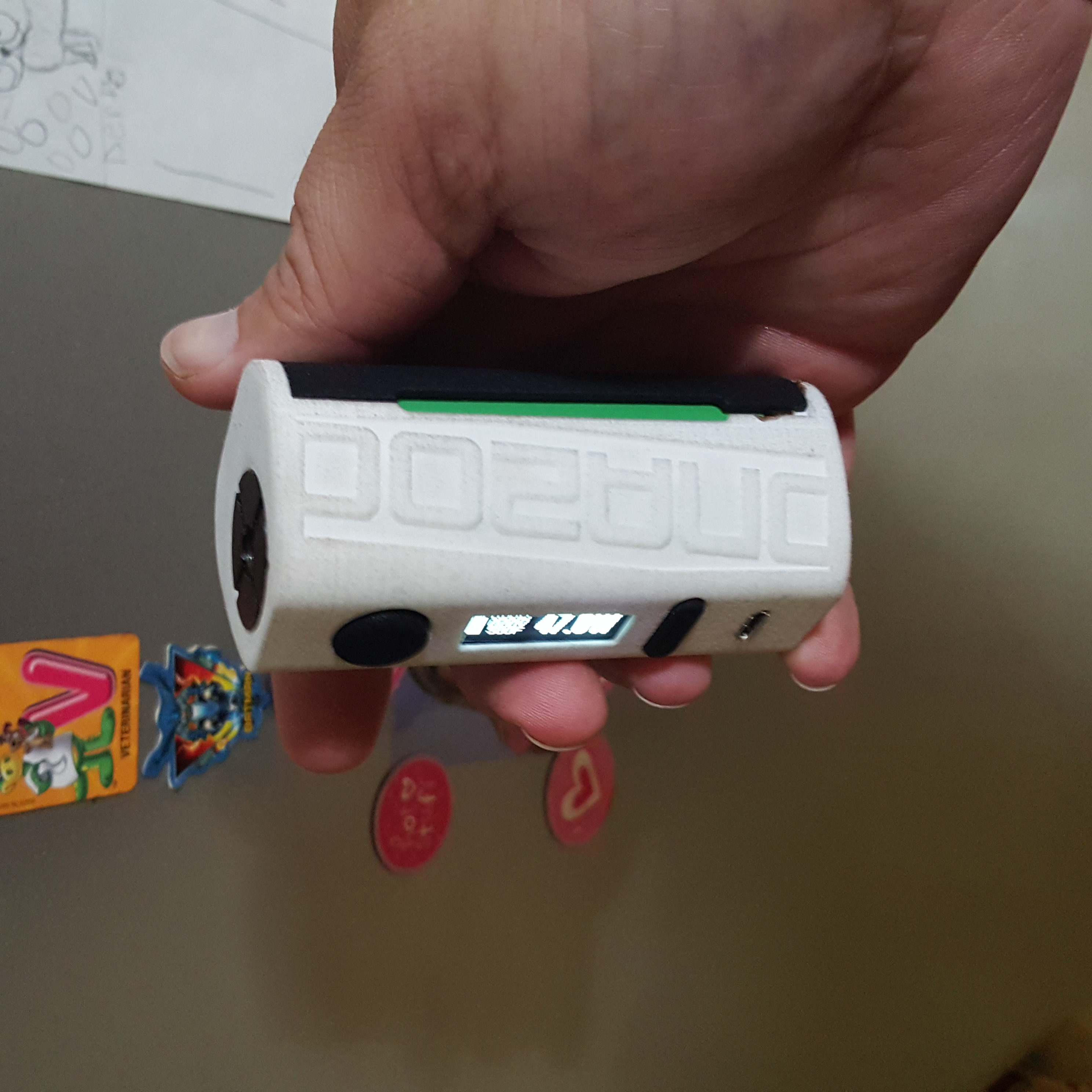

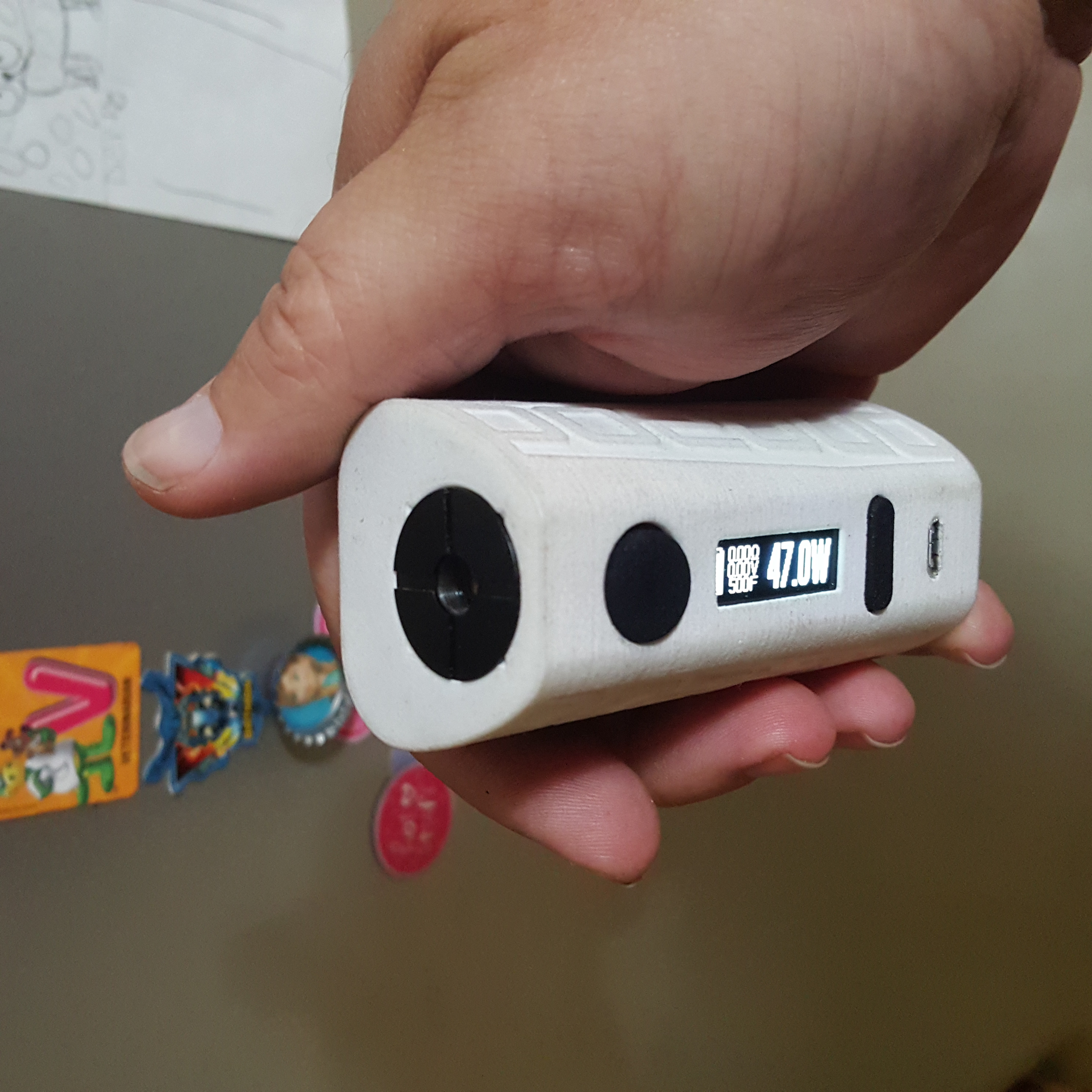

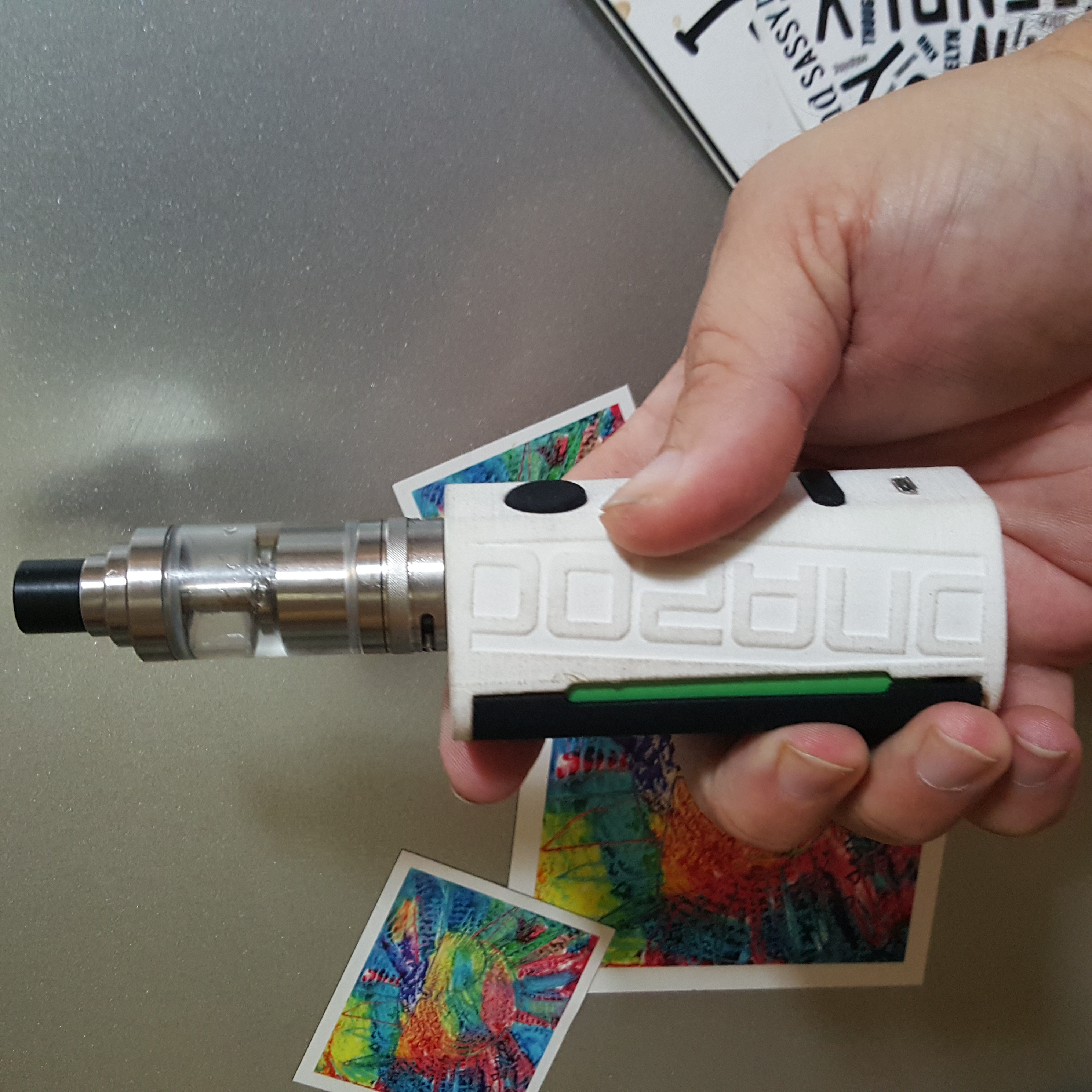

After 2 solid weeks of pounding my head against the wall I finally got this boxer style dual 18650 dna 200 built. I had everything right but the chip wouldn't stay powered. Come to find out the ground pin from the balance tap had come loose where soldered to the board and I couldn't tell it because it was already mounted in the case! Talk about frustrating! I nearly lost my sh#t more than once and was tempted to light the whole thing on fire. In hindsight, I should have picked a much bigger enclosure to use for my first time ever soldering or modding. I have an authentic boxer with 350j and love it so I thought this would be fun. .lol. I'm very happy with the chip and the enclosure fits as advertised but it's no where near as beefy and solid as a authentic boxer case fyi.. I see that Ginger vapor is selling the authentic in a build yourself version and I wish I'd have gone that route for the exact same money I spent on this reproduction. But it's built now and I'm gonna vape the piss out of it until my Alpine tech 1590g plus gets here then I'm gonna attempt to get this build put into that! It's a viscous cycle!
Finally figured it out. .the ground pin had come loose in the pad where it is soldered to the board. That little dude cost me every night after work for the last 6 days! I always learn the hard way. Anyways thanks for your assistance. It helped me figure out the issue .

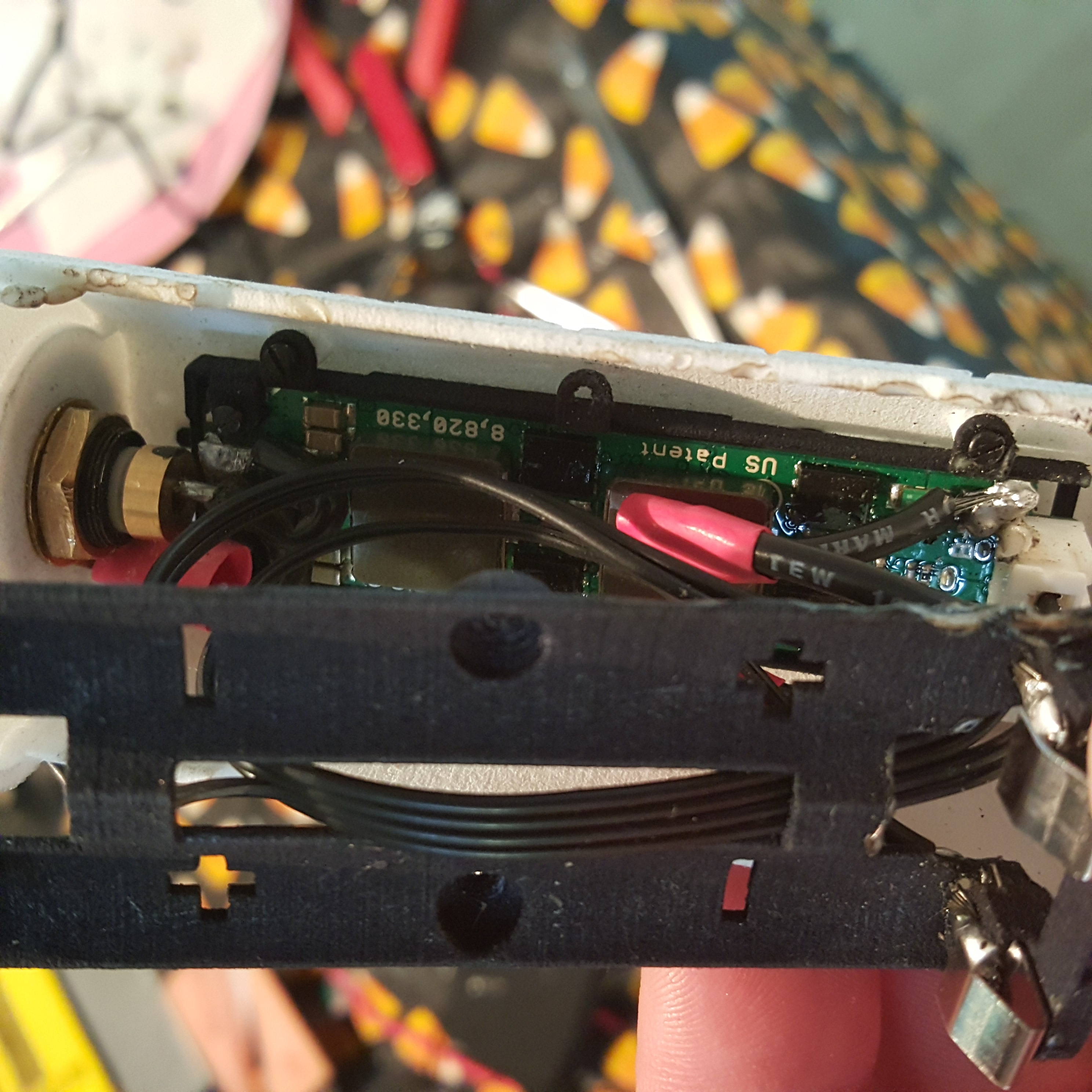

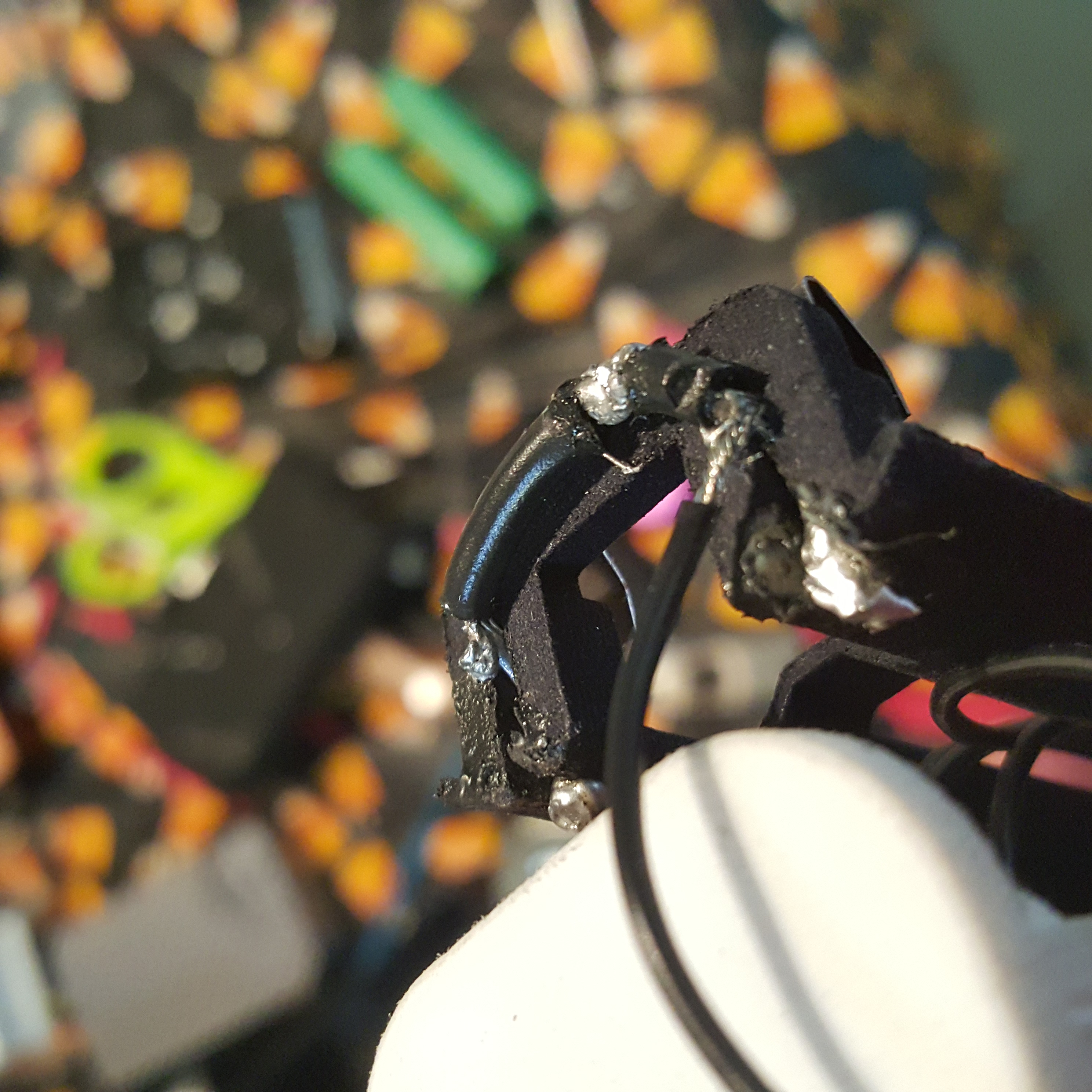

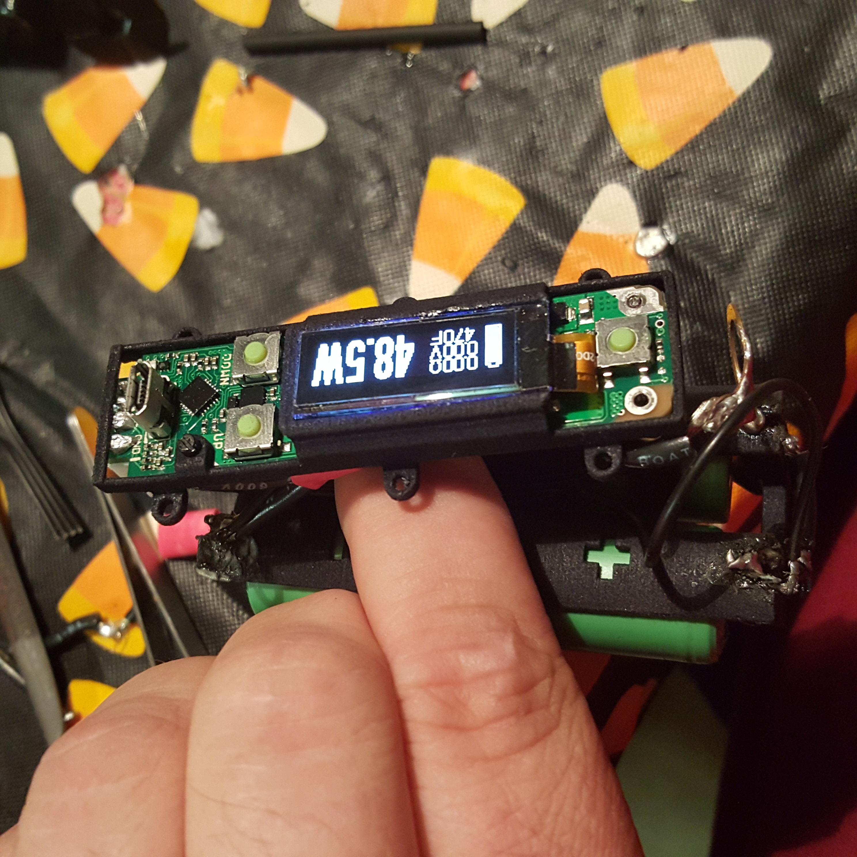

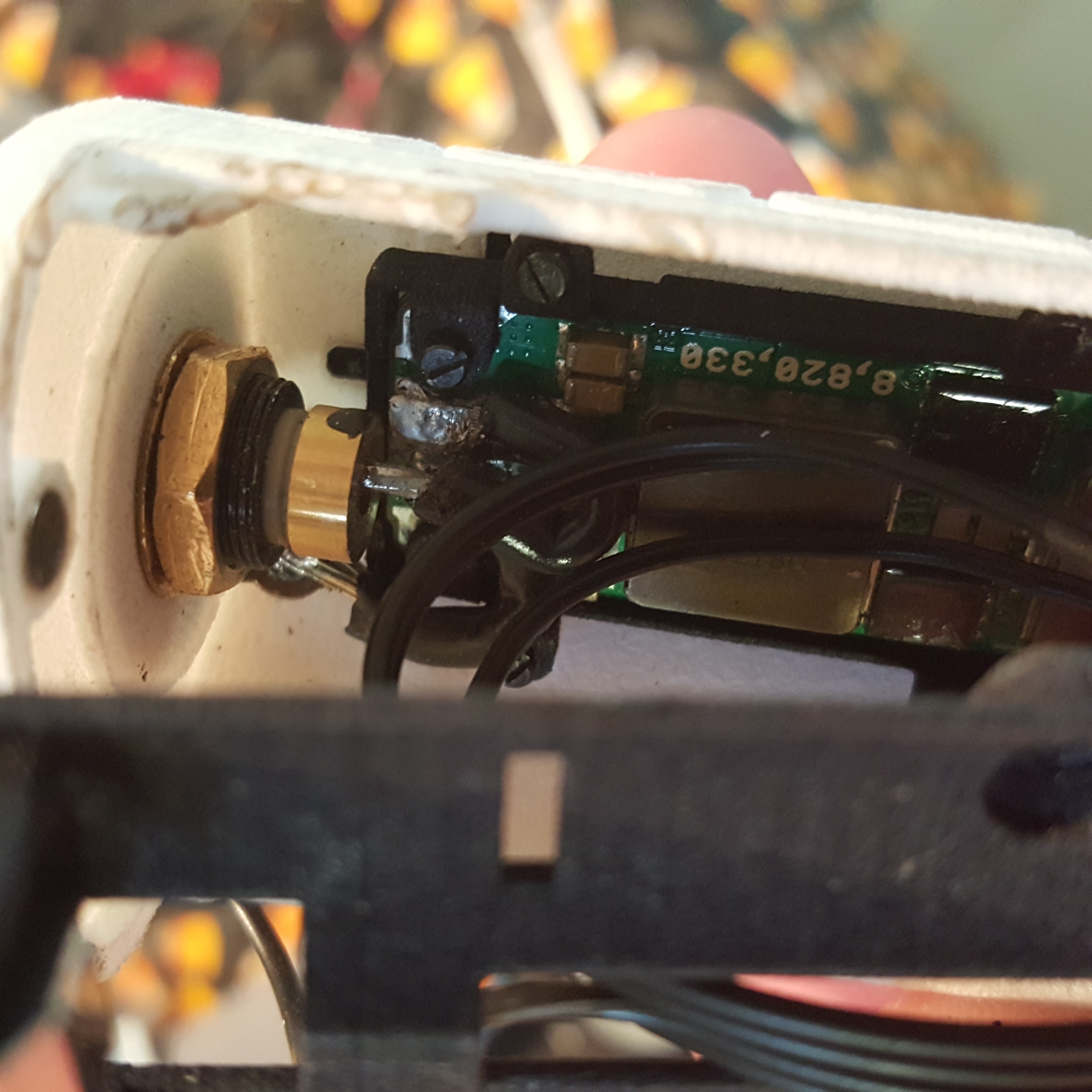

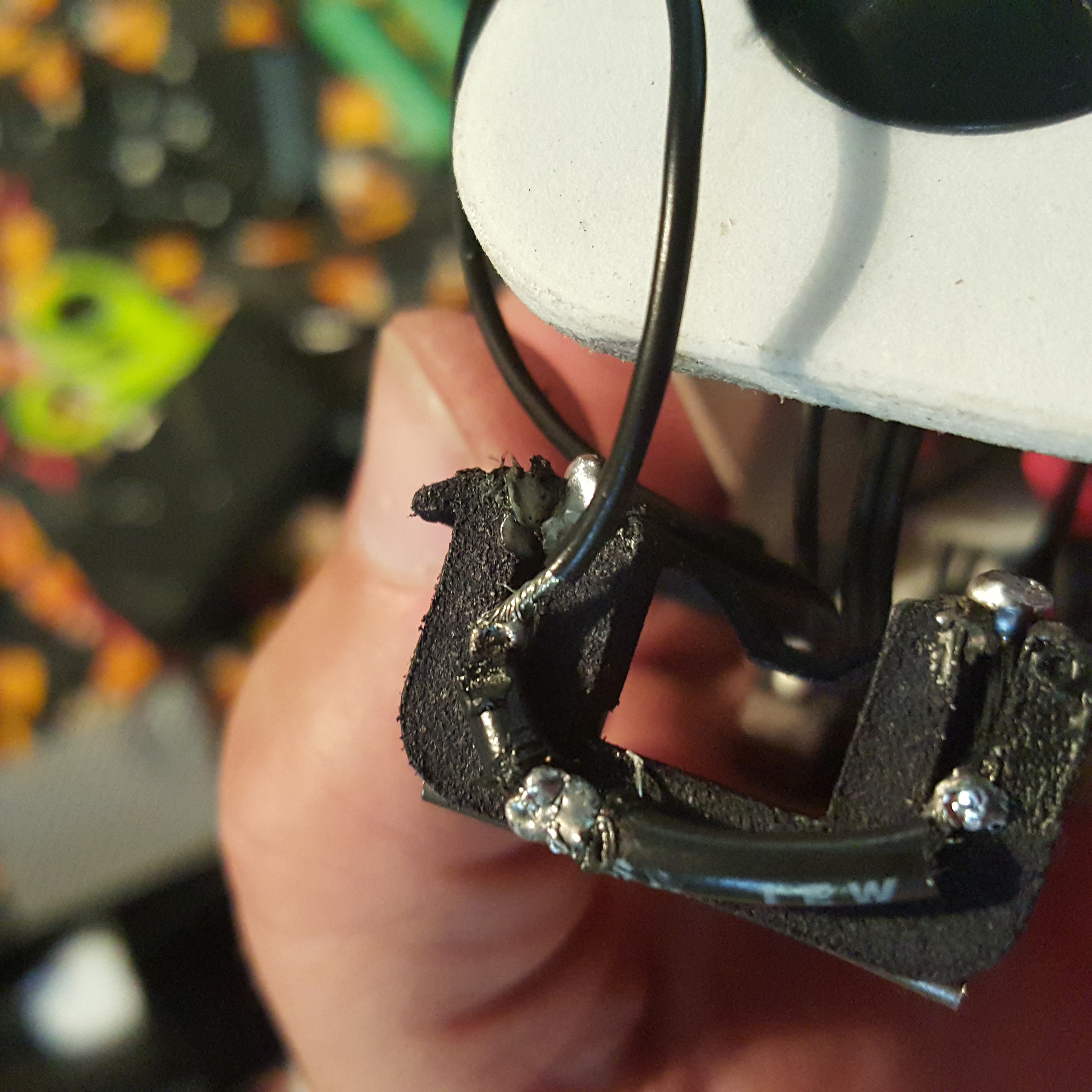

Took the mount out so I could provide better pictures and soldered the pos and neg back on and it fires up just fine. . So could bad connection at the positive output side cause this? I have a hard time believing it was the connection at the b pads because I've redone those at least 20 times. .keeping my fingers crossed it works when I re install it back in the case!

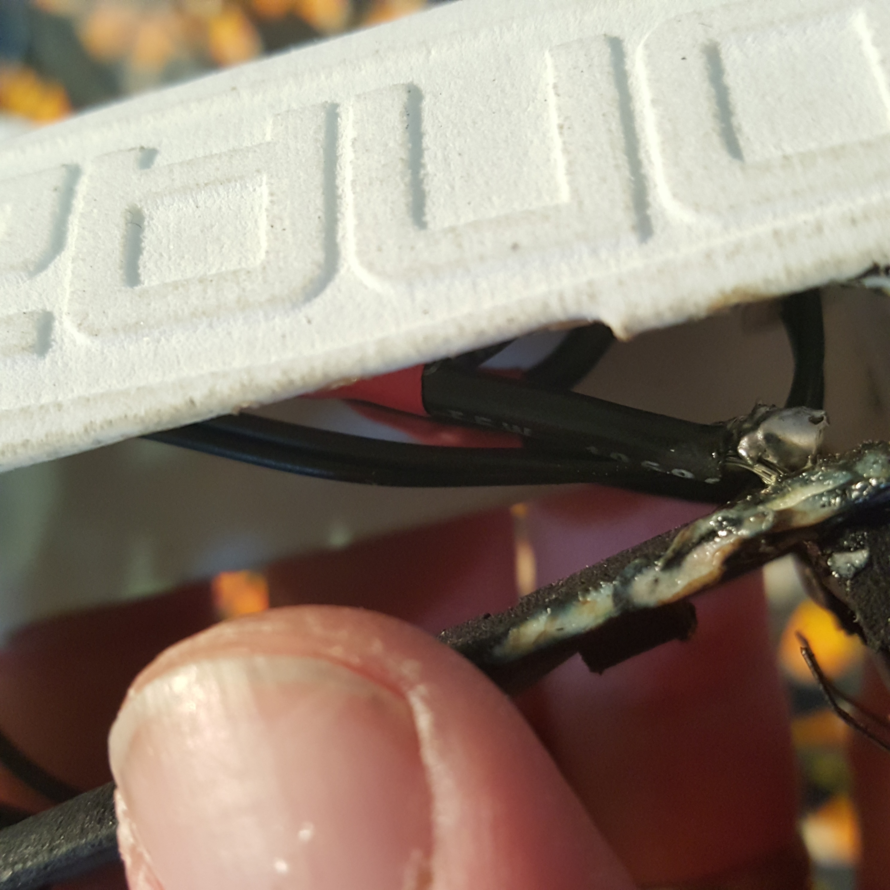

Here's some pictures. Hard to get good ones with it mounted in this tiny boxer case. I know it's not professional level. First time ever soldering. .
Yes twisted together, then soldered together then soldered to the bridge. For reference ,I did have this mod working but my positive 510 came a little loose so I wanted to beef up the solder and took the battery tray out to do it. All my problems have come after. Thiso is the first time I've ever soldered anything or built a mod. So it didn't come as a shock when I started having these issues but I've gone back and done this so many times now it is crazy. I will get some good pictures for you and I think I have a multimeter but I'll have to dig a little. Thank you for your help
Ground is run to b neg battery tray. 1 is run to bridge on battery tray. 2 and 3 are twisted together at the end and attached to positive on battery tray. Thanks for your help. I've rebuilt this thing over 30 times no shit. .about to loose it!
