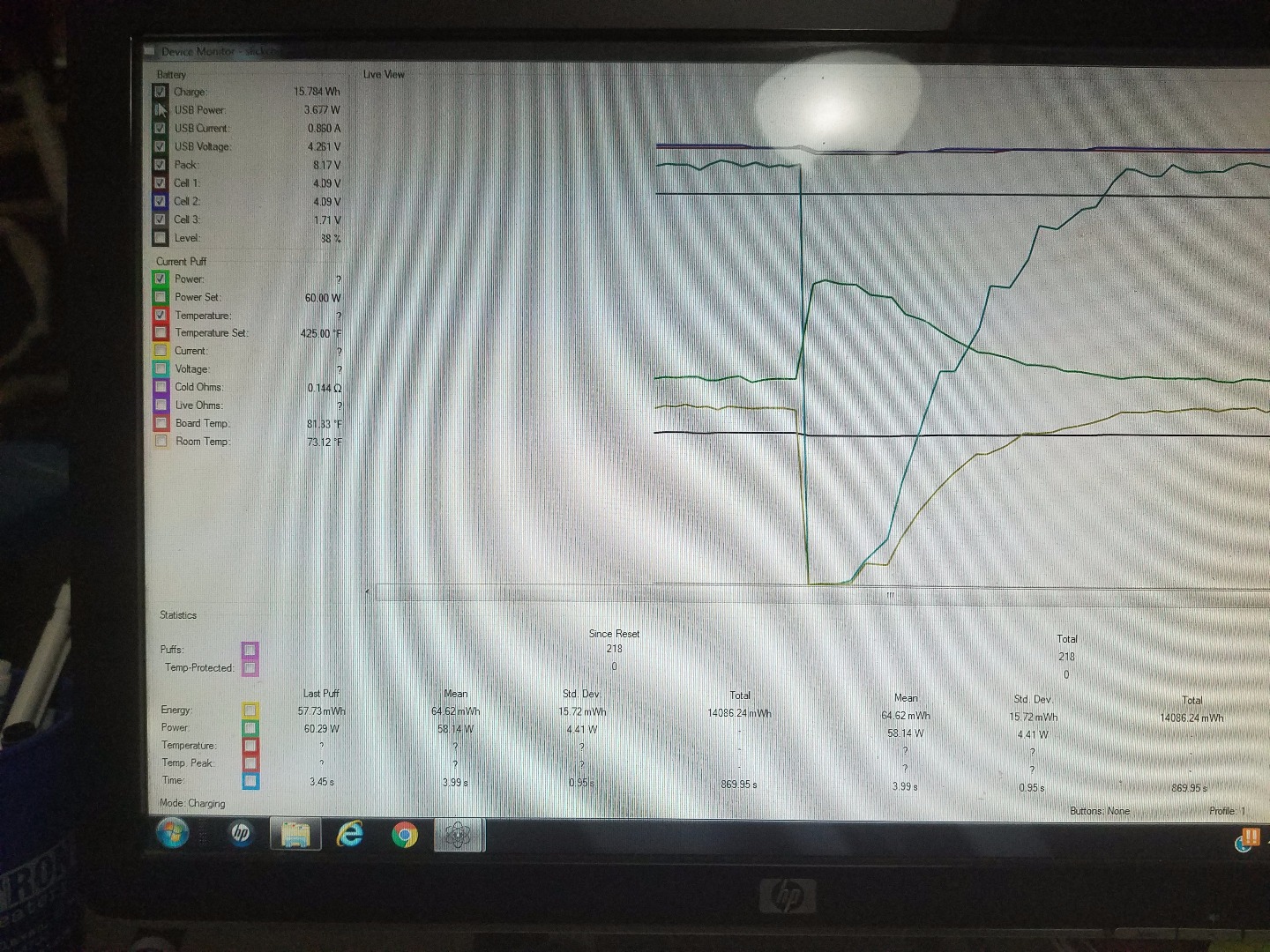

No! That's the main reason why I wrote this thread lol ... got me stumped. The device will not normally fire while plugged in to a USB wether it be connecting to escribe or just a wall charger. One time out of 30 it might actually fire and not say check battery. I did notice the cell 3 fluctuate while fire. Went from 1.8 to 1.2 and everywhere in between.. Thank you for your help so far btw, greatly appreciated. If you need better quality images I can get screenshots off the computer I just have to log in evolv forums and I was being a little lazy earlier I guess with the phone pics. -

Yeah I believe so. If I had accidentally switched the taps that are supposed to go to positive battery end over to the negative end then I would think that would cause the board to not operate. No? The mod runs great. It's just seeing the cell 3 have that high of voltage and the non firing when USB plugged in. Other than that no issues at all... -

Hey I've made a few dna mods and have a little experience. However , this dual 18650 build I just did with the new 250 board is giving me a little resistance. When I plug the USB in and go to device monitor panel my cell #3 reading seems very high at 1.79v. Now the total in the battery pack column only includes the value of cells 1&2 but last time I checked I thought 1.2-1.5 was where evolv wanted the 3rd cell to be (or under that). The second thing is that if I push the fire button with the USB in; I will get a check battery or wreak battery window and it will not fire. Is this something evolv did as a safety feature for the 2amp protection or is something funky going on? Thanks! -
When that happened to me it was 2 things. First I didn't have a great connection on my sled. My first time soldering and the work was rough. Once I redid that it was still doing the flash so I tore it down and inspected every single connection. Come to find out one of the pins on the balance tap that solders to the board had broken connection at the board joint. Once that was re soldered it worked great. Good luck.
