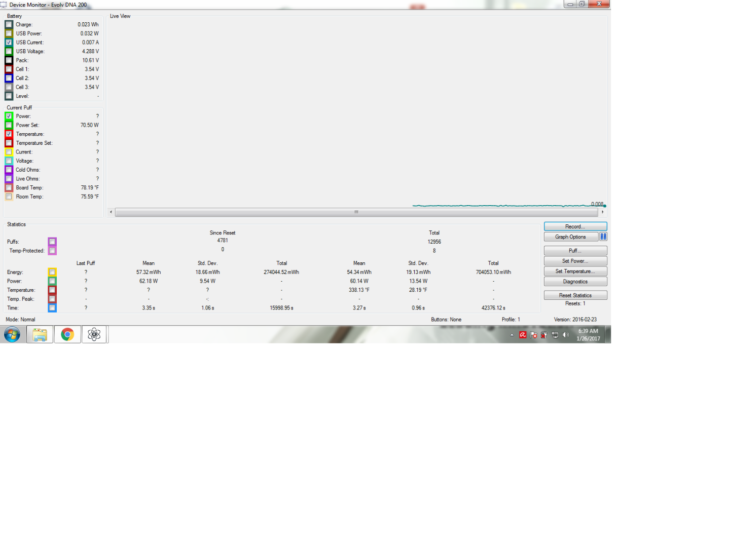

When i changed Lipo with a second one, a good one, device turns on and battery bar is not empty at all ... i conected to Escribe and i made a print screen to Device monitor.... I attached a CSV file with device monitor with my second Lipo. panzer_dna200_problems_with_second_Lipo.csv

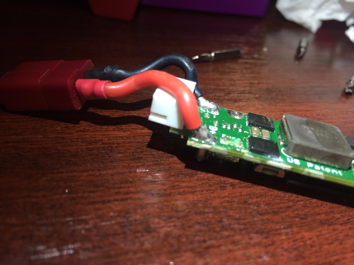

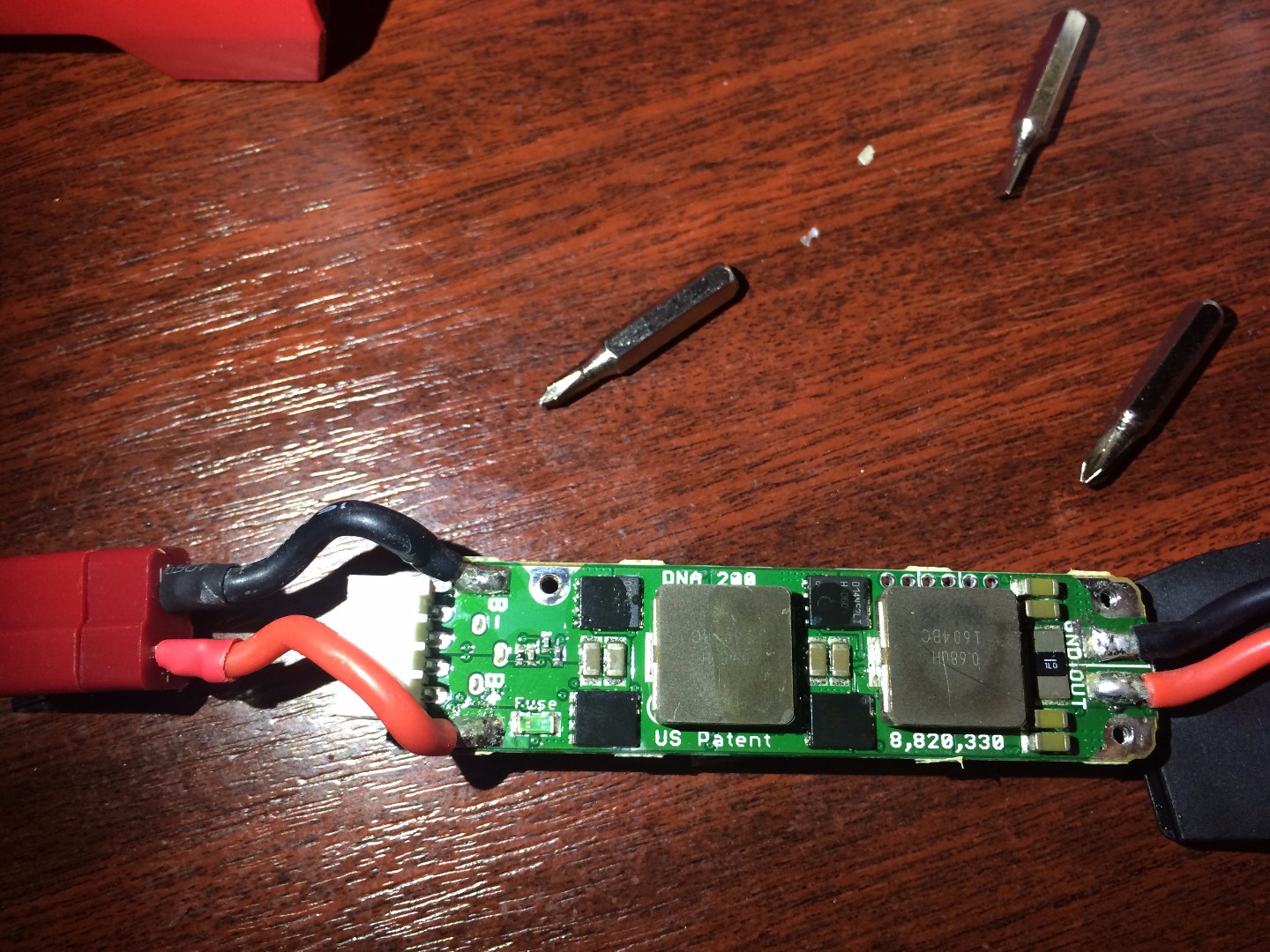

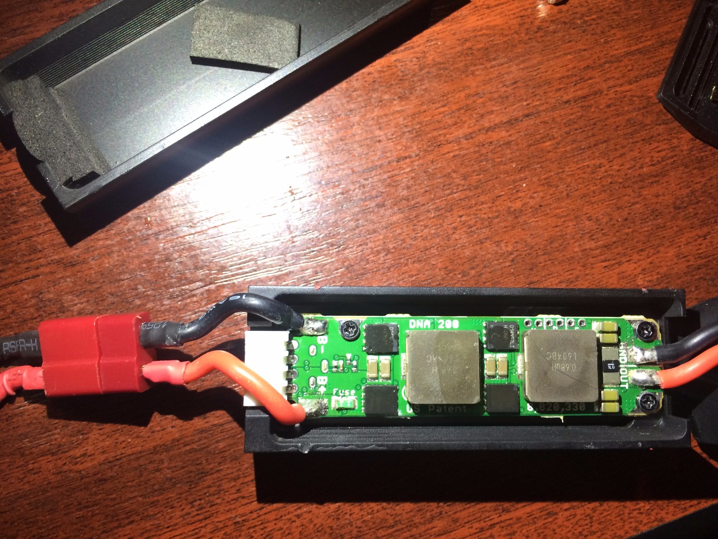

Hello, when i am bridging fuse with a pair of tweezers, it appear some sparks and if i press fire button, device turn on and show warranty service. After i take tweezers off.... device don`t turn on anymore. What does this means? Thank you.

Something happened.... after i updated firmware... on my Device Monitor....cells voltages are not constant.... do you have any ideea?

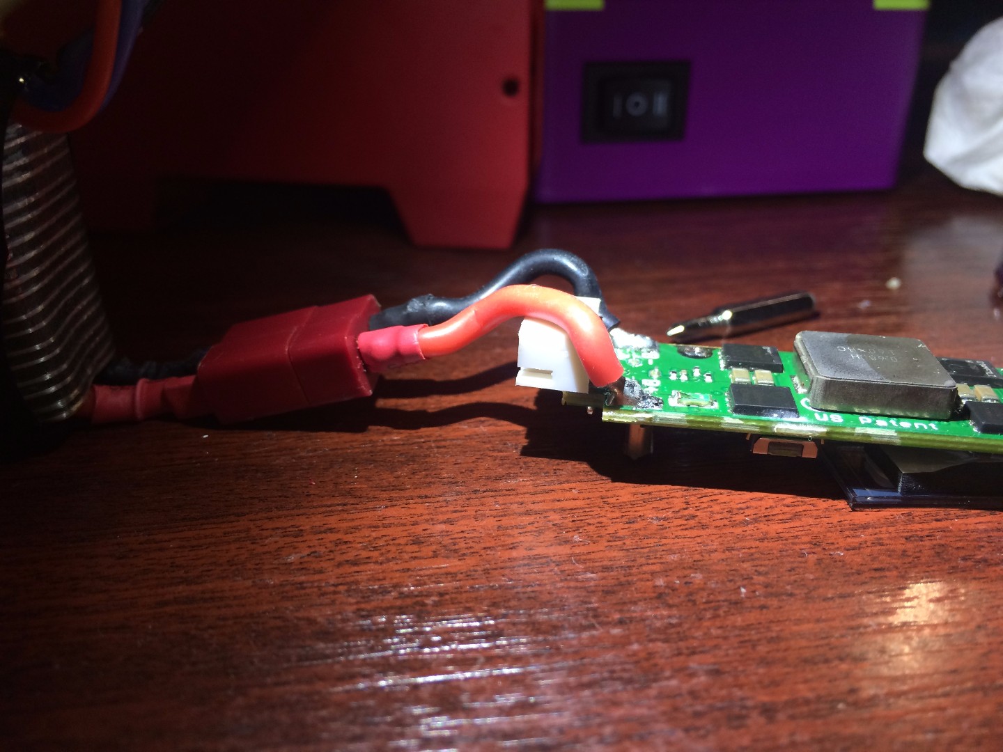

Hello again.... i have again problems with my second Panzer box mod DNA200... I think fuse blow.... can you help me? I will attach some photos and a youtube video. https://www.youtube.com/watch?v=F1gENuPRP0g Thank you.

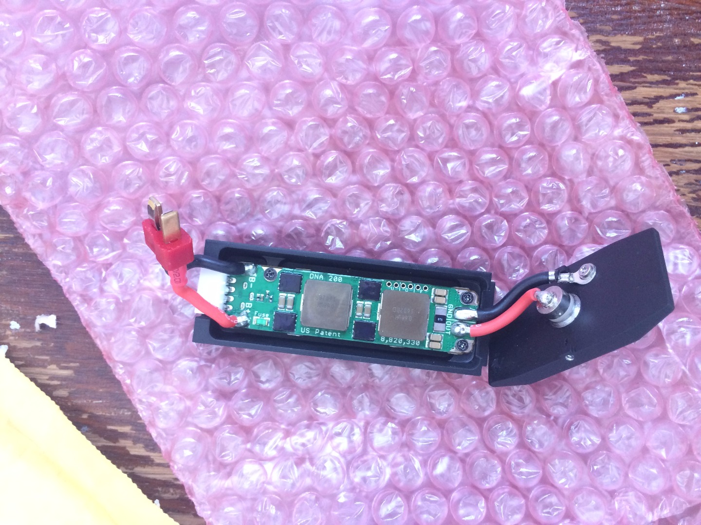

Evolv helped me and changed my DNA200 board! Thank you very much Evolv !!! Great company, great people, great products!
Thanks guys ... Eric from Evolv contacted me and helped me with this DNA board ... i sent board to USA for changing it ... now i`m waitting it. Evolv = Great products.... Great services....Great People !

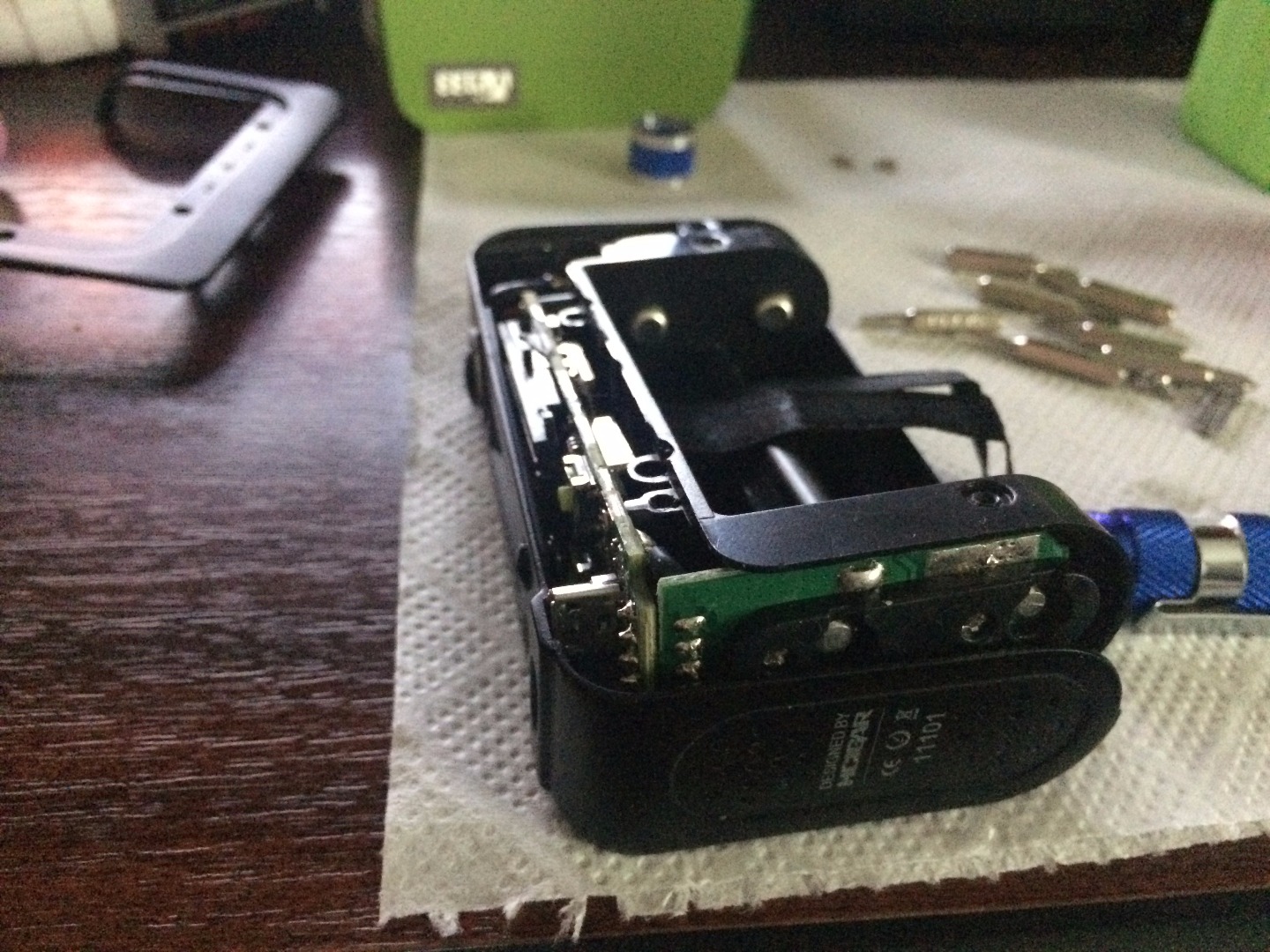

( I can not throw it in the trash that Dna board....only because it can`t charge ... it doesn`t seems to drains cells different on my li-po .... I opened VT133 and it is very tight inside than Panzer box.... it has a separate board for 18650 conection ....

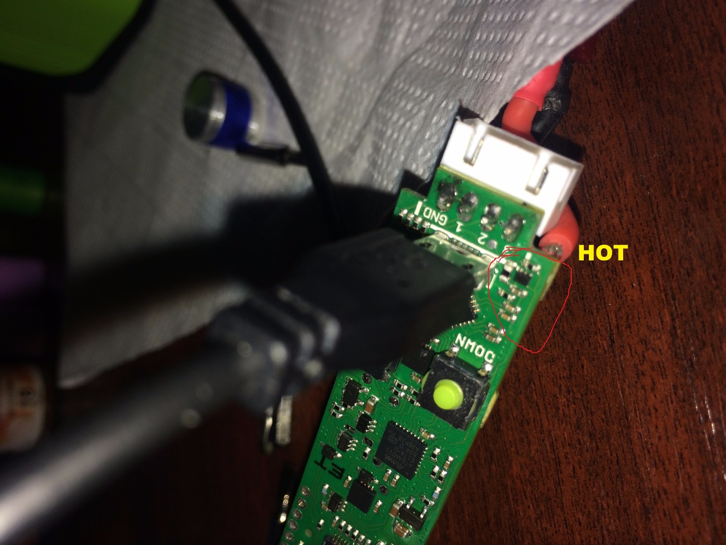

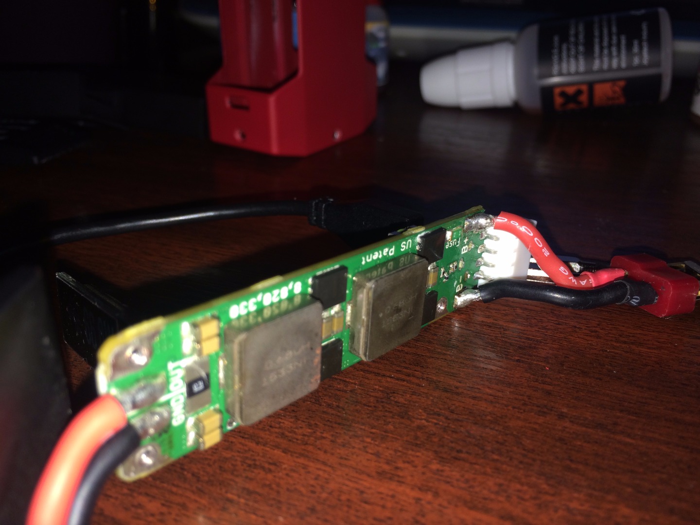

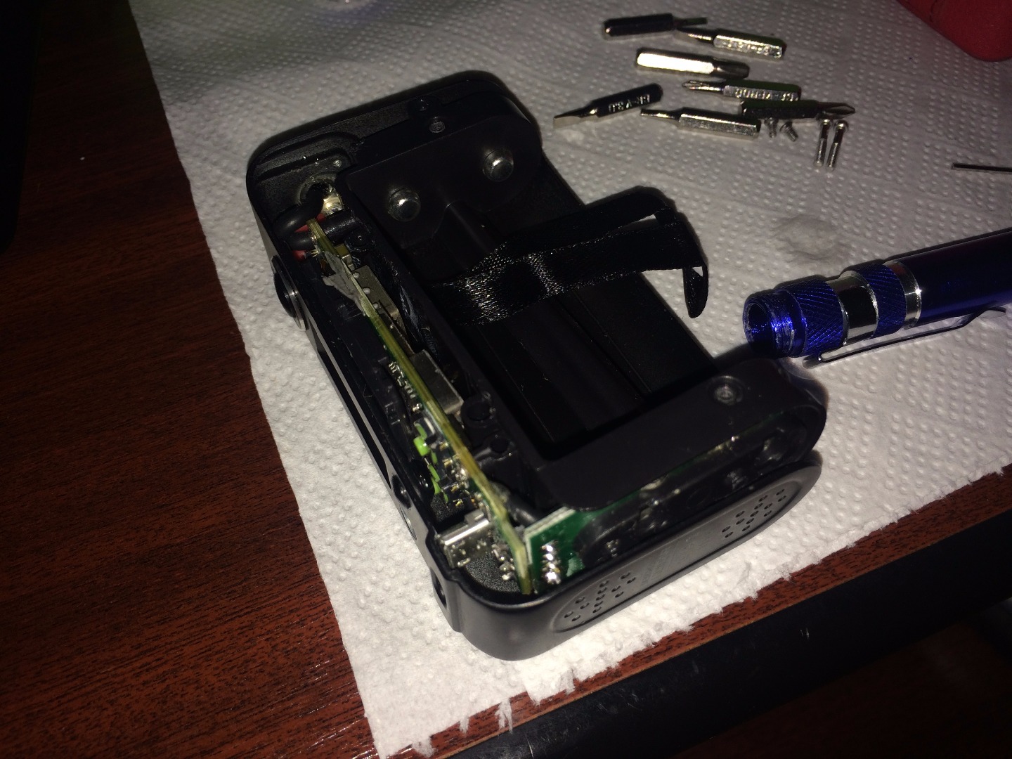

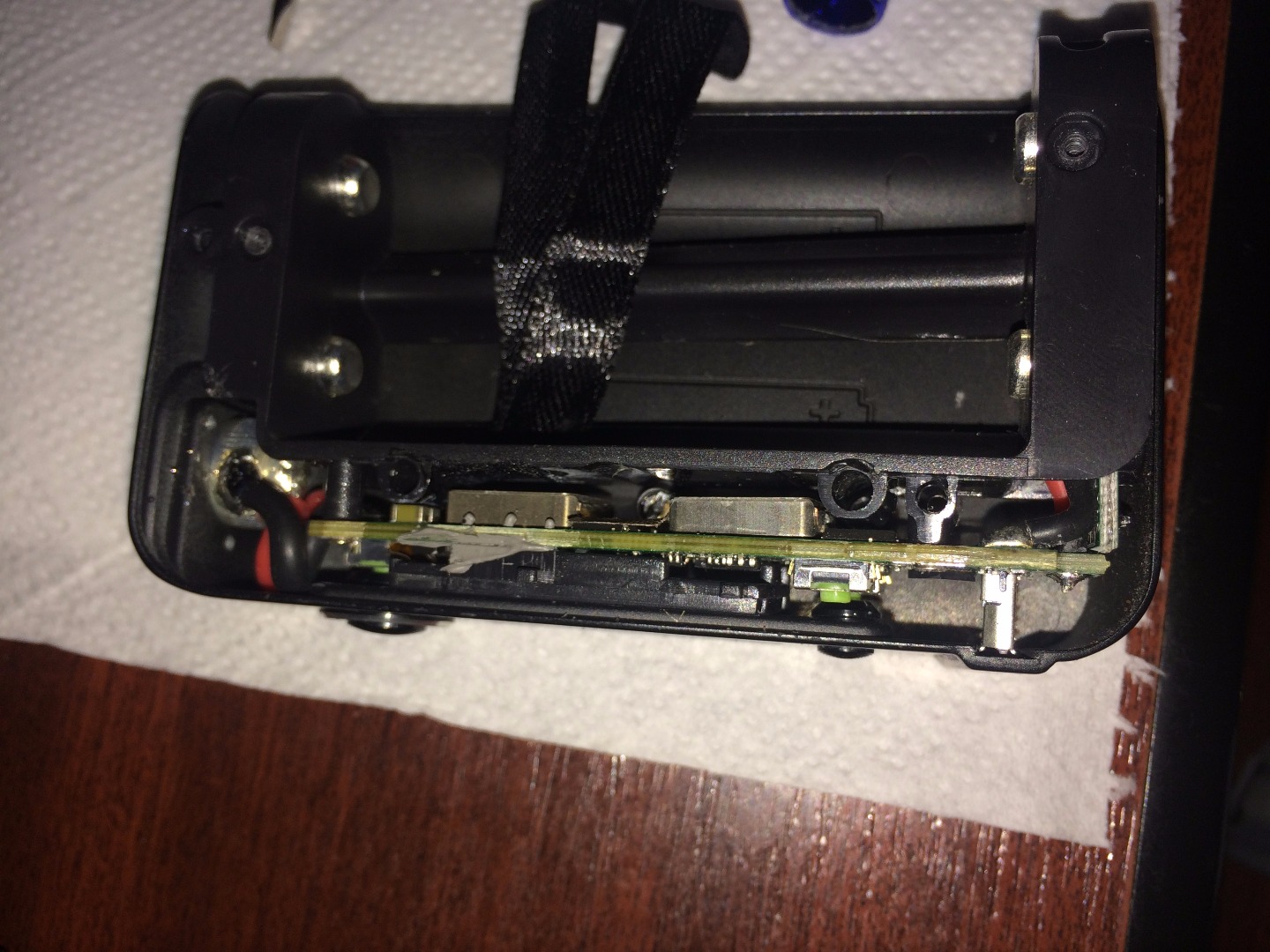

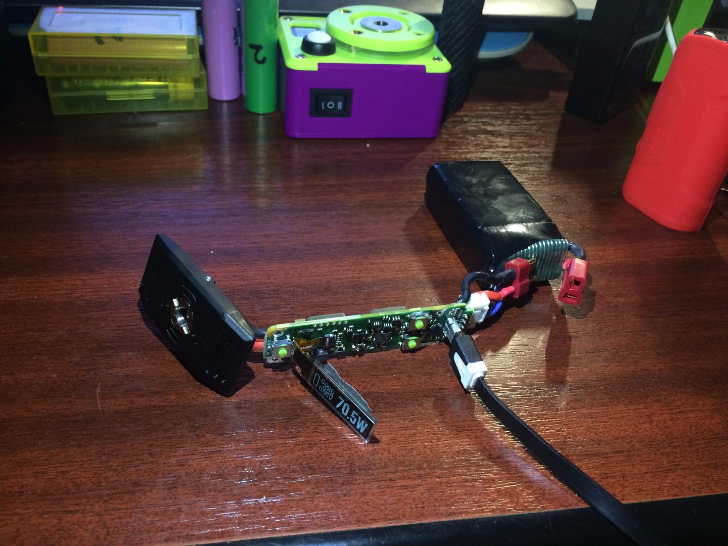

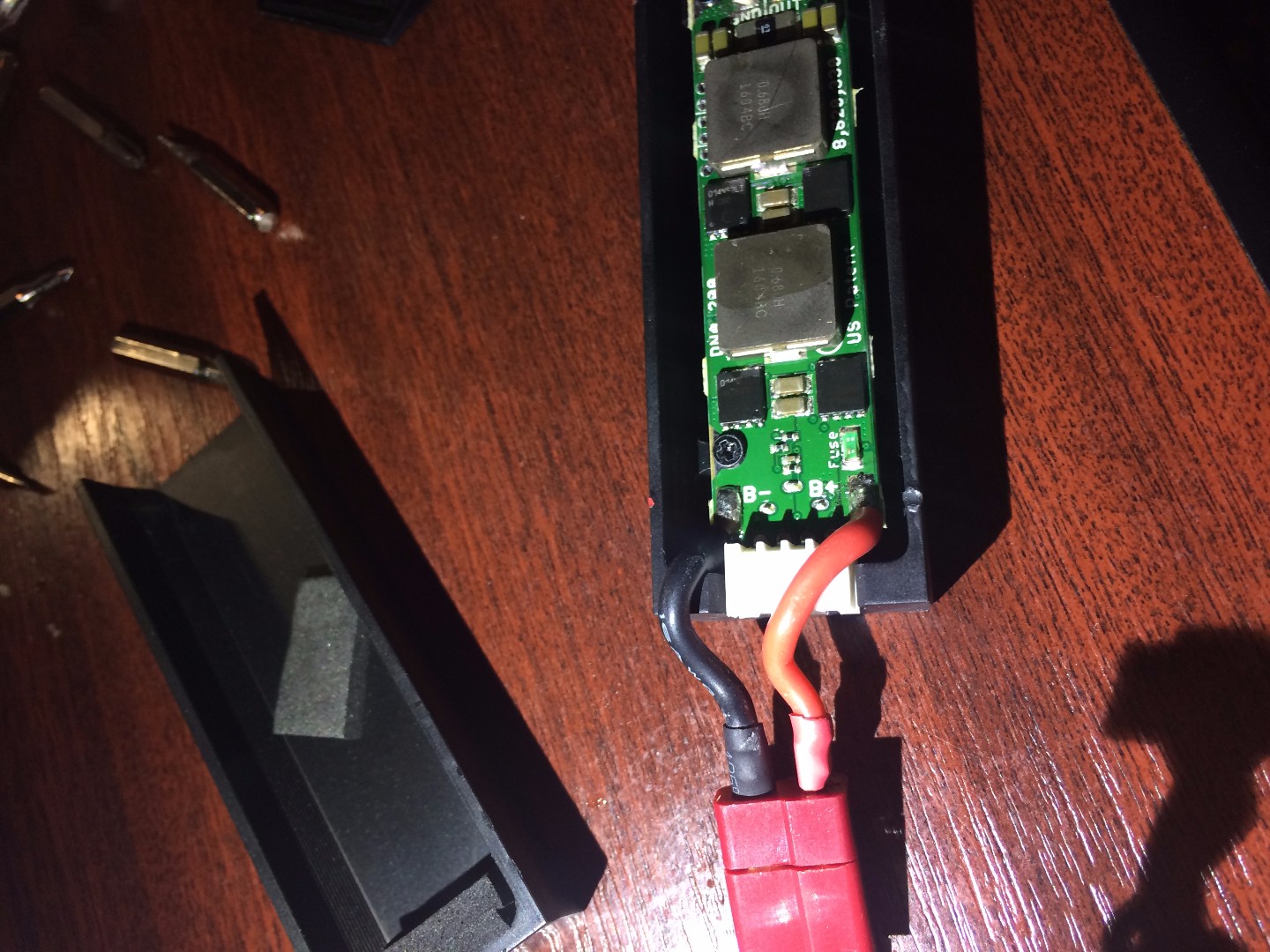

I tried with 2cell Lipo... nothing... it shows 0.93 A from laptop USB ...and the 3 battery voltage does not increased .... I figured that near USB on the board is a very hot small area .... only on one side... Lipo was disconected...you have some photos with that area on my board. 1. Do you think that an electrician can repair this board? 2. Can i change this board with another dna200 from a Hcigar Vt133 where i`m charging batteries on an external charger and put there this dna200 wich fails to charge Lipo ?

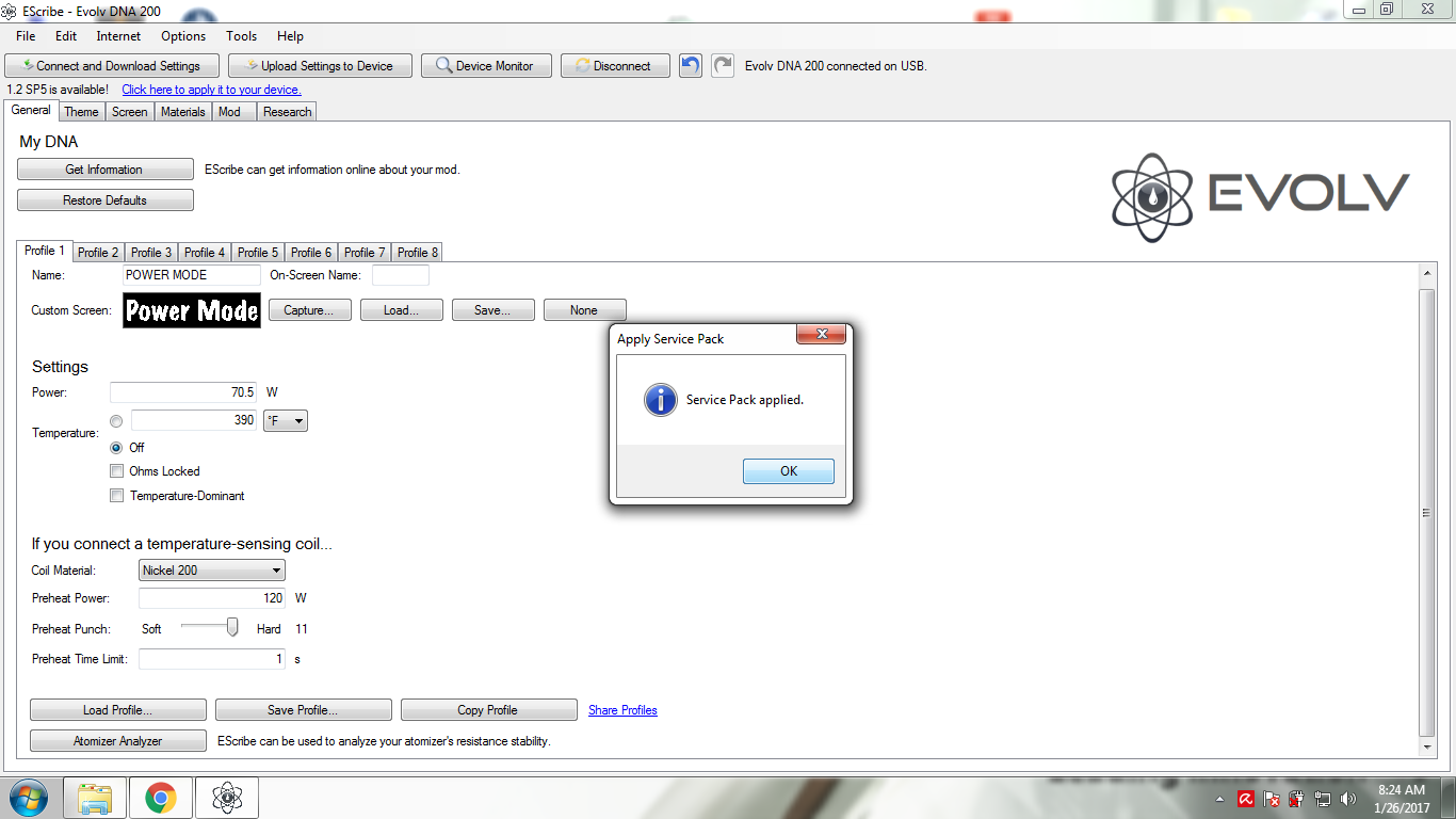

When i click Soft / Hard reboot it appears a little window with ``Soft / Hard reboot command issued`` ... is it ok?

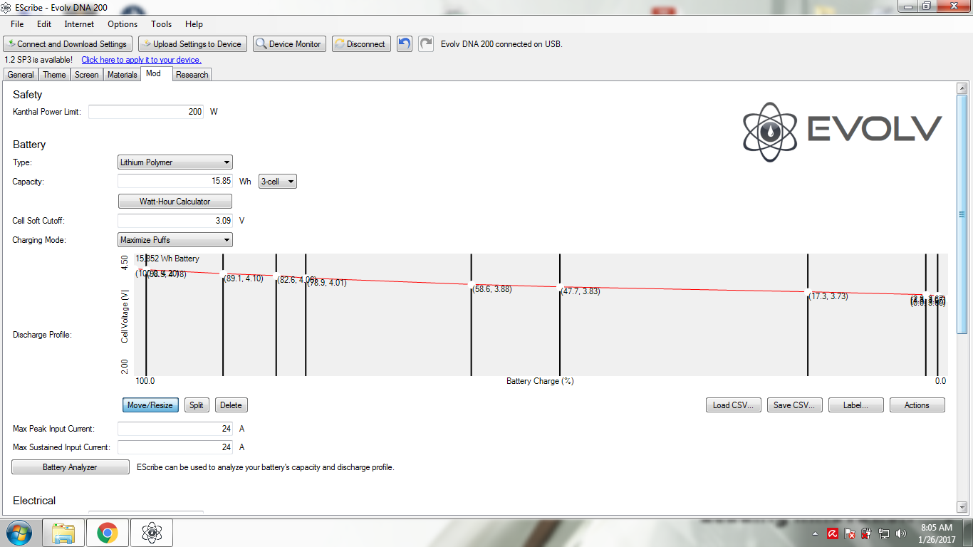

Lithium Polymer selected and 3 cells ....

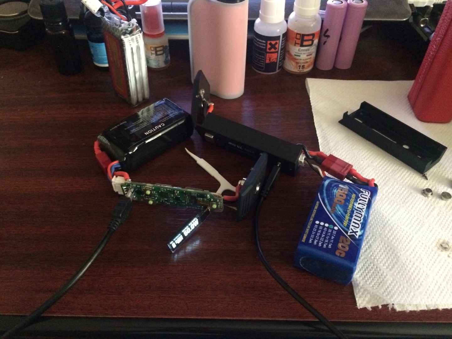

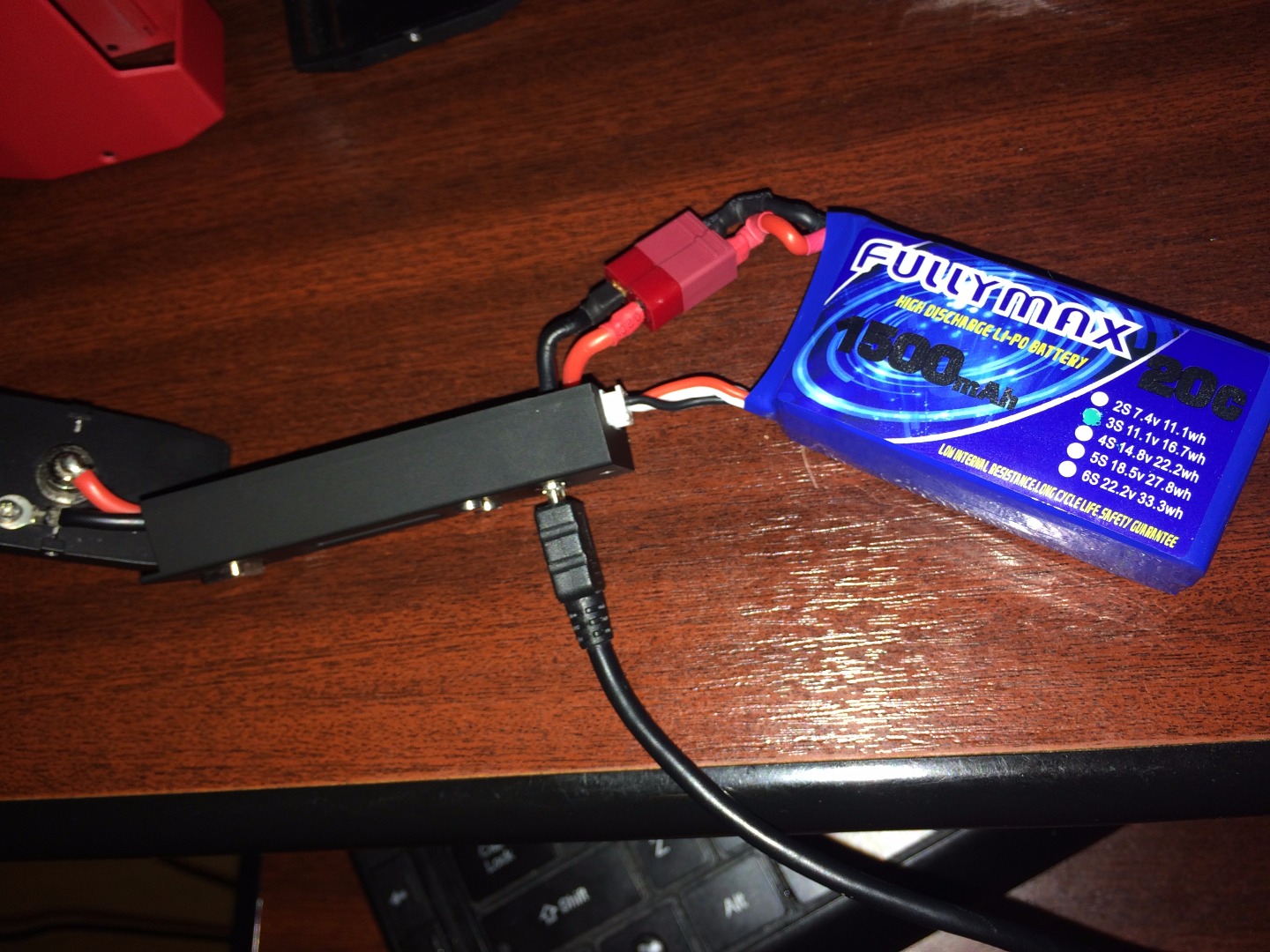

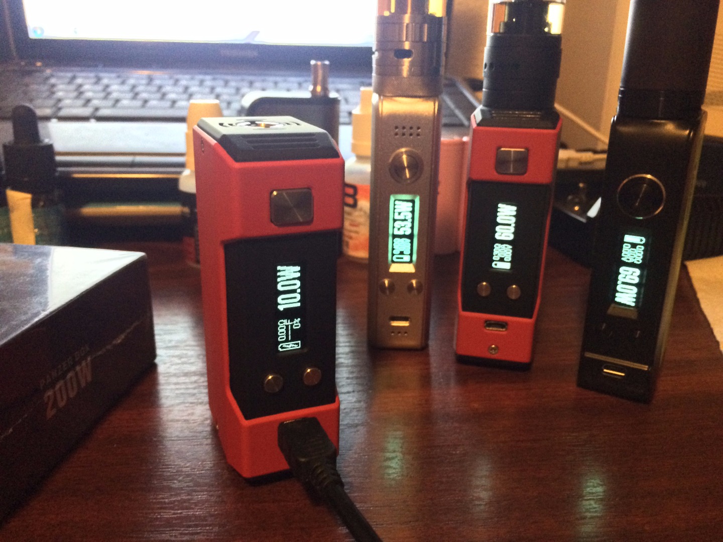

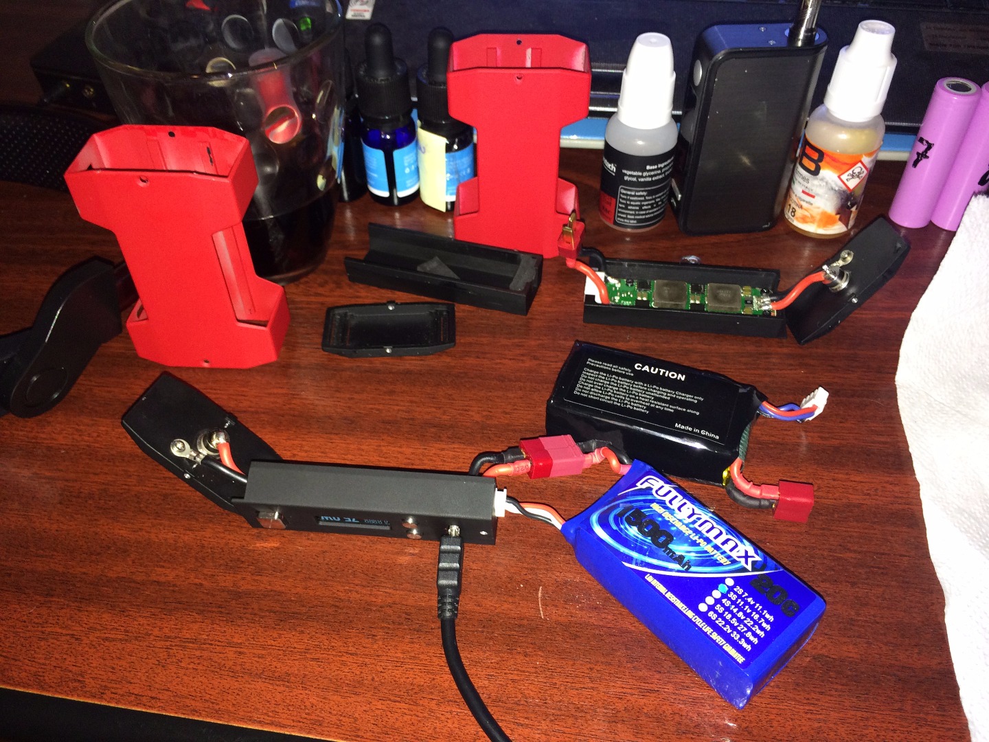

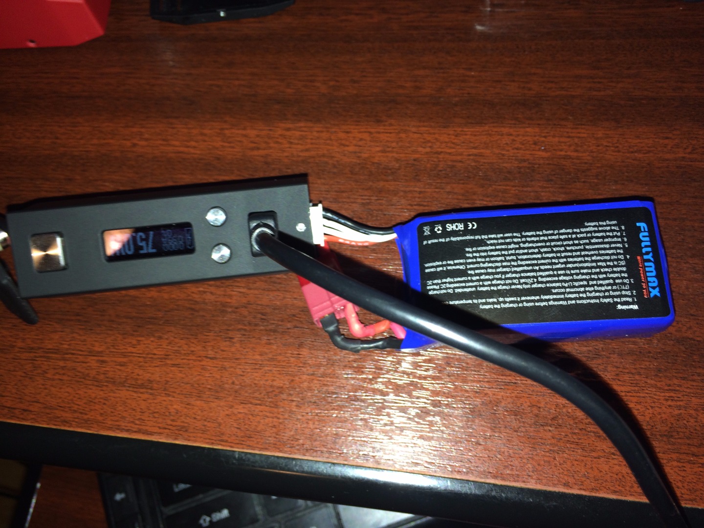

Hello, I bought my second Panzer Box DNA200 from Gearbest with serial VBNGZARWGKVZ of the DNA board. With this second one i have a problem with the board. It doesn`t charging. My first Panzer box came with original Lipo but this second one has a Fullymax 1500mah 3S 20C Lipo. When it arrived, the battery was drained, i tried to charge but nothing. I changed with another Lipo and it doesn`t charge. After that i charged that Lipo on a Lipo charger and is OK now. All my Lipo batteries are OK now. I connected on Escribe and on my laptop USB it shows 0.95A charging but the voltage it is the same. I changed a lot of USB cable, i tried USB recovery charge .... Still the same.... The 3 battery voltage has not increased. I can charge my Lipo batteries only with other DNA board or Lipo chargers. I`m attaching you some photos with the board, Lipo and Escribe device monitor where it shows that is charging 0.95A from a laptop USB (where it should be max 0.5A) Please help me. Thank you.
