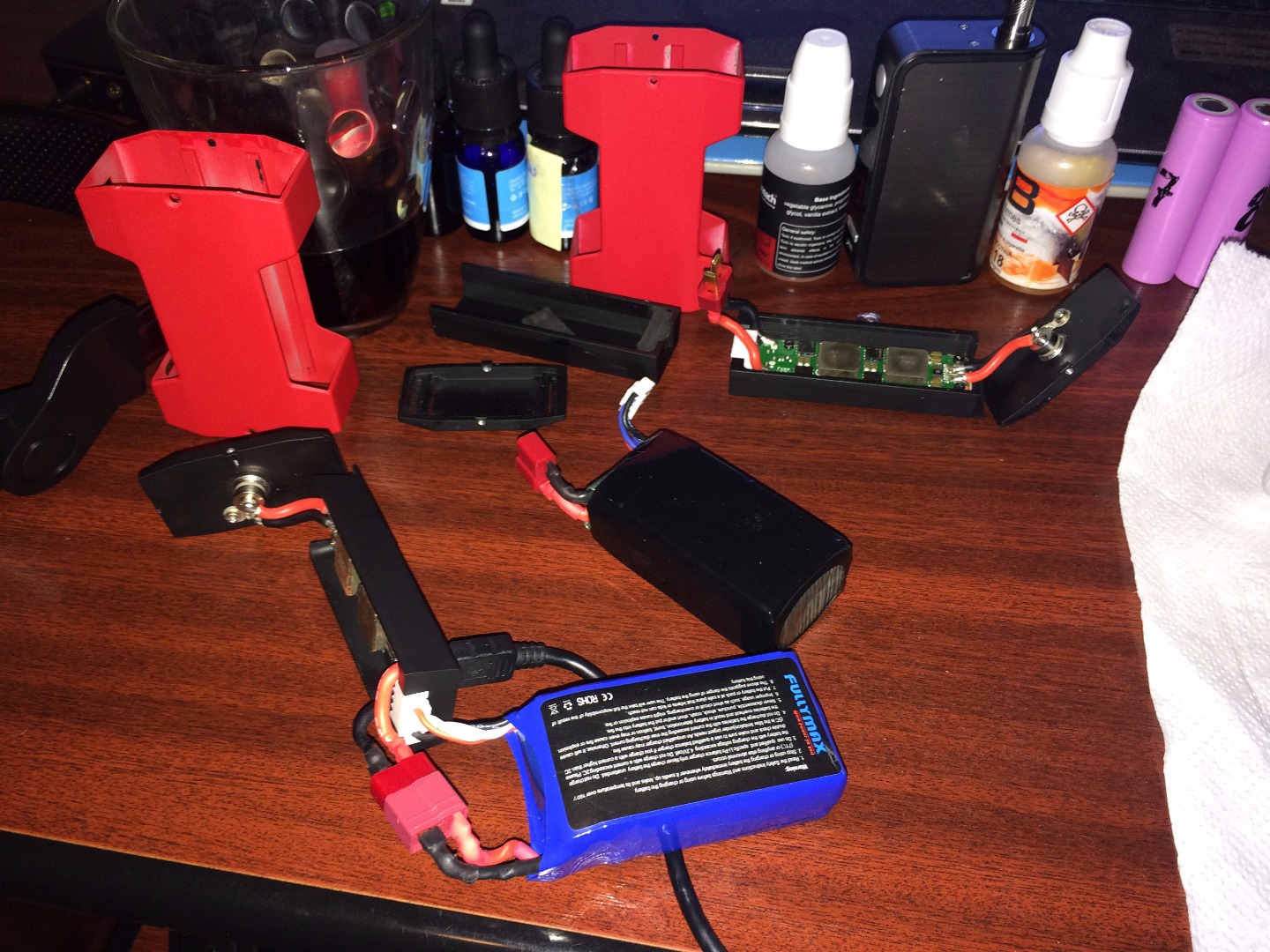

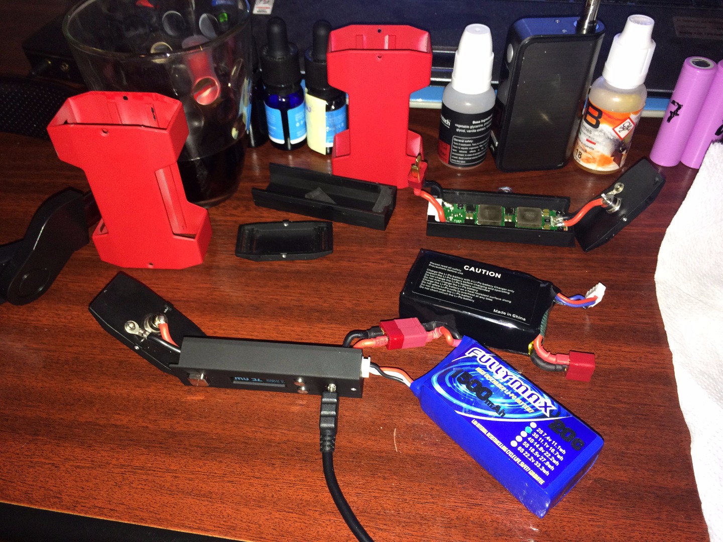

Hello, I bought my second Panzer Box DNA200 from Gearbest with serial VBNGZARWGKVZ of the DNA board. With this second one i have a problem with the board. It doesn`t charging. My first Panzer box came with original Lipo but this second one has a Fullymax 1500mah 3S 20C Lipo. When it arrived, the battery was drained, i tried to charge but nothing. I changed with another Lipo and it doesn`t charge. After that i charged that Lipo on a Lipo charger and is OK now. All my Lipo batteries are OK now. I connected on Escribe and on my laptop USB it shows 0.95A charging but the voltage it is the same. I changed a lot of USB cable, i tried USB recovery charge .... Still the same.... The 3 battery voltage has not increased. I can charge my Lipo batteries only with other DNA board or Lipo chargers. I`m attaching you some photos with the board, Lipo and Escribe device monitor where it shows that is charging 0.95A from a laptop USB (where it should be max 0.5A) Please help me. Thank you.
