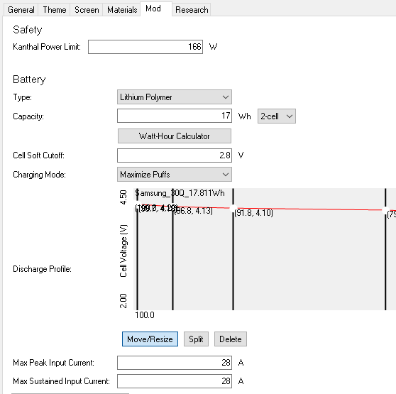

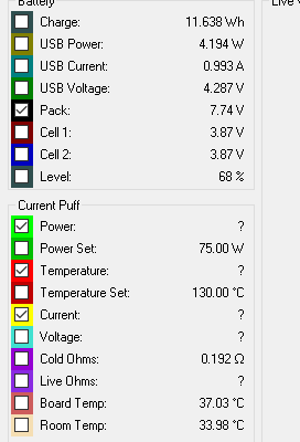

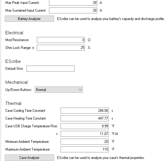

Hi All, Just bought a Paranormal 166 (my Therion 166 just died battery terminal fell to bits) But it's just not working at all properly in temp mode (all I use) so .. Got it out of the box, loaded the same titanium profile I use on the Therion, added the same batteries (Samsung 30Q's) and replicated the settings from the Therion (so effectively it should be almost exactly the same) - oh yeah using the exact same attys. But it just won't play ! ... it seemed to be pulsing ... really badly, 1 second on one off. Tried a few "Reset to default" and Re-applying the SP , it actually bricked last night after a reload, it would only show the Evolve 250 text then turn off, luckily I discovered that if I plugged it back into the PC, switched it on, it "booted up" so was able to do another SP reload, which brought it back to life ! YAY. This morning I ran the Case Analyser so it now also has the correct settings in there, but it still will not vape correctly. here are some screen shots of most of the relevant info (I think) Here is what happens when trying to vape it. A couple of oddities are that A) the Paranormal is not reading the resistance of my tank\coil correctly, the cold resistance is always .14 (as read from my spare IPv4 and my tester) but the Paranormal is reading it at .19 to .20 B) the temp setting is way off, i'd normally be vaping the Therion at 240c, on the Paranormal I have to drop the temp down to 115 - 130c else it dry burns !! C) the "Temp Protect" message never appears on the screen. I've spoken to the shop I bought it from (via email) and got the standard sort of reply back "it's probably something you have set wrong" I tried to explain the above but the have not replied since ! Could there be something in the settings that is causing this ? .. I don't personally think so, i've checked\changed everything possible. Or is this more likely a faulty device ? Any help appreciated. Cheers Damian

Hi ChunkyButt200, I have an update : see on my other post regarding SS316 /topic/65876-topic/?do=findComment&comment=891802 But basically I have done a service pack re-flash, and now the mod is NOT showing "Check Battery" when firing it whilst in the Device Monitor !! Not entirely sure what is going on, but it seems to be working better ! Thanks for your help again. Cheers Damian PS I hope you enjoyed your pizza
Right ... been a busy bunny.. Built a dual coil build exactly the same as the Snapdragon but for the dual coil deck of my Merlin - 2.5id .50 7 wraps SS316L Switched to Merlin profile - no TC - kept saying "OFF" on screen. But I noticed that it wasn't displaying "Merl" where the profile name should be (on the mod) So switched to the Snapdragon profile, which is in effect exactly the same, and TC is working, and displaying "Snap" on screen. So seemed as if the Merlin profile was corrupt or something. So I saved all the profile settings and did a re-install of the service pack. Re-did the materials list, and added back my 3 atty profiles. And it all seemed to be working correctly ! First thing I noticed is that after having a puff, the mod is flashing up "Temperature Protected" never seen that before !! After vaping it for an hour or so, I decided to test it properly, so I removed the Merlin, switched the profile to the Goblin profile and gave it a go ... all working fine .. Removed the Goblin, switched profile back to the Merlin ... nope, back to "OFF" and not showing "Merl" on screen ! Pulled a battery, left it for a minute, re-inserted said battery, and then the profile name is displayed ? Vaped it, and immediately noticed that the vapour output was a lot more "powerful" at the same temp. To get it back to the same output, I had to reduce the temp down to 127c from 170c So apart from all of the other oddities, it seems that the TC is all over the place ! I don't mind too much having to re-adjust the temp, but I'm guessing this shouldn't be happening ? On a positive note, since doing the service pack re-flash, I no longer get the "Battery Check" message when connected to my PC and using the Device Monitor" ! So there must have been something a bit fubar with the factory firmware ? Anyway .. I'm 80% happier now, and as I only swap atties twice a day (work\home) I can live with these little quirks. Thanks to all for your suggestions and help, I can't make my mind up if I need to raise this with Lost Vape or not ? what's your thoughts ? Many thanks Damian Update: Arrrgh !! left it alone for 20mins, went to vape it .. nothing coming out, had to put the temp up to 222c !! what the flock is going on with this SS I'm not getting this with titanium !
Gotcha !! .. and it fires every press !! no "Check Battery" error ! Strangely it does seem to charge on USB (not that I ever use it) I'm done for now ! going to bed ! Cheers Damian
Is that the "Max peak input current" & "Max sustained input current" ? it won't accept zero, goes to 1 only, this would still be a 1amp charge wouldn't it ? I don't see USB current mentioned anywhere. Cheers Damian
OK thanks agian guys, I've now done the case analyser and got some device specific settings in there. going to do a few different types of build tomorrow and raise the power up as suggested. won't do it now got blurry eye syndrome (may be cause by a bottle of wine !! ) Still getting the Check Battery msg at the mo, but will see what happens when i limit the charge rate and with different builds. Cheers all Damian
