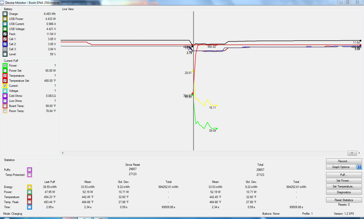

I use temp a lot on 200 and 250 your ohms are all over the place your build is .o6 and according to what you post I see readings from .1?? To over .2?? I use titanium myself have my point 09 build jumps over point one I won't even fire it waste of time I could be way off here but just what I see I might also suggest click on the yellow current see how many amps your throwing

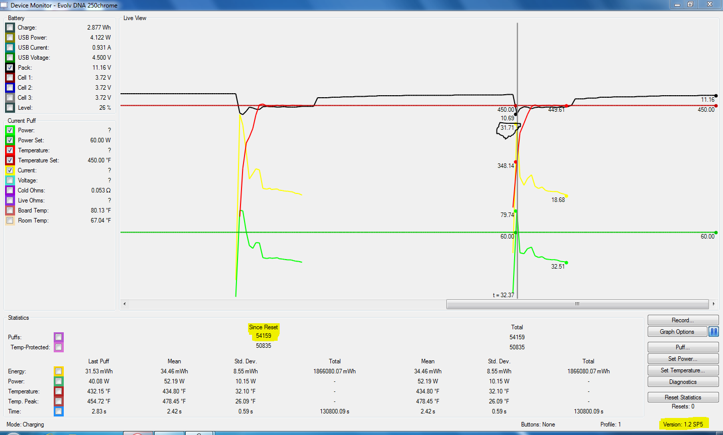

The one thing I will add make sure you save a file /backup to your pc from your mod before you start the board has a setup stored on it .for your mod .using device monitor on pc gives you a lot of info
It will not reset if you remove the batterys it will not reset if you take the board out and install in another device I am not sure I understand what you want the board to do I know in research mode you can set it up to shut down after so many puffs and it will not come back on till linked to pc and key used to unlock the board not too many things the board can not be set up to do
If you have not done so already Down load a copy of the software from evolv to your pc go to device montor hook the mod to your pc this can take a few minutes you will see something like this lower right hand corner you will see option to reset counter
You sure can but it will show it has been reset

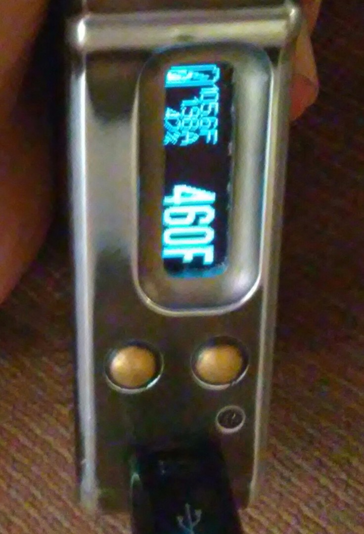

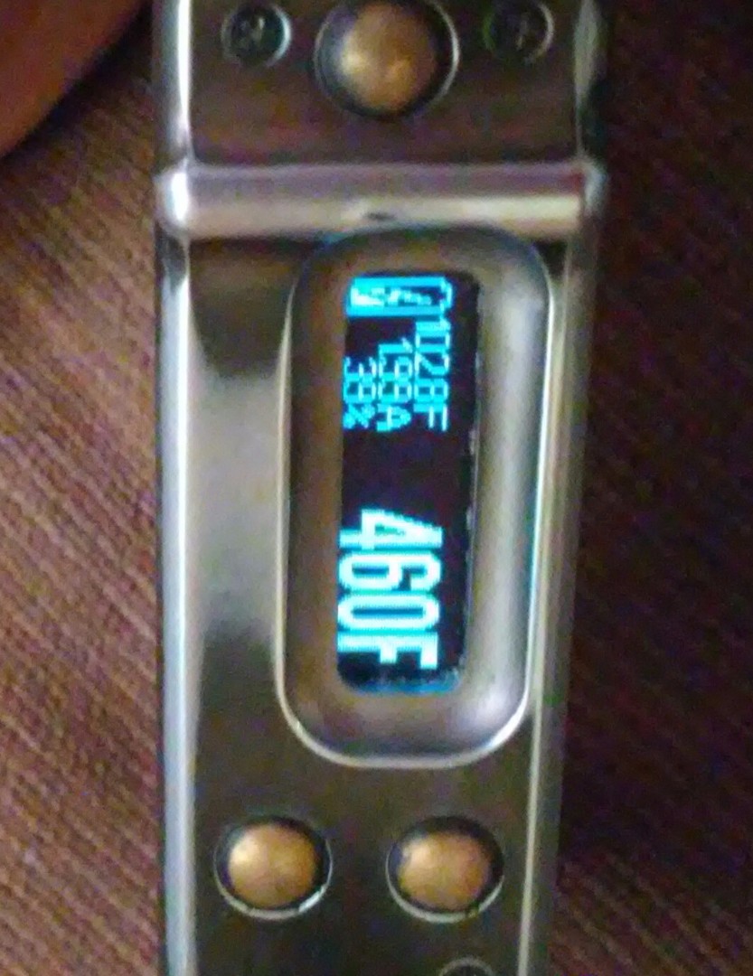

The one thing I want to mention on the DNA 250 if everything is set up properly you will notice and see 100/118 degrees Fahrenheit for temperature I pay more attention to that than anything else first give away something wrong is a board it's 90 degrees or 80 degrees when charging. just not my experience to see one run that cold when charging if they're right I could be wrong on this
the DNA 250 will charge from .75 amps to 1.3 amps linked to pc depending on the output of the PC and the cord you use the DNA 250 will charge the worst of seen as .75 /2 amps depending on the cord and the charger you are using go into your setup and have it show the amperage charging when charging it takes all the guesswork out of it trust me when I tell you I went through a lot of chargers and cords that would not perform on my DNA 250 even though a lot of them said Heavy Duty 2 amp charger they wouldn't even charge .75. Got to remember them Chinese have a bad habit of making it say something not true
