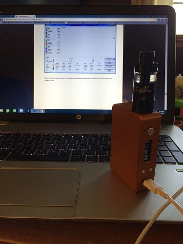

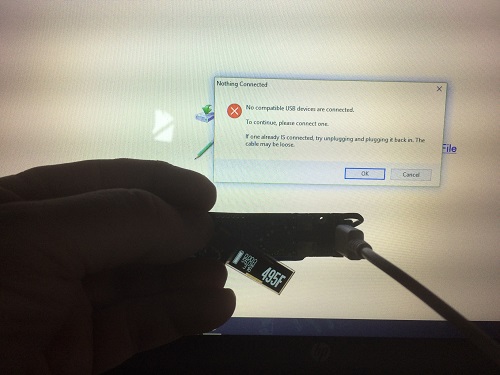

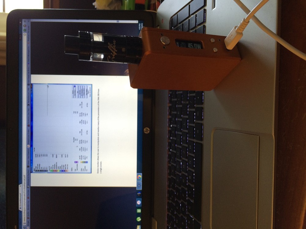

Ok I uninstalled and reinstalled EScribe drivers were checked and still does not recognize the 250 but does the 75? I'm stumped? Same as before! I have tried 4 different cables (all work and recognize my DNA 75). Used 2 different computers WIN 7 and 10 (all work and recognize my DNA 75). Hooked to a fullymax 900. Board will charge fully on USB! All functions work! just can't get it to work with ESribe! Any suggestions? Why would it recognize the 75 but not the 250?? Am I missing something?? -

Can anyone help? I had a 250 board that I accidentally shorted out. Filed a ticket sent it in it was is under warranty. Was sent back a brand new board. Thanks Evolv! Customer service is top notch by the way. Anyway I can't get ESribe to recognize the board. I have tried 4 different cables (all work and recognize my DNA 75). Used 2 different computers WIN 7 and 10 (all work and recognize my DNA 75). Used 2 different battery's (fullymax 900). Board will charge fully! All functions work! just can't get it to work with ESribe! Any suggestions? -

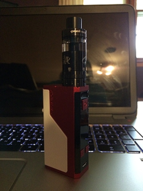

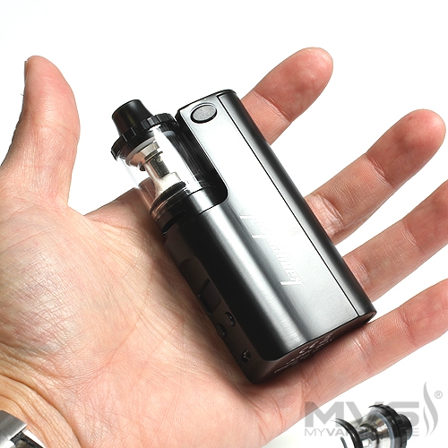

Here is what my BIG WISH IS!! I want Evolv or Mod Crate or Protovapor or any manufacturer! To make a mod in this design or a DIY case kit. Like the kanger juppi for a DNA 60 board with up to a 25mm tank mount and a 18650 battery. I like that the design goes out and not up with the tank. Makes for a more compact mod in my opinion that I can palm or it will all fit down in a shirt pocket with out a tank sticking up or out. Maybe put the up down buttons on the bottom like the TESLACIGS Stealth 40W with the same type design. Put the fire button just below the 510 above the screen instead of the top side like the Kanger Juppi. I love my DNA 200's and I'm spoiled because of the software and performance but man they are just to big and heavy to hall around and to be out and about just for a few hours going for a drink with friends or a BBQ at a friends house. Just my BIG wish!! LOL! I know I'm after the deadline but one can wish and dream a little! -

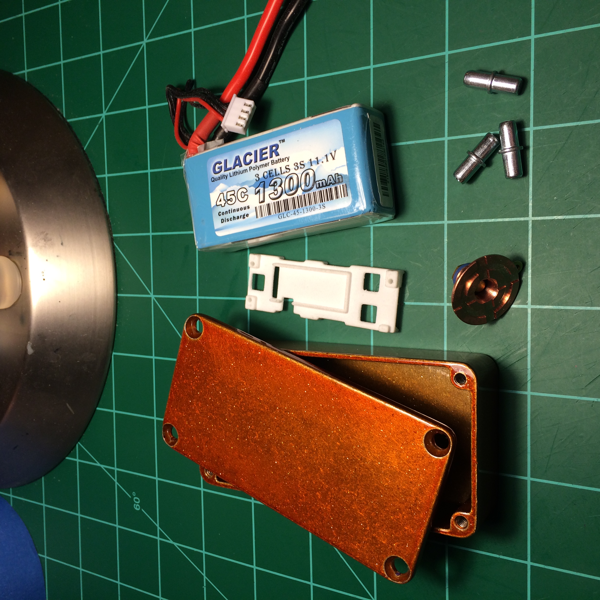

Glacier 1300 lipo It was a tight fit also and I had to screw the lid shut. http://www.buddyrc.com/glacier-45c-1300mah-3s-11-1v-lipo-battery.html

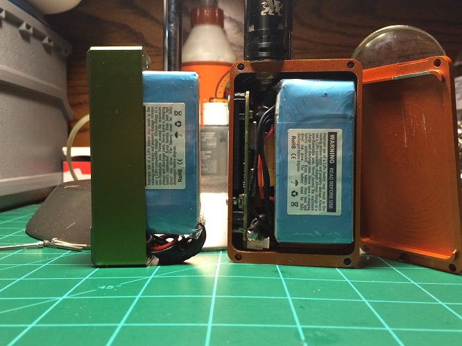

Width about the same maybe just a hair thicker. The 1550p+ shorter deeper, Silo taller thinner. I'm leaning to the Silo being my fav but less room to use the XT60 plug on the battery because the 1550 is a little deeper I could use the XT60 plug and run it between the DNA board and the battery. And I had to file a little off the lid lip on the 1550 to clear the 510 nut. I'm sure somebody could get the battery to fit in the Silo with the XT60 plug but I was tired of fiddling with it. LOL!

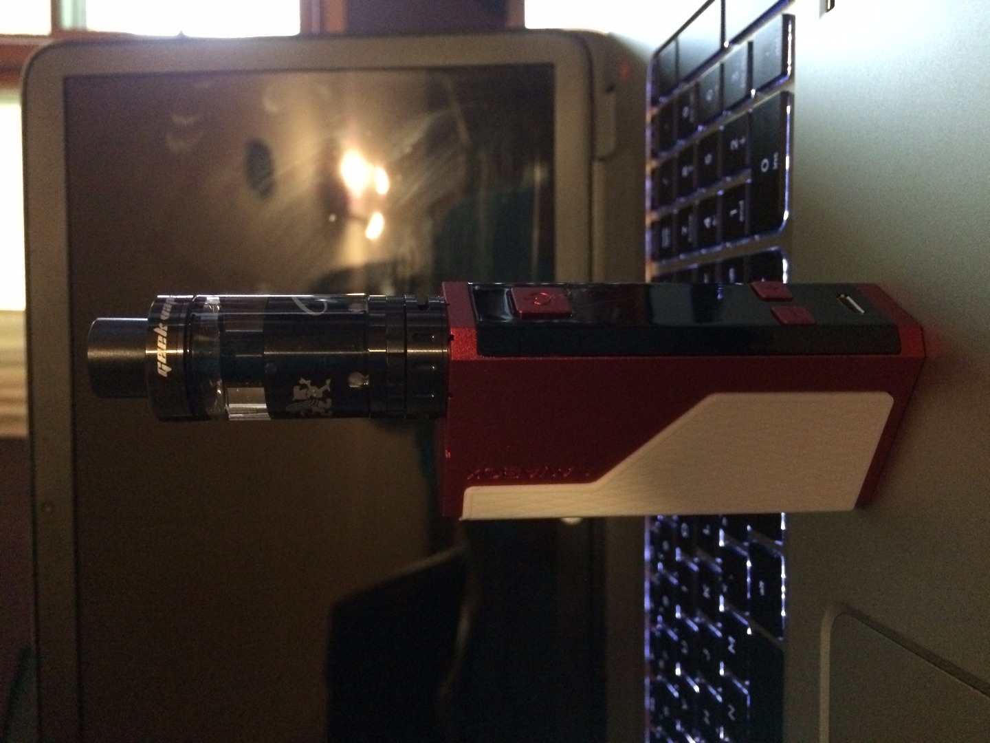

The Silo 1300 I had to hard wire it, not ideal but I couldn't find a way to mount and keep the connector it was a tight fit. I sized down the wire I don't know what gage it was but it was massive on the lipo so I mated 18g to the end to fit to the board not pretty but it is working. The orange 1550p+ everything fit fine with connectors but was tight I had to put screws in the lid to keep it closed. I used the same battery in both the Glacier 1300 specs 70x33x20 http://www.buddyrc.com/glacier-45c-1300mah-3s-11-1v-lipo-battery.html I will probably run this battery out in the Silo and find a more suitable size so I can go back to plug and play. I like that everything fit in the 1550p+ but I like the Silo 1300 because it's a little thinner so they both have +'s. Right now just trying to figure out why my battery's in both mods seem to lose charge while just setting? Still learning the DNA 200. I have only charged on computer and I think I read that even tho the mod reads 100% it really isn't because of the limitations of a computer charge. ? Trying to get use to the heft of them also and the no burnt/dry hits too. I came from a Kbox and CoolFire IV and Kanthal but I'm thinking I should have got on this wagon a long time ago!! LOL!

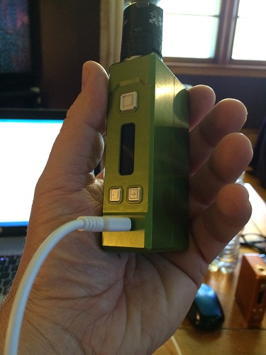

Just built my second DNA 200 in the last 2 days again with ModCrate parts. ModCrate green Silo 1300 box with ModCrate HCP 510, Glacier 1300 lipo. Hats off to ModCrate for there service, shipping and prices. This whole building a DNA box mod is addicting!

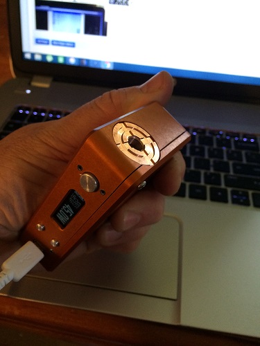

My very first DNA 200 and I love it! I'll never go back! Orange Modcrate 1550p v2 box (love this box) 45c 1300 Glacier lipo Fatdaddy's low profile copper 510 With a Zombie theme! Using a Griffin tank single coil .38 ohm SS 316L at 40-45w. Still playing with settings trying to find my sweet spot. I replaced the board screws with headless screws and had to put 2 screws in the lid because the lipo fit so tight mags would not hold it shut. Main welcome Welcome secondary

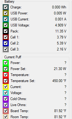

I believe it was my battery. I unhooked the balance charging plug and cell 1&3 read 0 but cell 2 was 1.7v with just the pos/neg leads attached. And when I unhooked the battery completely and only use the USB I could navigate some of the other screens that wouldn't come up before ie normal and stealth. Also when I would reheat the balance charger leads my cell 2&3 would swap volts ie cell2 would be 2.18 and cell 3 would be 5.2 then I would heat up my solder leads and make sure all was right and then cell 2 would be 5.3 and cell 3 would be 1.8 my volts for my cells would be all over the map. So I ordered a new battery actually 2. LOL! Thanks for the help! -

I know this may be a dead horse but I'm having issues with my battery. I have done a hard, soft reboot, I have done a USB recovery charge, I have soldered and re-soldered my connections. updated firmware 2/23/16. I'm using a modcrate 950 box with a protovaper 510. I'm very frustrated and ready to toss it out the window! I just got this board and have broke 1 screen already (ordered 2 boards). Software is set to 3 cell lipo. The charging screen never comes up just the running screen. As you can see below none of my cells are below 1v I'm stumped! Any help? Oh and I'm using a turnigy 950 lipo. -
I don't have calipers so it's unscientific but i came up with (in mm) A=73 B=34 C=20. The website http://www.buddyrc.com/glacier-45c-1300mah-3s-11-1v-lipo-battery.html list the size as A=70 B=33 C=20. I read somewhere on a RC forum that the Glacier battery's were very reliable. I googled it and found the site above and saw that it was one of the smallest 1300 so i thought i would give it a shot in a 1590g case.
Gathering parts and getting ready to build my 200! I got the fever!! Box 1590g http://www.mammothelectronics.com/default.asp Lipo http://www.buddyrc.com/glacier-45c-1300mah-3s-11-1v-lipo-battery.html 510 http://www.fatdaddyvapes.com/shop.html Chip sled https://www.shapeways.com/product/X2X2U9ZAK/dna200-mounting-plate?li=shop-results&optionId=57699387 Buttons http://www.amazon.com/gp/product/B003QSEERI?psc=1&redirect=true&ref_=oh_aui_detailpage_o05_s01 Now I just need to order my board and do some test fitting! I ordered a Turnigy 950 Lipo just in case the 1300 don't fit cuz it's tight!
