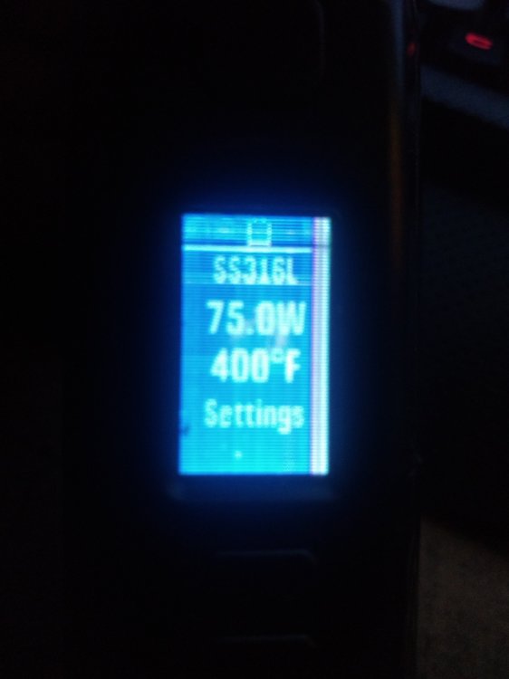

I did do the "screen fix" on the reuleaux 200 way back when but it took me quite a while and I had a lot of trouble with it. I can get the mod apart fine but its the flipping the little latch and keeping it down that is difficult for me and just getting in there in general. I may just order a screen or two from Proto while they still have them and give it a go however I do worry that that $ might be better saved to go towards a replacement if the screen is going to continue to need replacing regularly but I guess there really is no telling since every screen I've had in this has had pretty varied lifespans. Board replacement is completely beyond me and after buying soldering iron, etc I'd likely be better off just buying one of the many mods floating around in good condition that cost the same or less than a new chip when I can squirrel away the cash. And, to be fair, yes its three screens but that is over about 5 years and the one before this one, which did fail in just a few months, went for ~3 years with no problems. Most other mods don't last anywhere near that long so could just be nearing the end of its life. Sad but it does happen. Circle of life. Actually longevity is one of the main reasons, aside from only using TC, that I will only purchase Evolv chipped devices. I try to take good care of my stuff and do plenty of research so I usually get many years out of a device rather than only a couple months per device as I see a lot of vapers say is commonplace for the cheaper mods. And this is certainly beyond me. lol. I appreciate the info though. I guess screen replacement might indeed be a lost cause if this is needed to fix the problem. Blue stripes were the first sign of problems with this latest screen(though not the others) Here is an updated pic. Friday and then now. We've moved on from horizontal blues to vertical whites.
Yeah, I can see how you'd make that leap but it was just sitting on the desk overnight not plugged in or anything. I was not given a reason for why the screen failed AFAIK. I definitely did not on the one in January. I might have on the one years ago but can't find any thing relating to that on what info I have from that time. I should have asked and I'm kicking myself for not. I do know the person I talked to and who fixed it in January was @JacobEvolv coincidentally the same person who wrote the post you linked however I doubt they remember a random RMA from 6 months ago but, hey, maybe he will and will comment ITT. When I took the housing off in January I did look at/under the screen and did not see any juice anywhere nor any other part that was easily disassembled so I really don't think that is the issue. Could be a low quality screen I guess but since Evolv fixed it I'd assume low qual screen=bad batch or something rare but what are the chances of that happening multiple times? Dirty Zif connector could be the problem but I would think if that were the case it would have been cleaned when the last one was put in or that somehow this specific mod is the only one I'm getting the Zif dirty on which is odd especially with the different timing(1 year, 3 years, 7 months which is super quick) and it being around the house only no pockets no outside use you'd think it would be the least likely to get dirty UNLESS its some kind of design flaw in the Triade that makes this happen easily. (apologies for run on sentence) Also, its kind of odd they fail in different ways and not the same each time. I only use one screen pretty much since I can do everything I want from there. Screen timing is same but I do have dimmer on. I'm at about 75w usually on this mod but only TC so not using full 75w the whole time or even much of it. If it were a heat thing would it get worse even without heat? I guess you could say something might have triggered it while using it but I do know it wasn't like that when I set it down the night before, was when I woke up, and has progressively gotten worse without being used so I don't know if it were something to do with board temp its odd that it was so delayed. My house is not hot either. I keep it about 68. Also as I noted earlier I do use a heat sink to protect the threads which helps with heat a little bit and I do not dry burn coils. I just rebuild when it starts to go off. Sometimes my RDA will get warm which is pretty typical but nothing crazy. As for screen failing because of backside of screen touching chips I'm not sure but aside from the MFG initially the other 2 were installed by Evolv and I'm sure they know what they are doing. The guy who did the RMA in January literally wrote the guide on replacing Triade screens so I'm fairly confident he did it correctly. Its also not blacked out. 1st time in 2018 it did just work one day and then dead screen the next. The one in January was a bit of black that randomly spread over 2+ months time before it was unusable. The current issue started as a couple of thin horizontal blue lines(not black) and over the last ~48 hours they have multiplied exponentially. First noticed it at 2, then several hours later it was 4, several more hours and it was like 8 or so and now too many to count. So its not like blacking out per se more glitching I guess and this is all without it being used during that time aside from a single button press maybe a half dozen times in the last 2 days. Here is an updated pic. You can see the progression a bit now.

Exclusively having problems with a DNA250c LV Triade. Woke up yesterday to 2 horizontal blue lines towards the bottom of my screen. They weren't there the night before. No leakage or anything like that, no sign of juice anywhere. Didn't drop it or anything like that either. Left it on the desk by that night there were 3. This morning there were 4. Now there are 8 horizontal blue lines along the length of the screen. I haven't touched the mod in 2 days aside from a button tap last night, this morning, and this evening to see if it was worse. Other than that its just sat on my desk untouched not hooked up to PC. Batteries are all in good condition, good quality data cable, etc. I take good care of my mods. Aside from the screen and a little bit of wear on the bottom it still looks and functions like new. I even use heat sinks on all my non-bottomfed mods so the only threads getting used are the heat sinks threads. But still, screen issues. Got the mod new in 2017, had to get screen fixed late 2018 (whole screen died overnight IIRC) then January 2021 I had to send it back in because the screen slowly went black bit by bit over a couple months time until I couldn't see anything. Had a look and there was no juice or anything inside the mod, nothing on the screen, no cracks, etc but wasn't confident I could do a replacement myself so I sent it in, Evolv fixed it and its been fine until yesterday. So I got a year off the original, 3 years off the second screen, and 7 months off the third. Each time the function never changed. I could still use it and change settings blind or via escribe. Just a non-functioning screen. Each replacement was done by Evolv so obviously not shoddy work replacing them. Never had a single screen issue with any other Evolv chipped device. Again, no juice seepage, water damage, dropping, etc. Literally sat on a desk and popped up overnight. I'm just completely at a loss here as to why these screen issues keep happening and with this particular mod. Don't really want to file another ticket with Evolv since they never let me pay for anything but shipping and it seems like taking advantage at this point especially if screen issues are going to keep happening so I'm just hoping you guys might have some insight as to what in the world could be going on. I don't have any pictures of the first one. Just the pic I sent to evolv for the 1/21 RMA and the screen as it is right now(looks like we went up from 8 to 9 lines while I was typing this) Maybe they will be of some help. Would appreciate any insight you guys might have. Thanks.
