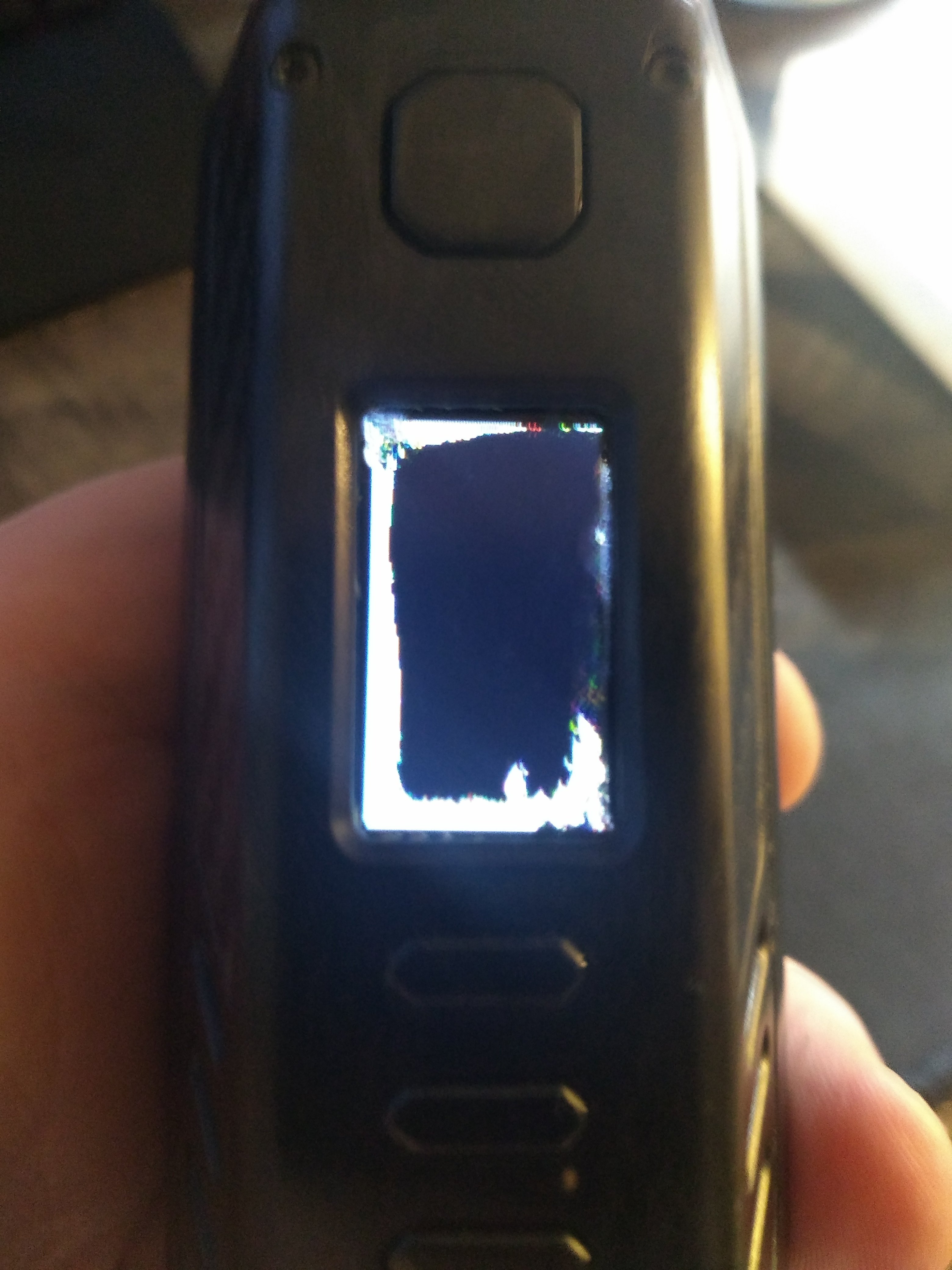

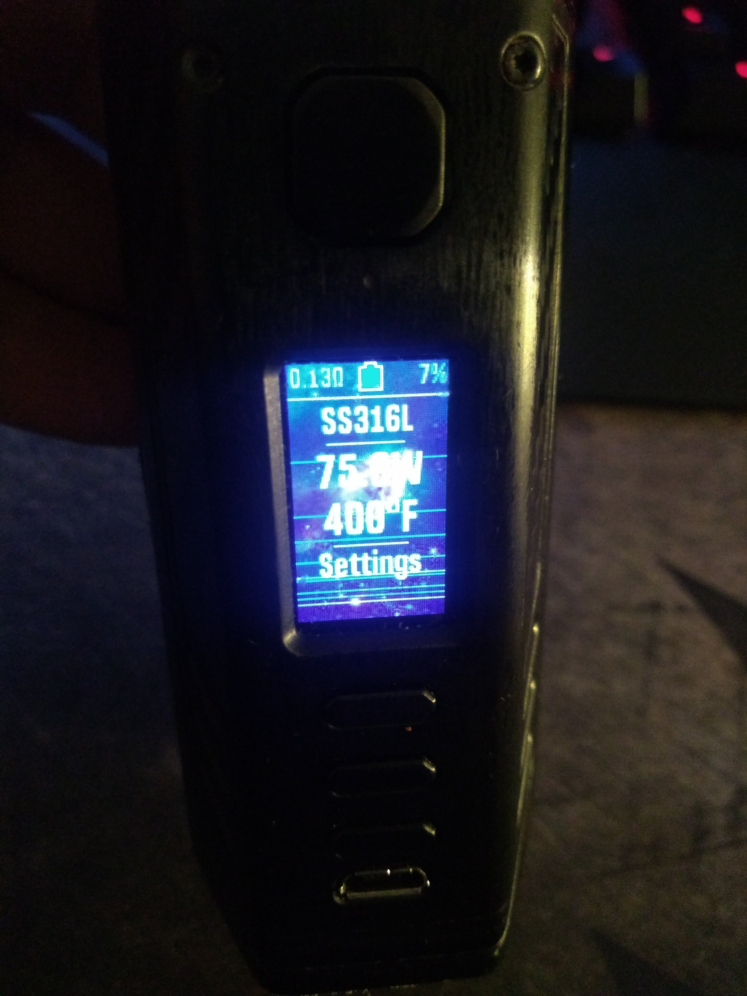

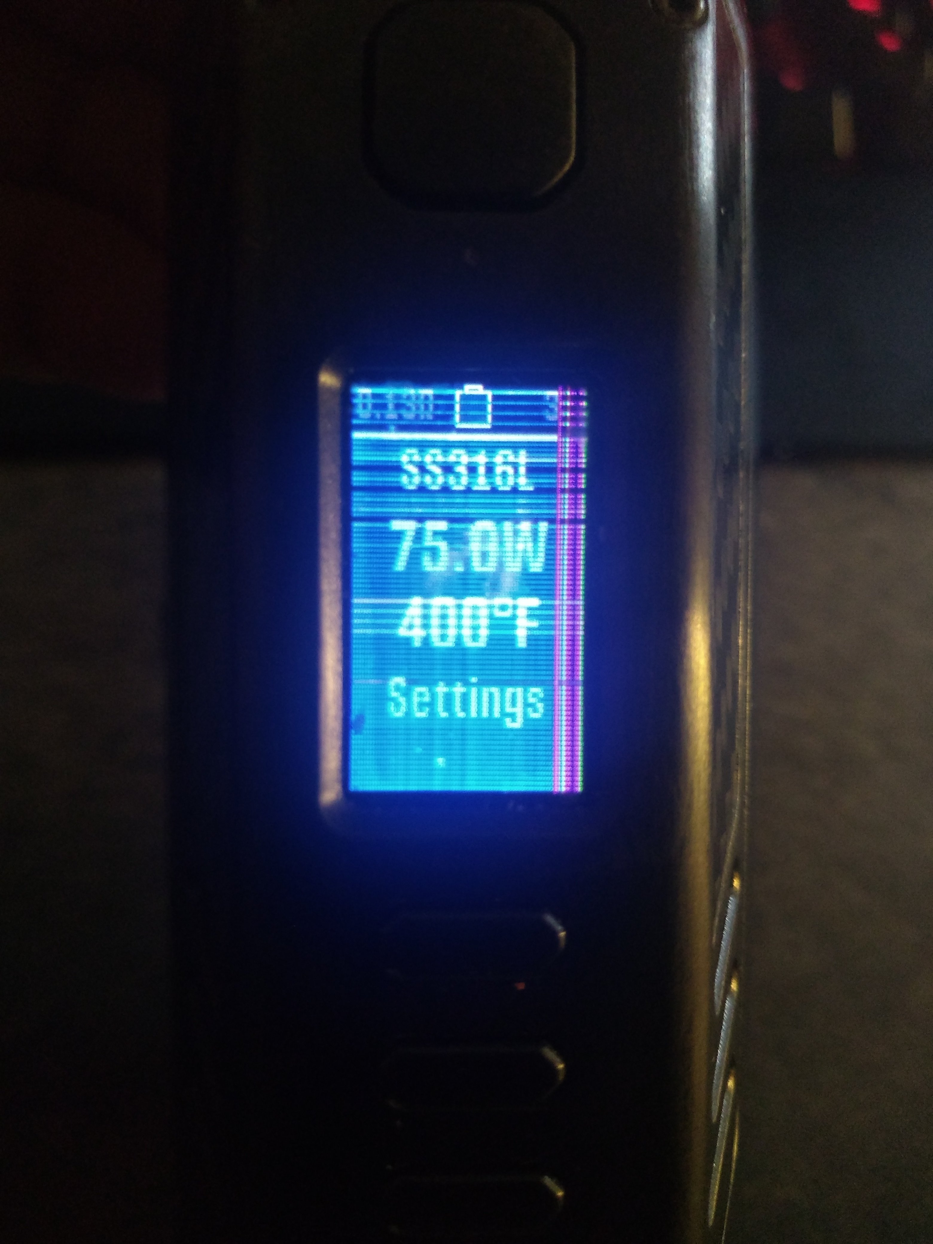

	Exclusively having problems with a DNA250c LV Triade. Woke up yesterday to 2 horizontal blue lines towards the bottom of my screen. They weren't there the night before. No leakage or anything like that, no sign of juice anywhere. Didn't drop it or anything like that either. Left it on the desk by that night there were 3. This morning there were 4. Now there are 8 horizontal blue lines along the length of the screen. I haven't touched the mod in 2 days aside from a button tap last night, this morning, and this evening to see if it was worse. Other than that its just sat on my desk untouched not hooked up to PC. Batteries are all in good condition, good quality data cable, etc. I take good care of my mods. Aside from the screen and a little bit of wear on the bottom it still looks and functions like new. I even use heat sinks on all my non-bottomfed mods so the only threads getting used are the heat sinks threads. But still, screen issues. Got the mod new in 2017, had to get screen fixed late 2018 (whole screen died overnight IIRC) then January 2021 I had to send it back in because the screen slowly went black bit by bit over a couple months time until I couldn't see anything. Had a look and there was no juice or anything inside the mod, nothing on the screen, no cracks, etc but wasn't confident I could do a replacement myself so I sent it in, Evolv fixed it and its been fine until yesterday. So I got a year off the original, 3 years off the second screen, and 7 months off the third. Each time the function never changed. I could still use it and change settings blind or via escribe. Just a non-functioning screen. Each replacement was done by Evolv so obviously not shoddy work replacing them. Never had a single screen issue with any other Evolv chipped device. Again, no juice seepage, water damage, dropping, etc. Literally sat on a desk and popped up overnight. I'm just completely at a loss here as to why these screen issues keep happening and with this particular mod. Don't really want to file another ticket with Evolv since they never let me pay for anything but shipping and it seems like taking advantage at this point especially if screen issues are going to keep happening so I'm just hoping you guys might have some insight as to what in the world could be going on. I don't have any pictures of the first one. Just the pic I sent to evolv for the 1/21 RMA and the screen as it is right now(looks like we went up from 8 to 9 lines while I was typing this) Maybe they will be of some help. Would appreciate any insight you guys might have. Thanks.
