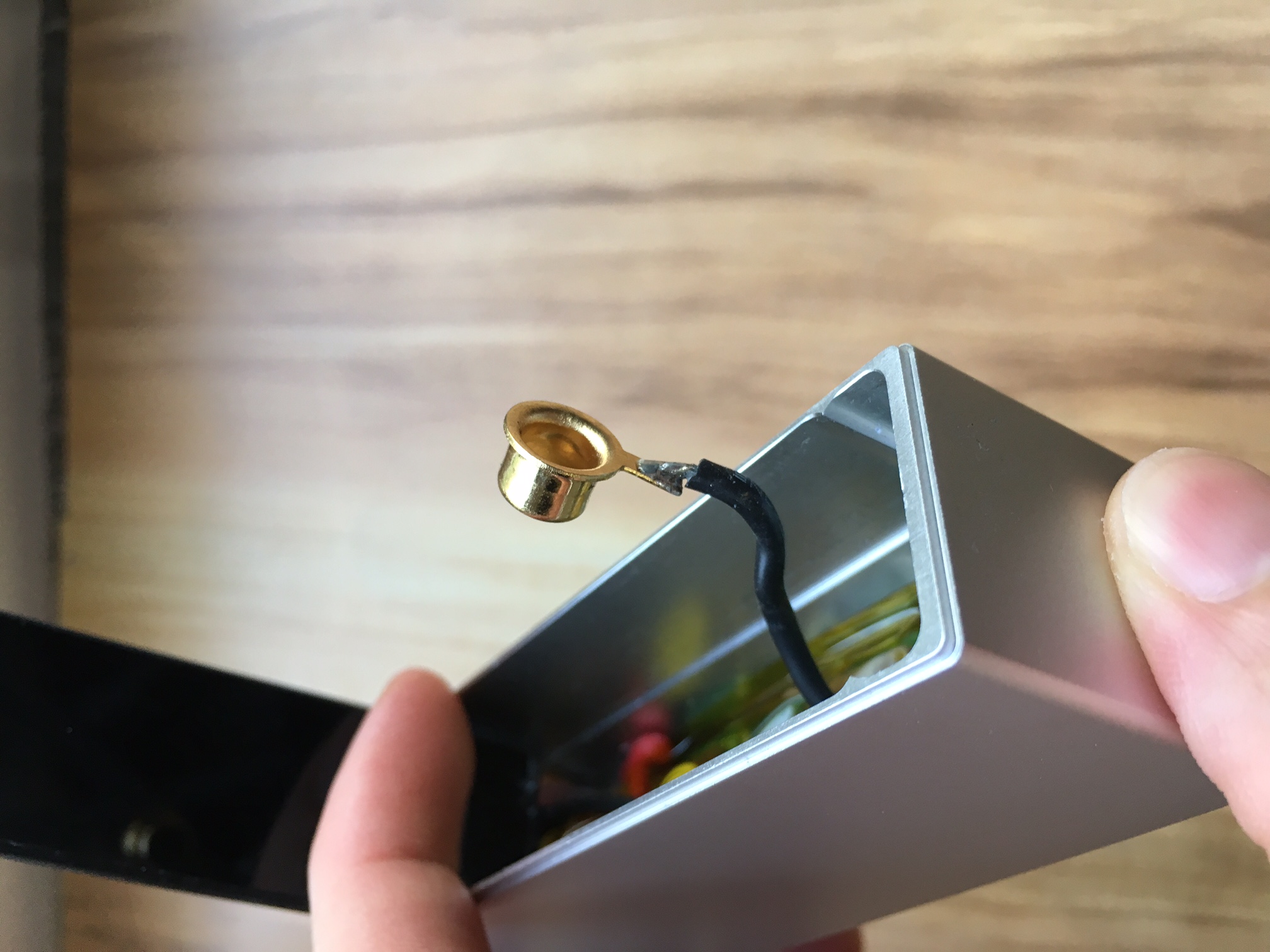

something is wrong with the mod/chip. i've now tested it with different attys and it's consistently reading the ohms at least .02 low (the one time it read the ohms as higher seemed to be a fluke). once i go into escribe and adjust to make the resistance .02 ohms higher then everything works much better. i took apart the mod to look at the connections. let me know what you guys think. it's kind hard to see the 510 connection cause of the tape.
