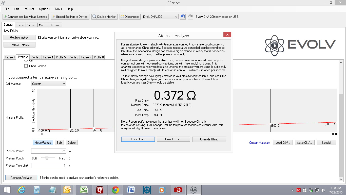

  3. The high resistance with firm attachment of the atomizer appears to be consistent for 4 different atomizers I've tried. Two subtank mini's, an origen dripper and a manta dripper. I'll explore more but I'm having the resistance jump around even in locked mode. I assume it may be a mechanical contact problem within the devices 510 connector.

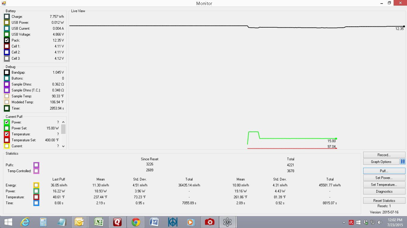

  4. John: I will go back to earlier firmware than 7/16 but when I've run with 7/9 or 7/16 I still get much higher ohms readings and always have the problem that temp is not showing up in Escribe most of the time. I'm not sure that I'm getting any temp limiting at all. I'll try a dry coil to be sure on that. In the meantime I'm wondering if I have a hardware problem. It's beginning to look like a hardware problem to me. Any other suggestions?
  5. John: As you suggested: I went back to 7/14 firmware and again no temp readout in Device Monitor no positive response from a hard boot but with a single try that is not unusual for this mod. Sometimes multiple hard boots are required to get the temp trace to show up and even then it's not permanent if the device sits idle for an hour or so. I then loaded 7/9 firmware and again no temp trace in Device Monitor before or after a single hard boot.

  7. John: The resistance reading is stable in the tightness range where I normally tighten an atty but if I crank it down really hard the resistance rises from ~0.37 ohms to the 0.47-.05 ohm range. The atty is a Kanger Subtank Mini that is stable on other devices and the ohm meter where it reads o.3 ohms. This is a Evolv Beta box sent by Brandon and the center pin moves when depressed by a bamboo skewer. l also cleaned both the atty 510 and the beta box 510 with alcohol and dried it prior to doing the Atomizer Analyzer eval. I checked in Device monitor at several points as I tightened and loosened the atomizer and there was never a temperature trace being shown. I did not try hard rebooting which is almost always required to get the Device Monitor to show the temperature trace.
  8. John. Forgot to mention this was the 0.3 ohm build and I can feel the connector center pin move when I depress it with a toothpick although of course it's tight as it should be.
  9. John: It's stable unless within the normal range that I tighten the attys but if you crank it down really hard the apparent resistance rises from the .37 range to .47-.5. I checked the Device Monitor at several points and there was never an indication of a temperature curve during a puff.
  10. John: As requested....Atomizer Analyzer shot of cold atomizer.
