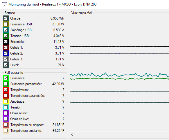

An update: i am now at 25% 25% with 6955Wh which mean 27820Wh.... this fluctuate a lot And after changing the power in Kanthal using Escribe, so i reloaded the parameter, i get this: A jump to 46% from before 25%...... really strange -

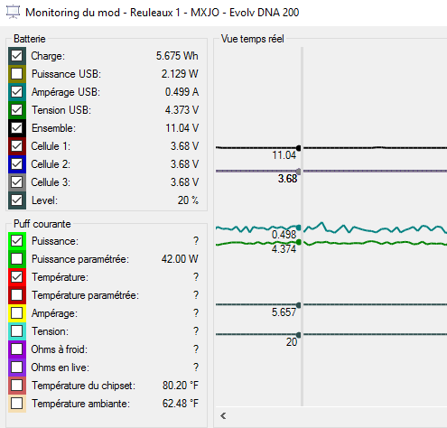

So if i follow your mind, now the level does not reflect the level of the battery reflecting his voltage but now the capacity. Ok, let's try, i am now at 20% 5675 Wh. So 100% = 5 x 5675 = 28375Wh, which seems correct. It is really strange that before the update, the level reflect exactly the reference of the battery csv. I have always used this to charge at 3.8V per cell my box for storage. I do this for my RC models as for my box . I must simply change my reference observing the charge for my different box, regarding what is the Wh at 3.8v -

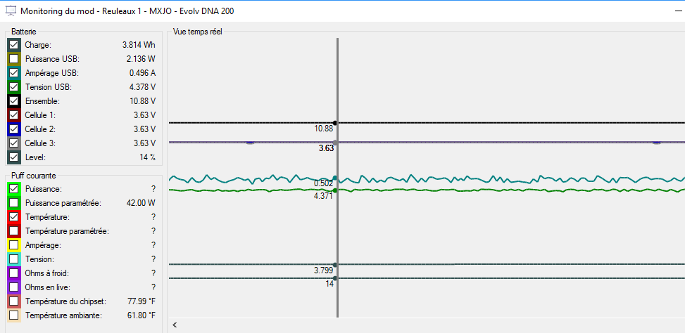

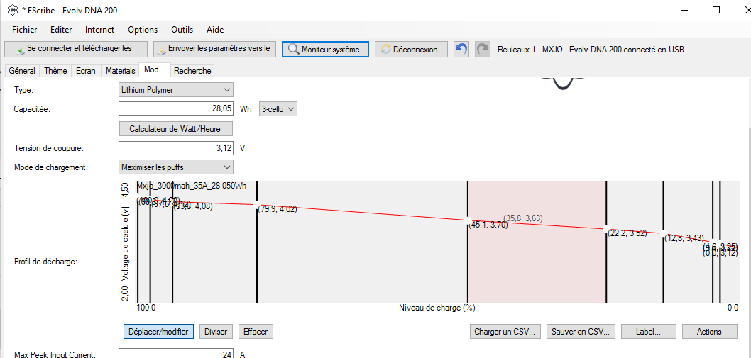

Ok, but it seems that we have another problem now. Voltage on the 3 cells is correct, but the level is very strange. When i check on my battery curve in the mod section, 3.63V is about 35.8% so why is it indicated 14% ? -
