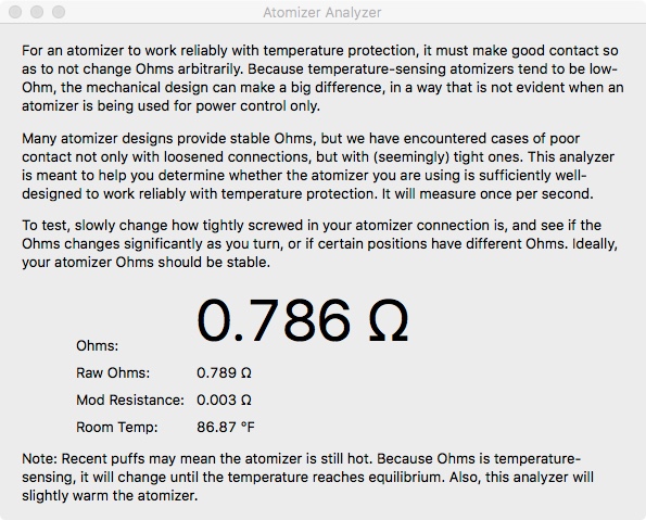

	Wow! I'm currently out and only have with me the ERM 75C with a SS316L, so I can't do too much testing, but I run atomizer analyzer just before and after applying this beta 12's FW and you can see the difference in the attached screenshots. By the way, since it is still called SP25, to be perfectly clear: the "BEFORE" picture refers to the SP25 that came yesterday with mac escribe beta 10, the "AFTER" picture refers to this latest SP25 that came with mac escribe beta 12: The first room temperature ~87F is almost exact, the second one appears higher probably due to the effect of FW update that you mentioned in your previous post (i.e. it resets to board temperature after an upgrade) Needless to say, this even seems too good to be true... ;-). I could even back-off temperature down to 380F maintaining smooth regulation. I can't currently do any further (e.g. cotton burn) testing as I'm out and about, but when I'll get home tomorrow I'll compare these readings with what I can get from my DNA200/75 and report back. BEFORE: (SP25 FW from mac beta 10) AFTER: (SP25 FW from mac beta 12)
	Thanks, James. I can confirm now Available Materials are correctly saved. After upgrading the two 75C, Therion and the ERM, with the SP25, I noticed cold ohms seem systematically read again a bit lower (tried atomizer analyzer right before and right after applying the service pack). On the therion I have an SS316L coil that was reading ~0.682 with SP24 and went to 0.662 right after applying SP25. On the ERM another SS316L coil went from 0.859 on SP24 to 0.843. The weird thing is that the vape doesn't seem to be affected too much, as far as the very few puffs I've taken since upgrading. So I think I need some more time to be sure of the vape quality, but I wanted to put this out as soon as possible to check if this could be an expected effect of SP25?
	Well, it may very well do. The internal resistance accounts for everything in the current path between the battery/board and the 510. It just takes sub-optimal soldering, a slightly thinner wire or some oxidization on a ground connection and your internal resistance will "know" it... Now for a mass-produced mod this big of a variation shouldn't happen, but I can confirm you that after setting mod resistance to 0 in Escribe and running atomizer analyzer with a copper plug screwed in, I get a pretty stable ~0.004 reading. I suggest you check it for yourself to be sure you don't have an "unlucky" one in your hands. If you don't have a copper plug, a dripper with solid 510 connection and a beefy copper wire dead-shorting the posts should do the job just fine

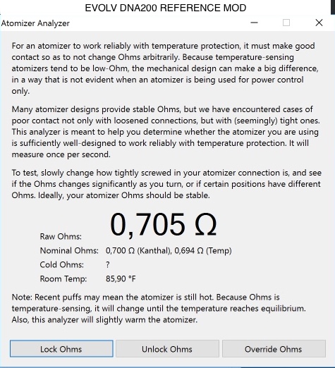

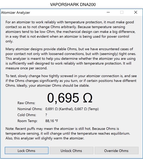

	Well, I'm pretty much confirming all of the above: 1) SP23 improved "precision" of cold ohm sampling. Note I used "precision" as what has improved is the stability (or repeatability) of the measure. If I take several samplings, I get much more consistent and similar values (barring the physiological slight increase due to the measurement slightly warming the coil) than before (where it was more jumping here and there across different back-to-back measurements) 2) SP23 doesn't seem to have improved "accuracy" of cold ohm sampling: I took the same atomizer (a TC-friendly one, with no springs, direct center-pin-to-post positive path) with a SS316L coil on the therion 75C, the vaporshark 200 and an EvolvReferenceMod 200 and you can see the output from AA here below. Keep in mind real room temperature is ~86F, so the ERM is the most accurate as far as room temperature goes. The headline is: the 75C still reads lower, _my_ therion seems to be ~ 0.024 below (instead of 0.04), but that's still enough to swing the temperature by ~60F with SS316L. Unfortunately at the moment I don't have my other 75C which is out for repair, so I couldn't put that to test as well. Oh, as a final note, manually correctly the cold ohm value on the 75C, brings the temperature value I have to use back to its normal 390/400F range, instead of the "tuned-by-taste" 475F value I need after a "real" cold ohm sampling. Here we go: EDIT: I'm sorry but I can't seem to find a way to avoid the attached screenshot being duplicated... I see each of them only once in preview, but then when I save the message they get duplicated...
