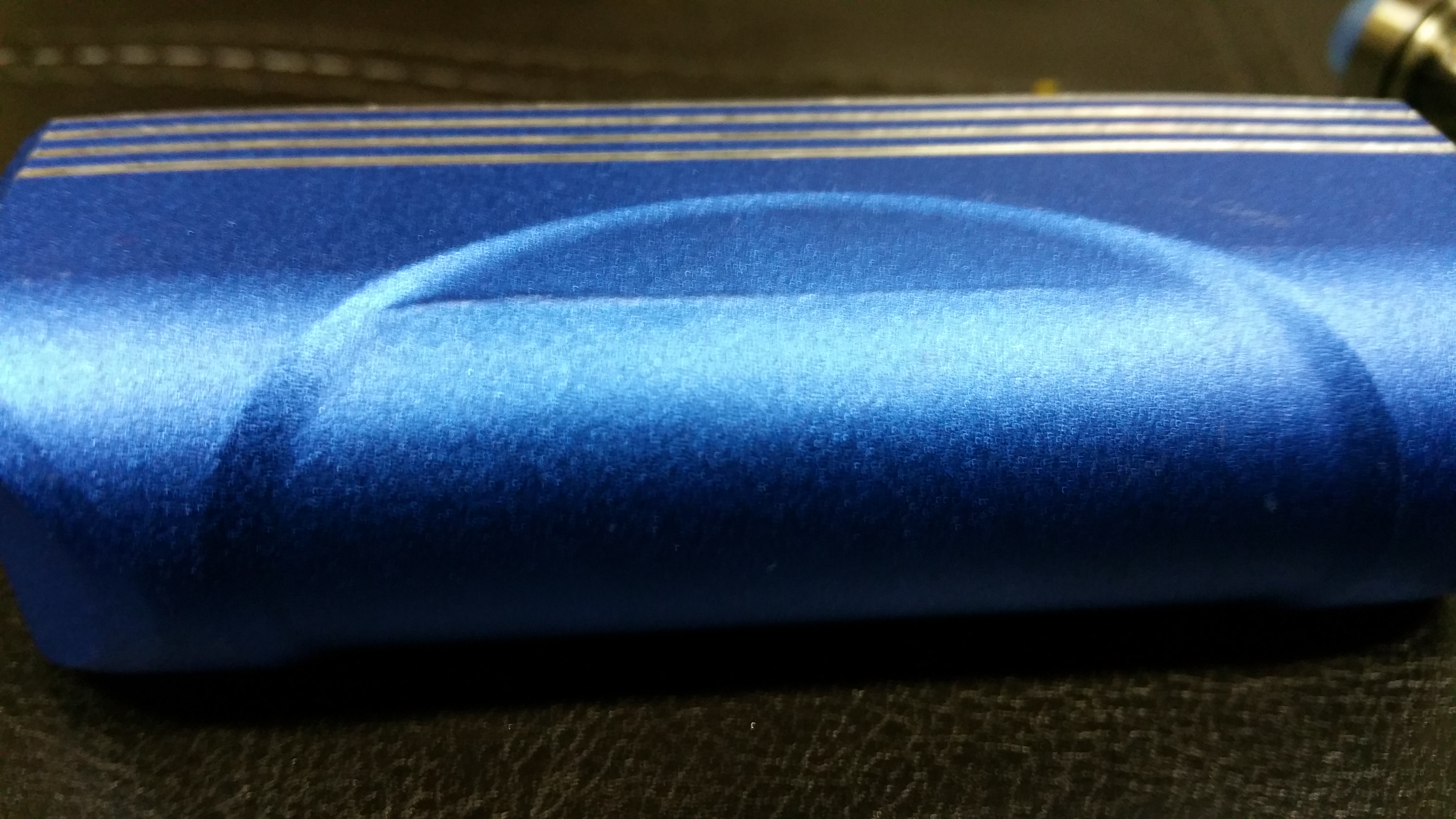

  5. So I have been using this for a while now and it is a nice improvement in battery life.I get a day using my griffin at 45 watts in tcbut I don't get a day with my dipper using alien clapton at 55 watts. My test came out to a 14.09 and is alot more accurate it goes down to 0 percent and I still get 10 to 20 more pulls on it. Is this worth doing? if you don't already have the tools and don't have free time and a spare device to use I don't think so hahaha I would just say buy a new one. This took me over a week to do maybe 6 or 7 hours spread out. I did dremel to much on one side it became to hot and warped my metal good thing I know how to paint and bondo. I am way more impressed with this mod now it is 1 of a kind and my rubber case still fits on it nice. Wish I took the chip out and painted the whole thing but didn't have the tools for that. Thanks to everyone on this fourm for the help and I hope this helps someone else thinking about doing this. Tell me what you think guys thanks

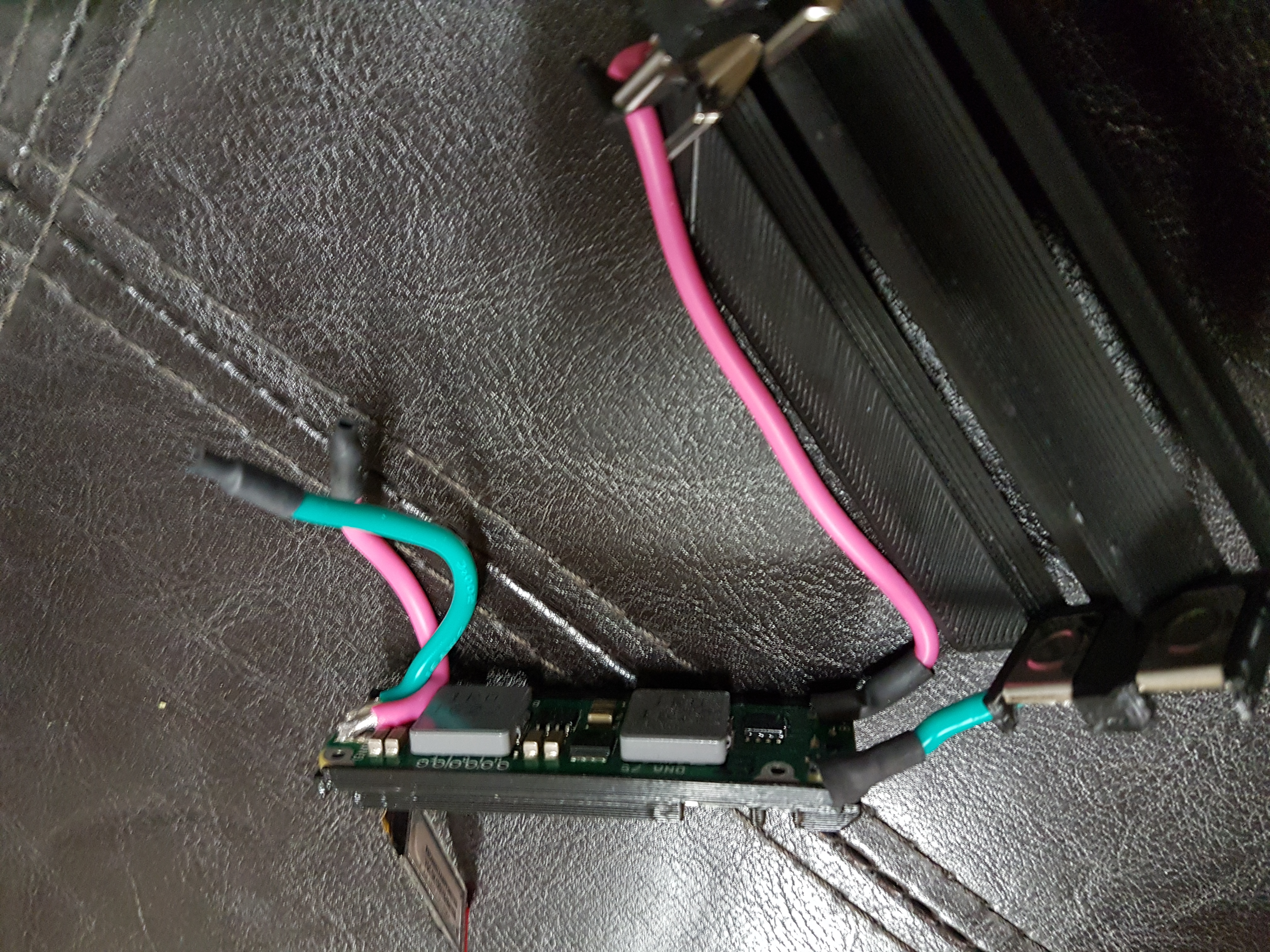

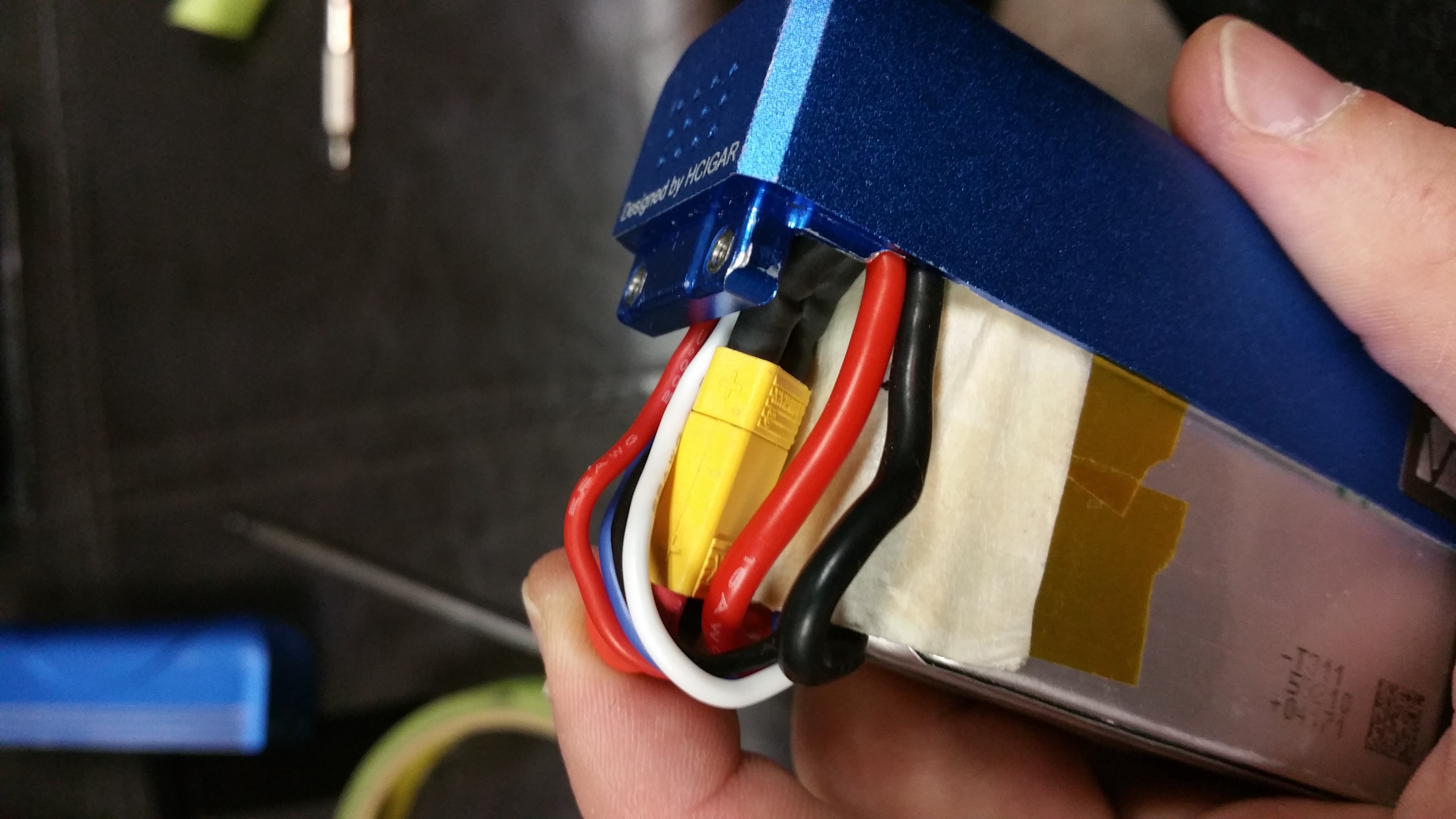

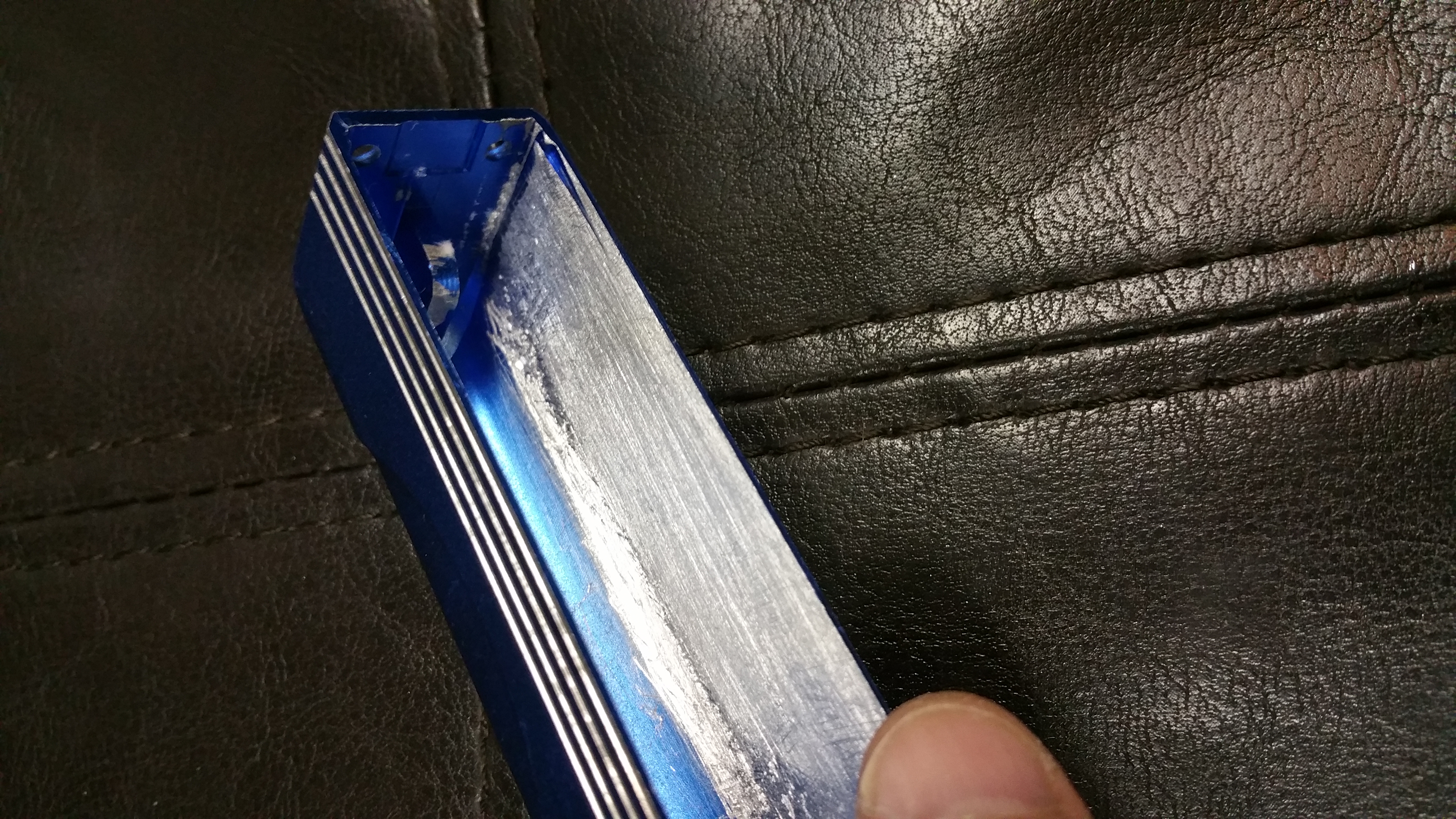

  9. Thanks for the help chunky butt . So I finished the fitting part it closes now with ease no squishing it together trying to close it. With this battery you do have to remove the peice that sepererates the battery from the chip and grind down the side to the point that's even with the chip. This battery is as big as you can go there is no room for anything larger then the turnigy 1300 25-50c. I have not connected the wires yet still need to figure out where I'm going to cut the power wires to make everything fit smoothly should be done tonight. I will connect it to escribe run all those long test again tonight and see if this was worth it. I will post the results when I'm all finished to let everyone know.
  10. So I used a cutting tool on the front it cuts way faster then a grinder bit. It doesn't look the greatest since I could not get in there the best with the chip still in it but I got the job done. Now I go to put it back together and it's about 2mm to big. What to do now did these guys really get this battery in there?

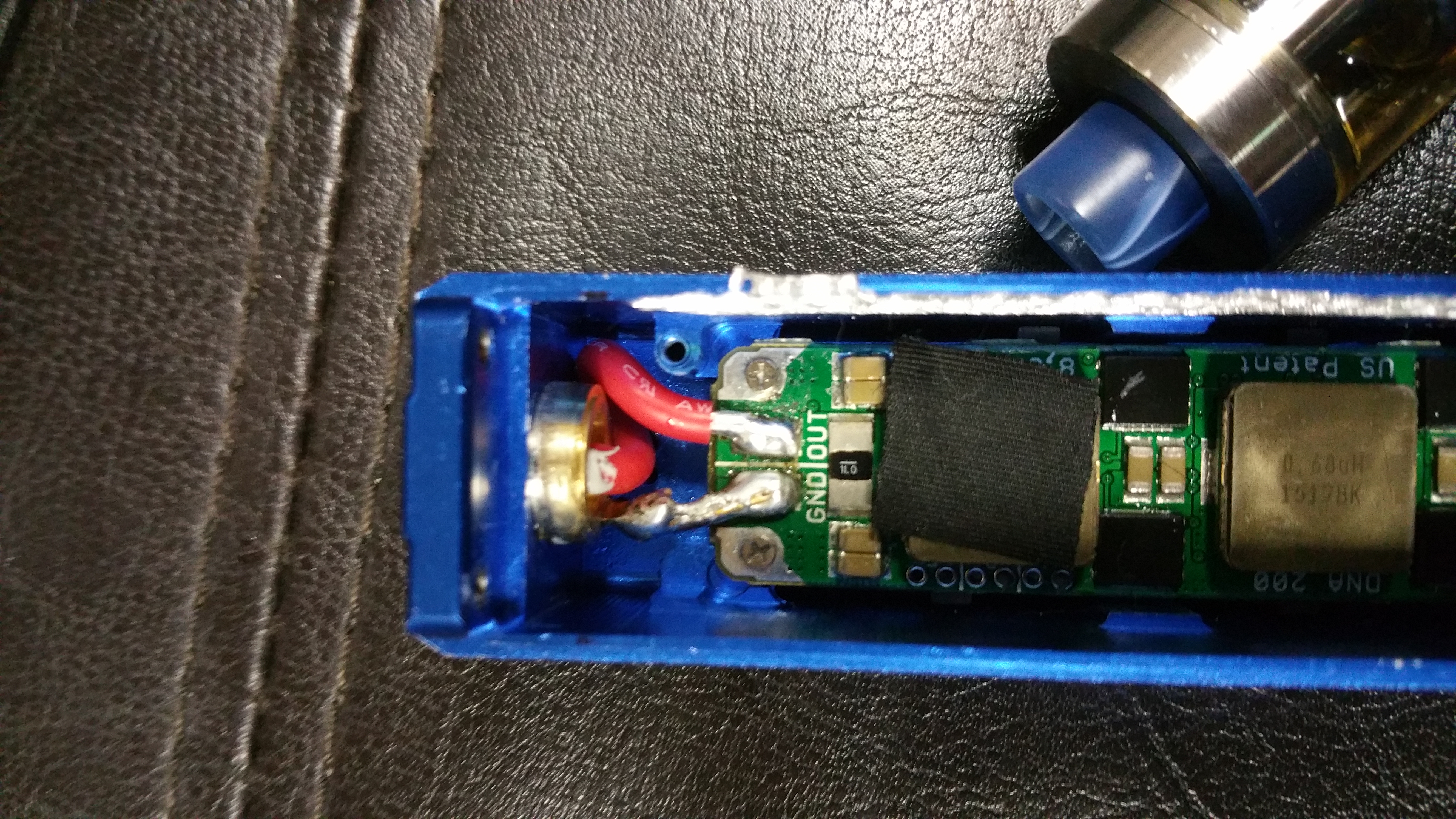

  11. So I'm stuck guys I need help taking the dna200 board out. I can't get in there enough to do this without taking the board out and it's leaving a big mess even when I try to tap everything off. So if anyone knows how to remove the board that would be a great help
  12. Hello I am wondering if anyone knows how to get the dna 200 chip out of the vt200? My solder gun doesn't seem to melt the solder at all does it have silver in it?
