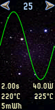

The theme is based on my previous topics. It works on DNA75C DNA250C, and in DNA75C does not operate "Power bank" mode.
The theme of VapingBad is the basis theme - here are many changed: icons and there are extra features .. I use his conversion for pre-heat - a very compact solution.
Copy from VapingBad
In the photos the 1st is when preheat is on, 2nd is preheat off, 3rd is dropped out of temp protection. 4th is TP-enabled=false, 5th is TS-Material=false.
This is how the conditions are set:
The TP icon:
default shows on image,
atty\temp-protect-enabled=false as the condition for showing the off image.
atty\temp-sensing-material=false also for showing the off image.
Text status:
default shows "PH" for preheat
atty\preheat-enabled=false shows "---"
atty\temp-protect-enabled=false shows "PWR" in yellow
atty\temp-sensing-material=false shows "PWR"in yellow
atty\temp-sensing-dectect=false shows "???" in orange (tested with an ss coil using a NI profile)
Temp Field:
atty\temp as default
atty\temp-protect-enabled=false shows diag\atty\voltage
atty\temp-sensing-material=false shows diag\atty\voltage
Extras:
In Lock Screen down: Current in charge or root temperature in non charging mode.
In Main Screen two resistans: locked ohms and life ohms.
In Main Screen right to Power: temperature of board or output voltage in VW mode.
In Main Screen right to Temperature: Temperature ot last puff
