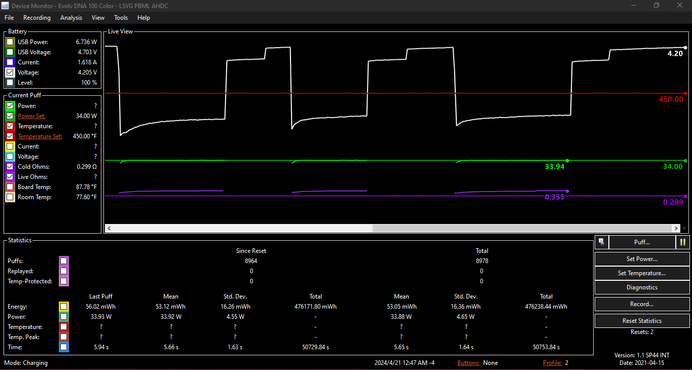

dwcraig1 Posted April 20, 2024 Report Posted April 20, 2024 For what ever reason the board isn't receiving enough power from the cell (amps) do to a bad connection, could be cell fitment, bad solder joint, ect Use EScribe's Device Monitor to see your voltage drop while firing. Here is one of mine that has a poor battery to board connection. The voltage drops to 3.37 volts when fired at 45 watts. If it drops to soft cell cutoff of 2.75 volts it will throttle down the wattage. Check yours with Device Monitor. 1

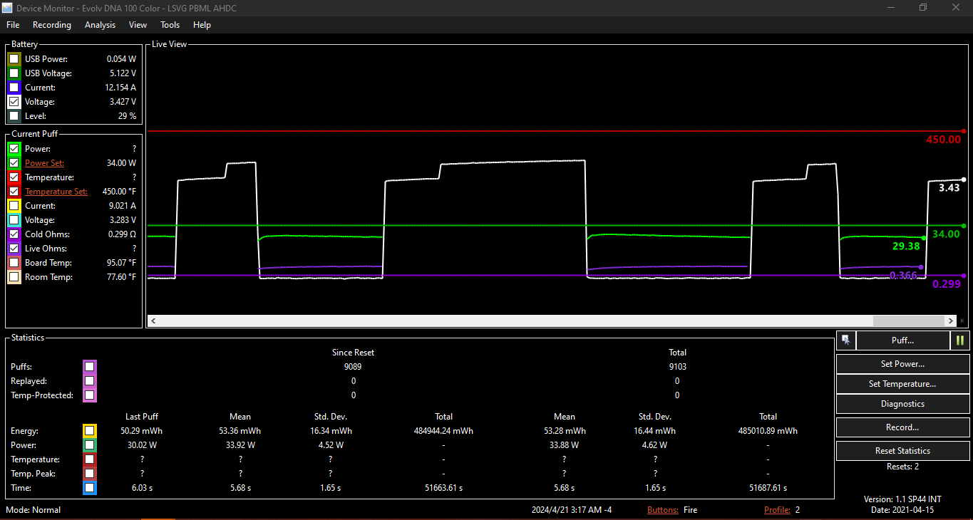

Gnostical Posted April 21, 2024 Author Report Posted April 21, 2024 (edited) Thanks for the help so far, after cleaning the contacts and re-adjusting the battery cap, it stayed until 25% battery before dropping off. Not perfect, like how I used to get it to 10% before dropping but still, good enough that I'm happy with how it is now. Here's it with the battery at full charge and here it is at 25% when it started saying batt down. I noticed it kept climbing in charge when not using it to the point of gaining almost 10% charge within minutes, then taking a couple puffs, it quickly drops back to what it should be. Not overly concerning but just something odd. It was having a lot of difficulty reading the battery charge correctly compared to before Edited April 21, 2024 by Gnostical 2

dwcraig1 Posted April 22, 2024 Report Posted April 22, 2024 Your last screen shot shows it throttling down from 34 watts to 29.38 watts. With the cell that you are using and firing at 34 watts that looks like there is still a problem. You seem to be on the right track to solving it. Is your adjustment screw on the battery cap at the end of it's adjustment? Meaning do you feel it may need to be holding to battery tighter?
