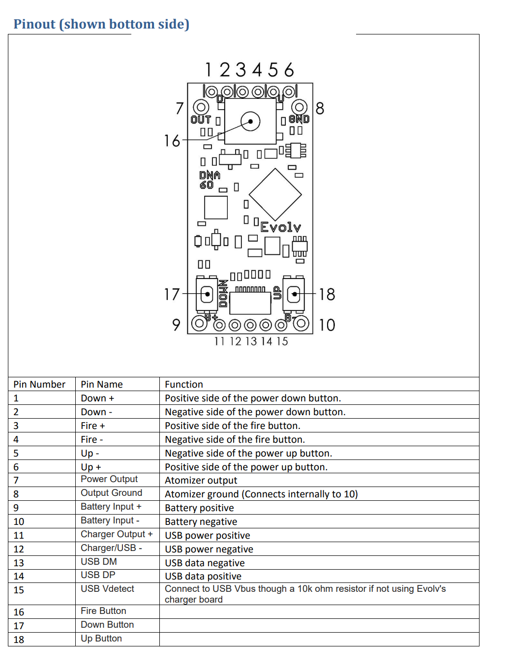

king aries Posted March 28, 2024 Report Share Posted March 28, 2024 Anyone knows how to tap these two burn fused planning repairing it. the fused is not damage i already tested all components it's just the board that burnt Link to comment Share on other sites More sharing options...
king aries Posted March 28, 2024 Author Report Share Posted March 28, 2024 (edited) damn can't find a diagram for dna60 Edited March 28, 2024 by king aries Link to comment Share on other sites More sharing options...
dwcraig1 Posted March 28, 2024 Report Share Posted March 28, 2024 The pinout is the only diagram that I have access to. 2 Link to comment Share on other sites More sharing options...
king aries Posted April 7, 2024 Author Report Share Posted April 7, 2024 thanks but still confused on how tapping the 2 capacitors Link to comment Share on other sites More sharing options...
