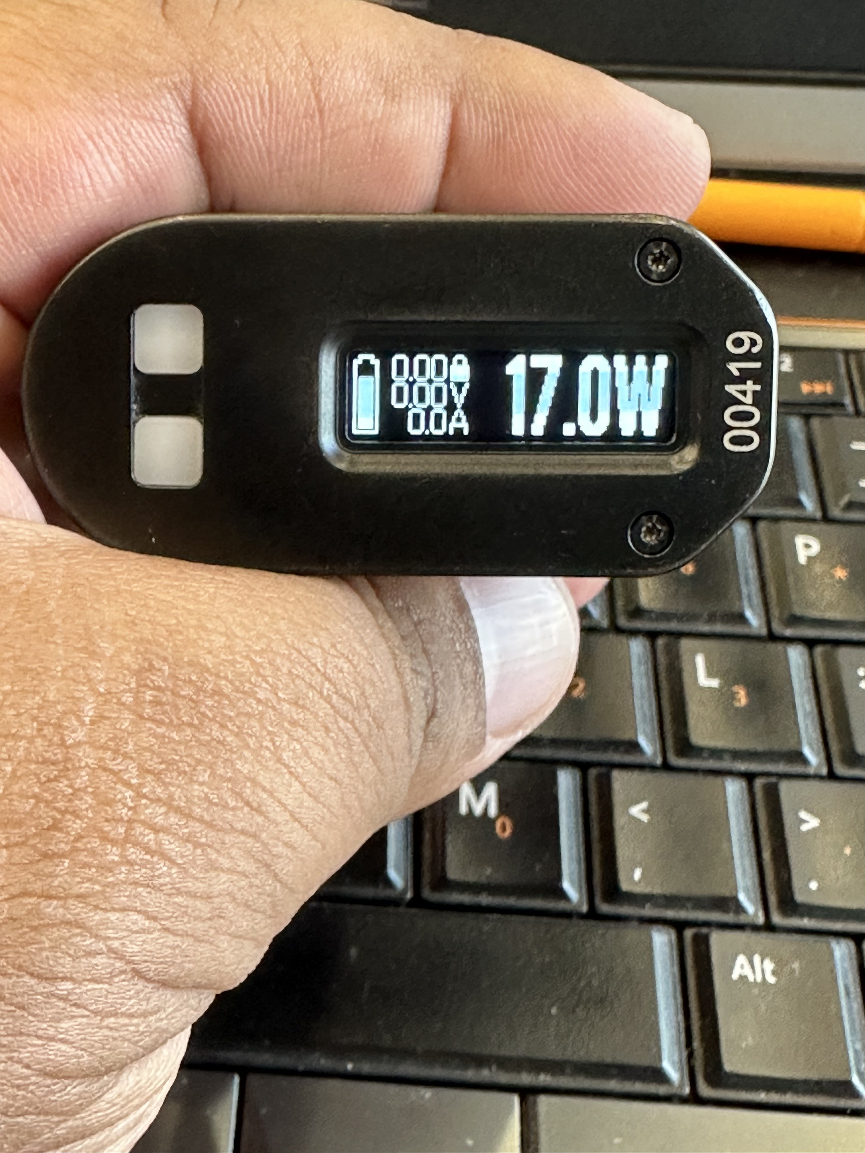

George santo Posted May 17, 2023 Report Posted May 17, 2023 Requesting your valuable support since my mod stopped working, I press any button but it does absolutely nothing, change the battery and it stays the same

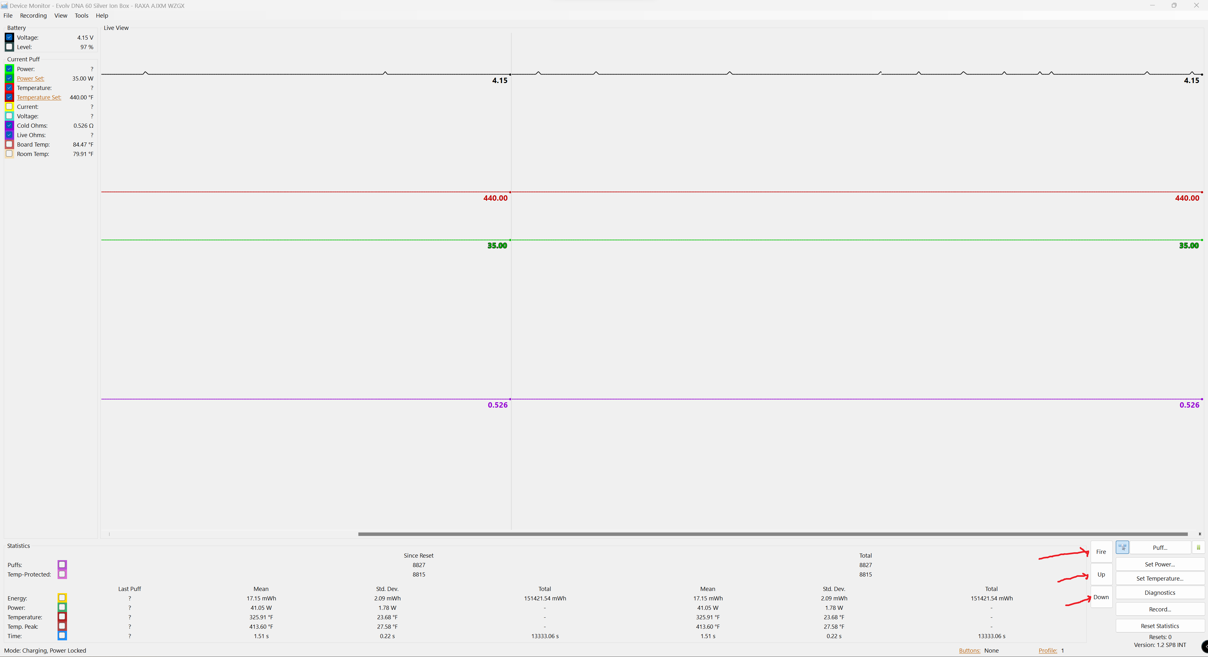

dwcraig1 Posted May 17, 2023 Report Posted May 17, 2023 Does it connect to EScribe? In the lower right hand corner of Device Monitor is the option to press the buttons through EScribe. Do they work there?
George santo Posted May 25, 2023 Author Report Posted May 25, 2023 En 16/5/2023 at 19:58 , dwcraig1 dijo: Does it connect to EScribe? In the lower right hand corner of Device Monitor is the option to press the buttons through EScribe. Do they work there? It works without problem through Escribe
dwcraig1 Posted May 25, 2023 Report Posted May 25, 2023 The fire button is not using the fire button on the board, it's a separate little board with a switch on it, there could be a problem with it or it's wiring. The up and down accuators most likely press against the up and down buttons on the board, I'm surprised they don't work.
