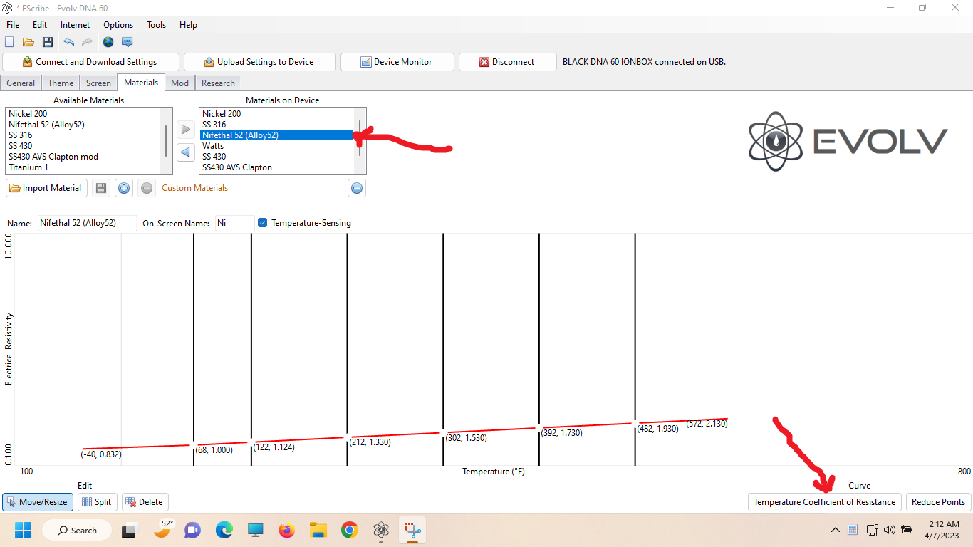

Gianluca Italia Posted April 7, 2023 Report Posted April 7, 2023 hello I don't know how to set the curve for ZIVIPF NiFe48 28ga 0.32mm the manufacturer's Tcr is 400 mi. Can you tell me how can I set it exactly? I've read a lot but no one explains it. Thank you
dwcraig1 Posted April 7, 2023 Report Posted April 7, 2023 The easiest way would be to import the included CSV file to EScribe, add it to the mod and make a profile with it. The value of this is 0.004036, (403.6) DNA200-Nifethal_52_(Alloy52)-SteamEngine.csv
dwcraig1 Posted April 7, 2023 Report Posted April 7, 2023 To do it manually the value is 0.004. Select the mateerial to chancge, press the Temperature Coeffiency of Resistance tab and enter 0.004, then OK
Gianluca Italia Posted April 7, 2023 Author Report Posted April 7, 2023 Thanks for the reply . I know the file you recommended but I think the TCR is 403.6 . I would like the correct one of 400. Thanks
