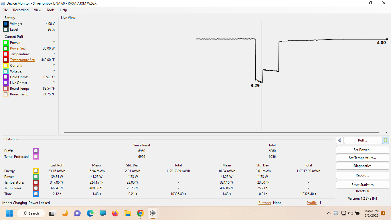

Bought a Lost Vape thelema 100c (first dna mod) and its barely hitting at all. I ive put all types of builds on it ranging from .14 ohms to .5 ohms. Hits the same no matter the wattage, boost level, etc. Took it and my laptop to my local vape shop (i have escribe) and we found out the even though i have nothing limiting it, my wattage is capping out around 47 watts for some reason. Any one know why this would be?

What is the voltage dropping to when firing? EScribe Device Monitor will show this. If your cell isn't powerful enough or the battery sled connections are poor and the voltage drops to 2.75 volts the wattage will throttle down.
Below mine dropped to 3.29 volts when firing.
