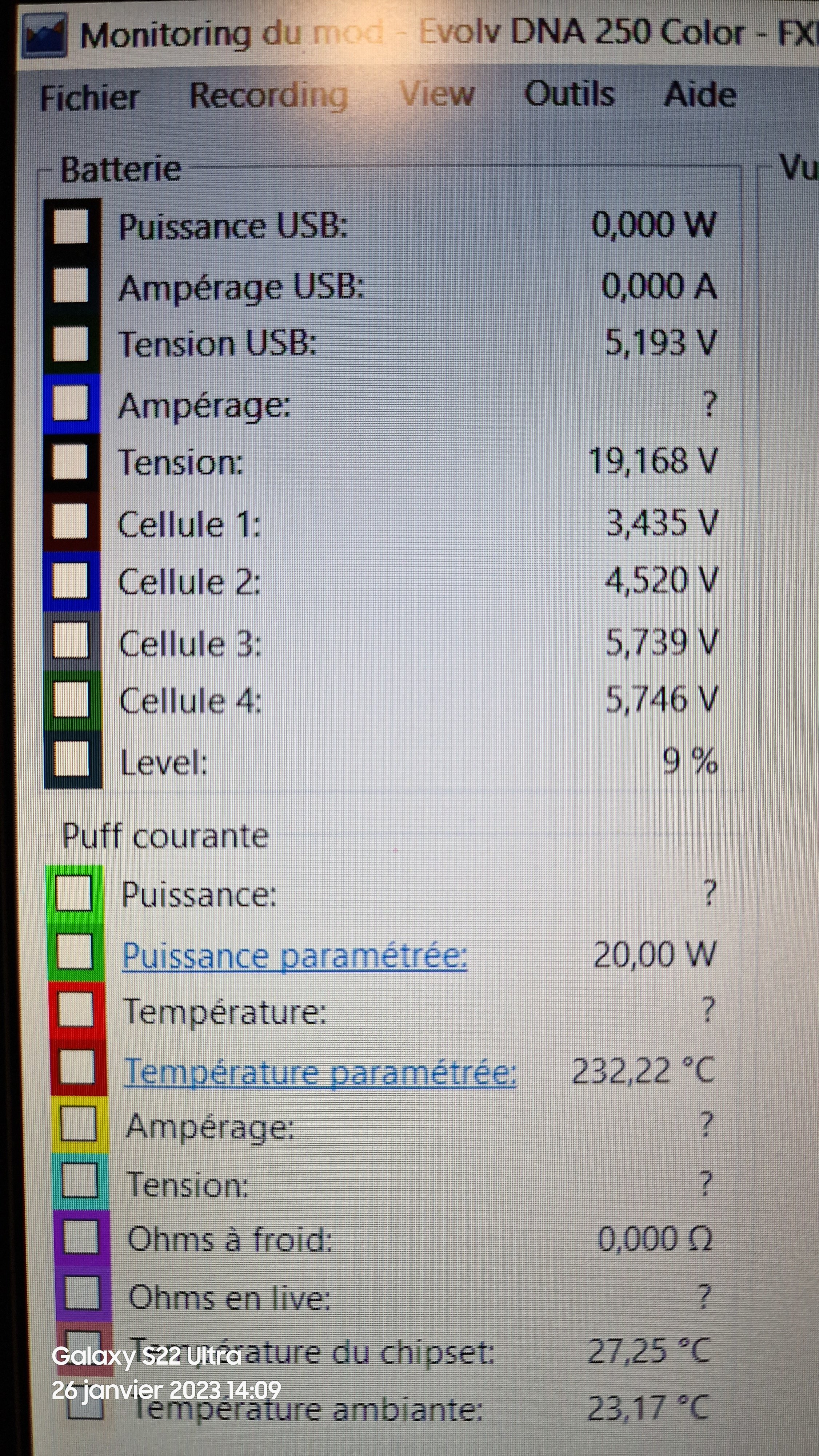

rvgauche Posted January 26, 2023 Report Posted January 26, 2023 Hello everyone, after using my hog dna400 without problems for a while, one morning by putting the batteries, impossible to make it work, I have the message "check battery", I did a reinitialization via escribe, but still the same problem. I changed battery without success. Thank you in advance for your help.
dwcraig1 Posted January 26, 2023 Report Posted January 26, 2023 Do you see cell 3 and 4 are way above 4.2 volts, this indicates as far as I know that that battery management chip is bad. If under a year old you may get some help from Stealth Vape UK or perhaps Evolv. https://helpdesk.evolvapor.com/index.php?a=add&category=1
rvgauche Posted January 26, 2023 Author Report Posted January 26, 2023 Unfortunately more than a year 😢
