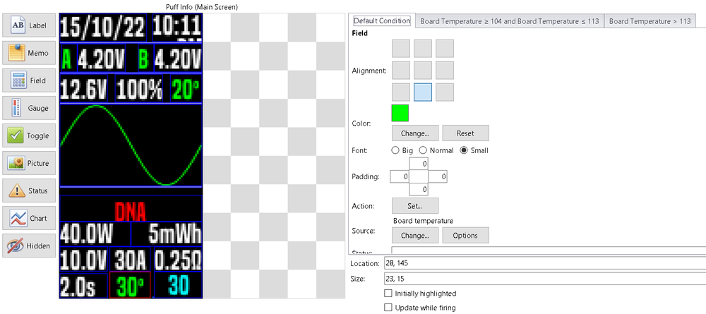

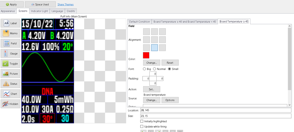

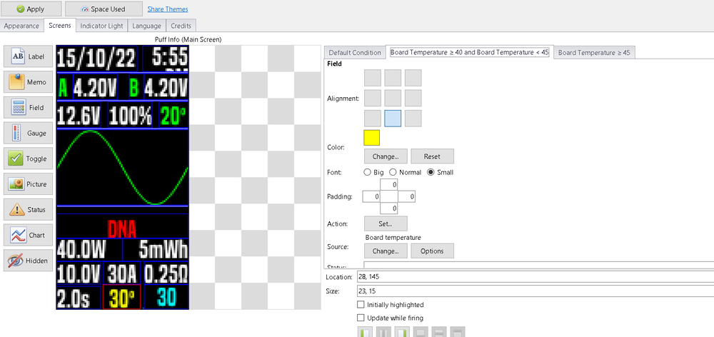

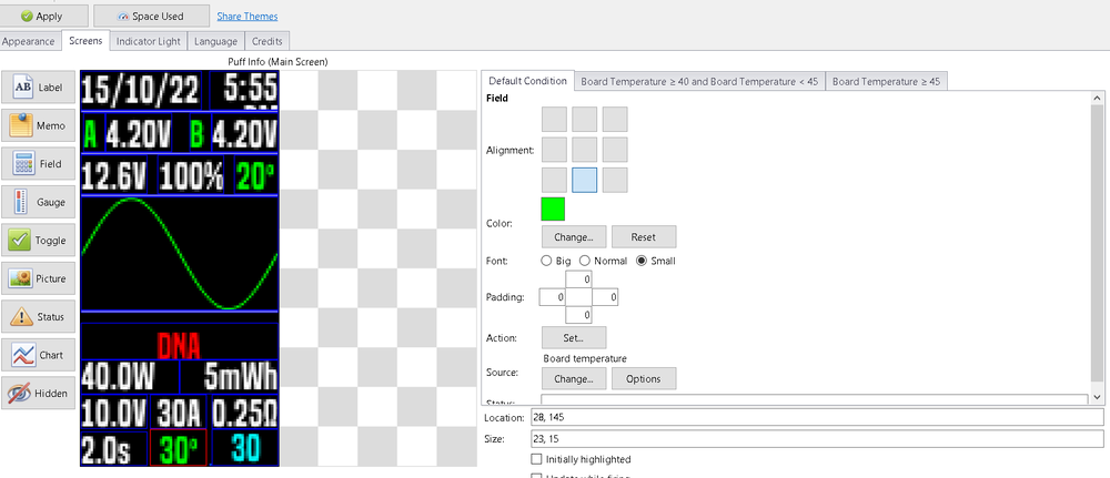

Droid Kung Posted October 14, 2022 Report Posted October 14, 2022 hello im having a difficult time creating conditions on my main screen, for the board temp and room temp, ive done in the past several time and never had a problem, but this time im having a bad time with this. what i want to do is so so simple that im even achamed of asking for help. so I want the board temp to show below 40 celcius GREEN above 40 and below 45 YELLow and finaly above 45 RED I know this is very simple to do but is not working for me, i dont know why, and ive tried several aproxes but im unable to find where Im failing, can any one one give me an hand on this ? thank you

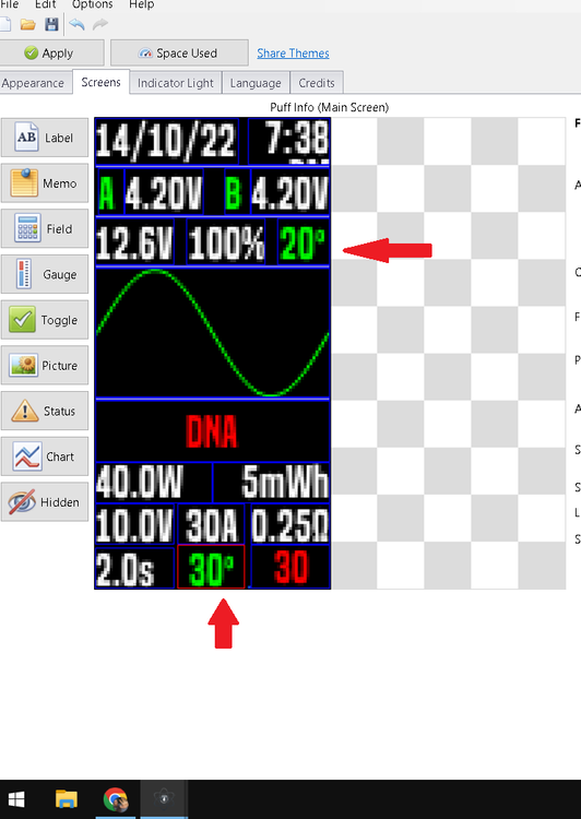

Droid Kung Posted October 15, 2022 Author Report Posted October 15, 2022 (edited) Back it didn't work, I have no explanation for this, I've tried many, many aproxes and never works I end up always with RED for all temps. Does anyone have any idea of what I'm doing wrong, this time I even performed hard reset, back to the default theme, and configs, and nothing. Edited October 15, 2022 by Fernando Patricio

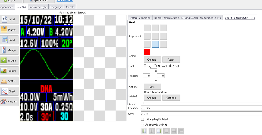

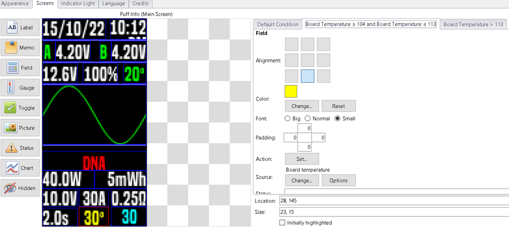

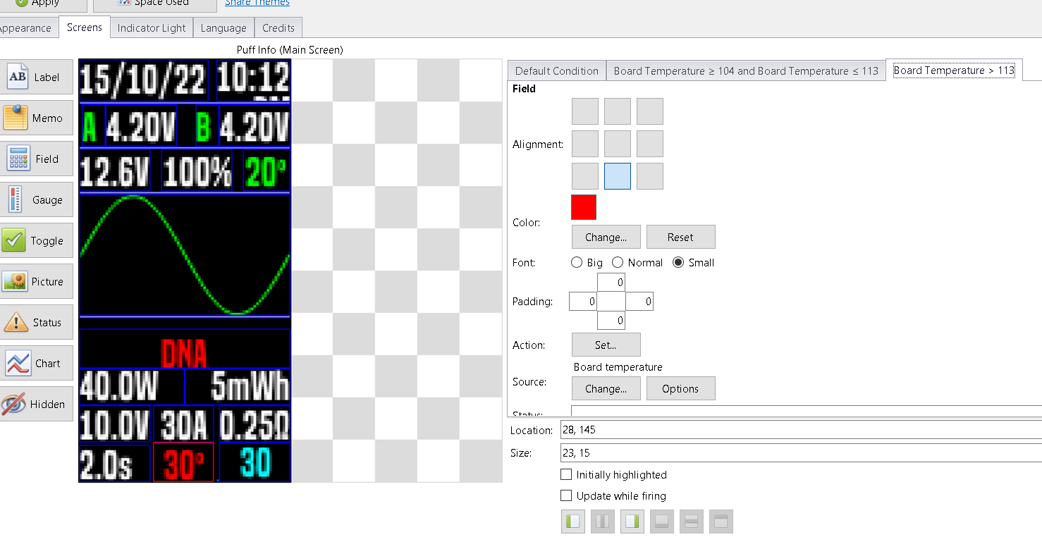

CMK Posted October 15, 2022 Report Posted October 15, 2022 Guess my mistake: enter the corresponding values in Fahrenheit... 104 / 113
Droid Kung Posted October 15, 2022 Author Report Posted October 15, 2022 (edited) Yes, I did it an hour ago, and now it's working, I tested before posting a reply. you have to do it in Fahrenheit, and then the interface will convert them to Celsius, mystery solved , thank you very much, I believe I finally have my theme finished, not a fancy theme, but it has everything in hand, unfortunately I can't do the fading active time config on the mod, but well, maybe in future. thank you CMK for your help Edited October 15, 2022 by Fernando Patricio
