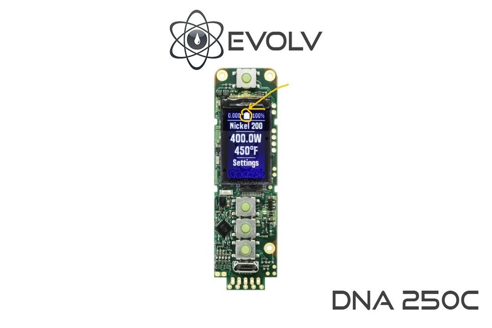

BlackFireDragon Posted June 23, 2022 Report Posted June 23, 2022 Is possible to change it ? On default battery icon change to red at 20%. I want to change the default value to 35 becose of lipo is better to keep above 30%.

BlackFireDragon Posted June 24, 2022 Author Report Posted June 24, 2022 (edited) On dna 250c the icon on the screen turn red when the battery is low default valur is 20%., I use dna board for short time so dont know a lot of things and on google dont find anything about this. I want to change the value from 20% to 35% so the icon on screen will show red icon low battery warrning. Is this possible on DNA board ? p.s theme is default evolv from the picture, p, Edited June 24, 2022 by BlackFireDragon
CMK Posted June 24, 2022 Report Posted June 24, 2022 (edited) okay - I still can't see why the battery icon behaves like this, but whatever. I changed it so that it now appears red at 35% and below. It is the default theme for the DNA color from the current ThemeDesigner. If your theme deviates from this, you can copy and paste the battery symbol into your theme StockTheme_with_red_battery_less_35.ecigtheme Edited June 24, 2022 by CMK aka gwyar 1
