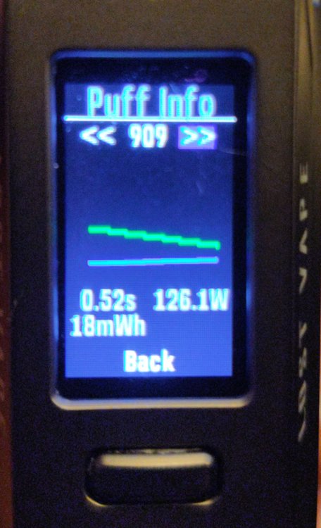

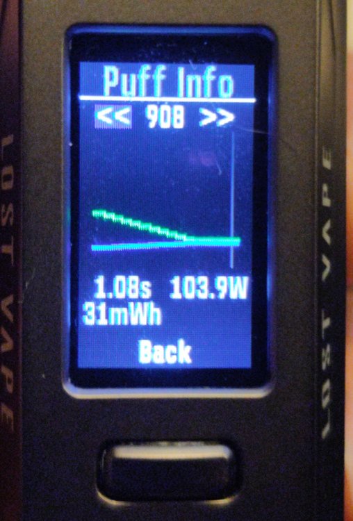

estebanxz Posted May 5, 2021 Report Posted May 5, 2021 (edited) Im currently trying to figure out with my vapes are so inconsistent, every-time I take a hit it's weak compared to the second one, the second hit and onward are always strong but the first hit is always weak i don't know why boost is behaving this way, i attached an example of this behavior using puff info you can see what i mean First image is the first hit which you can see in the curve is weird, second image is the second hit which behaves normally and feels good My settings are Profile: Watt Boost Power : 100w Boost: On Punch : 5 Edited May 5, 2021 by estebanxz weird formatting

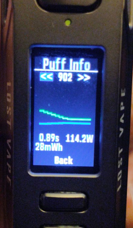

estebanxz Posted May 5, 2021 Author Report Posted May 5, 2021 (edited) it happens every time, basically to get consistent results I have to press fire twice every time I vape to avoid that "first weak hit" issue Im getting. another photo example First hit notice wattage, exact same settings second hit, notice wattage, exact same settings Edited May 5, 2021 by estebanxz
CMK Posted May 5, 2021 Report Posted May 5, 2021 In operation with the boost function, the set power is increased at the beginning so that the coil is heated up more quickly. Of course, this has an impact on the average power output. Your first puff takes a little longer each time, probably because your coil is still cold - towards the end you are approaching the set 100W. In the following puffs, your coil is already very hot, so your puff is very short. The mod remains in the boost and the average power is thus well above 100W. 2
