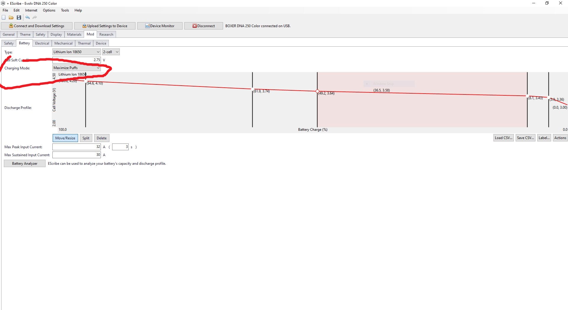

PinkFury Posted April 27, 2021 Report Posted April 27, 2021 Hello everyone on this forum. A few days ago I bought a new LostVape THELEMA device and two 18650 Sony VTC6 3100 mAh, 30 A batteries. I'm brand new on devices by lostvape and DNA boards. After purchase I changed my theme and puted my device to charging via USB cable and 1A charging adapter and left it overnight. On the morning I recognized that my device had been charged only to 85%. So the question is there any function to set up the charge limiter to device on EScribe or this is any problem with my mod/battaries. Thanks everyone😀
dwcraig1 Posted April 27, 2021 Report Posted April 27, 2021 What was the voltage of the cells when charging stopped? There is a setting to stop charging at either 4.1 volts or 4.2 volts. Maximum puffs is 4.2 volts.
