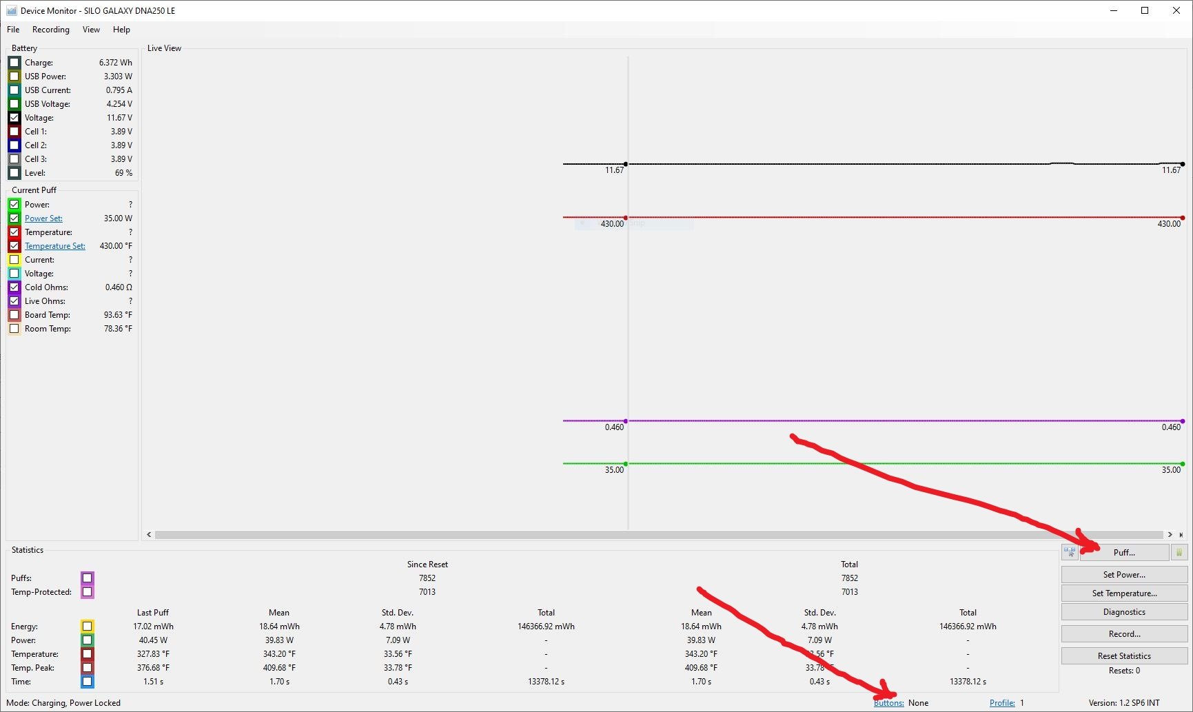

Mikes1978 Posted June 16, 2020 Report Posted June 16, 2020 So i recived my mod kit got it all built and popped a batt in 4s lipo.when i click the fire button 5 times nothing happens with the mod.i cant get it to even fire.the board is powered on though.i javent gad a dna device in years so am i missing something.thanks for any info to look at.
dwcraig1 Posted June 17, 2020 Report Posted June 17, 2020 Connect to Escribe /Device Monitor, down on the bottom towards the right side is "Buttons". With no buttons pressed it should say "none". Will it fire using "Puff"? 1
