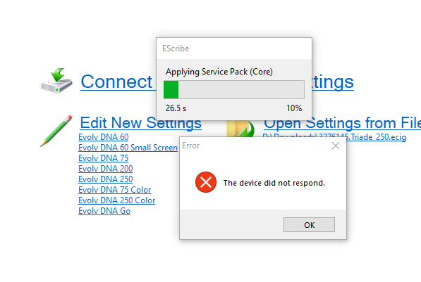

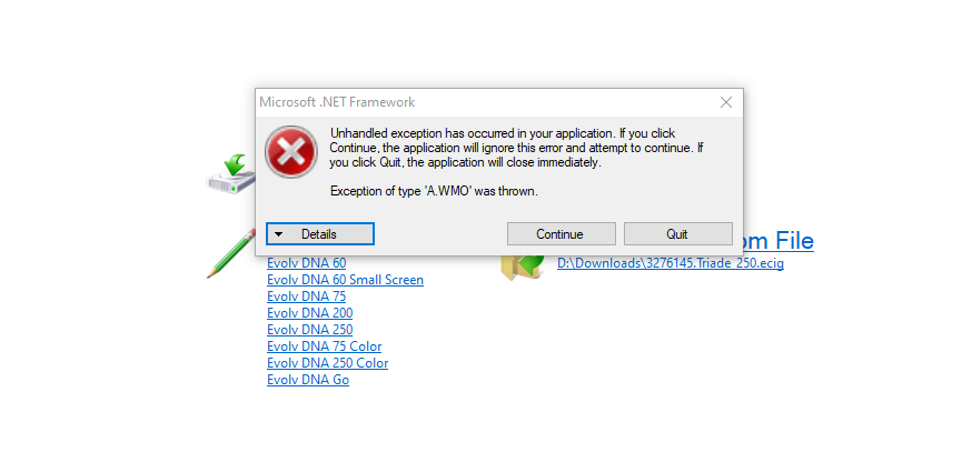

antonioo Posted May 7, 2020 Report Posted May 7, 2020 (edited) so this hapend... was about to install the 1.1 sp38 on my dna250c , something went wrong and got an error.. since than my mod is dead... tried this from Jetro but naah didnt work , comes to 10% mby 13% and gets this error , after pressing "ok" the other error comes up tried sp33 and sp 35 but same thing Edited May 7, 2020 by antonioo link messed up everything
antonioo Posted May 7, 2020 Author Report Posted May 7, 2020 3 hours ago, dwcraig1 said: Have you tried using a different USB cable? Ill try when i come home , any other suggestions maybe?
dwcraig1 Posted May 7, 2020 Report Posted May 7, 2020 Perhaps try a different USB port, preferably one on the back of computer. (If desktop) 1 1
antonioo Posted May 7, 2020 Author Report Posted May 7, 2020 18 minutes ago, dwcraig1 said: Perhaps try a different USB port, preferably one on the back of computer. (If desktop) u were right! its the port looks like it wont work on usb 3.0 thank you bro! 1
dwcraig1 Posted May 7, 2020 Report Posted May 7, 2020 1 hour ago, antonioo said: u were right! its the port looks like it wont work on usb 3.0 thank you bro! I almost mentioned about not playing well with USB 3.0 2
