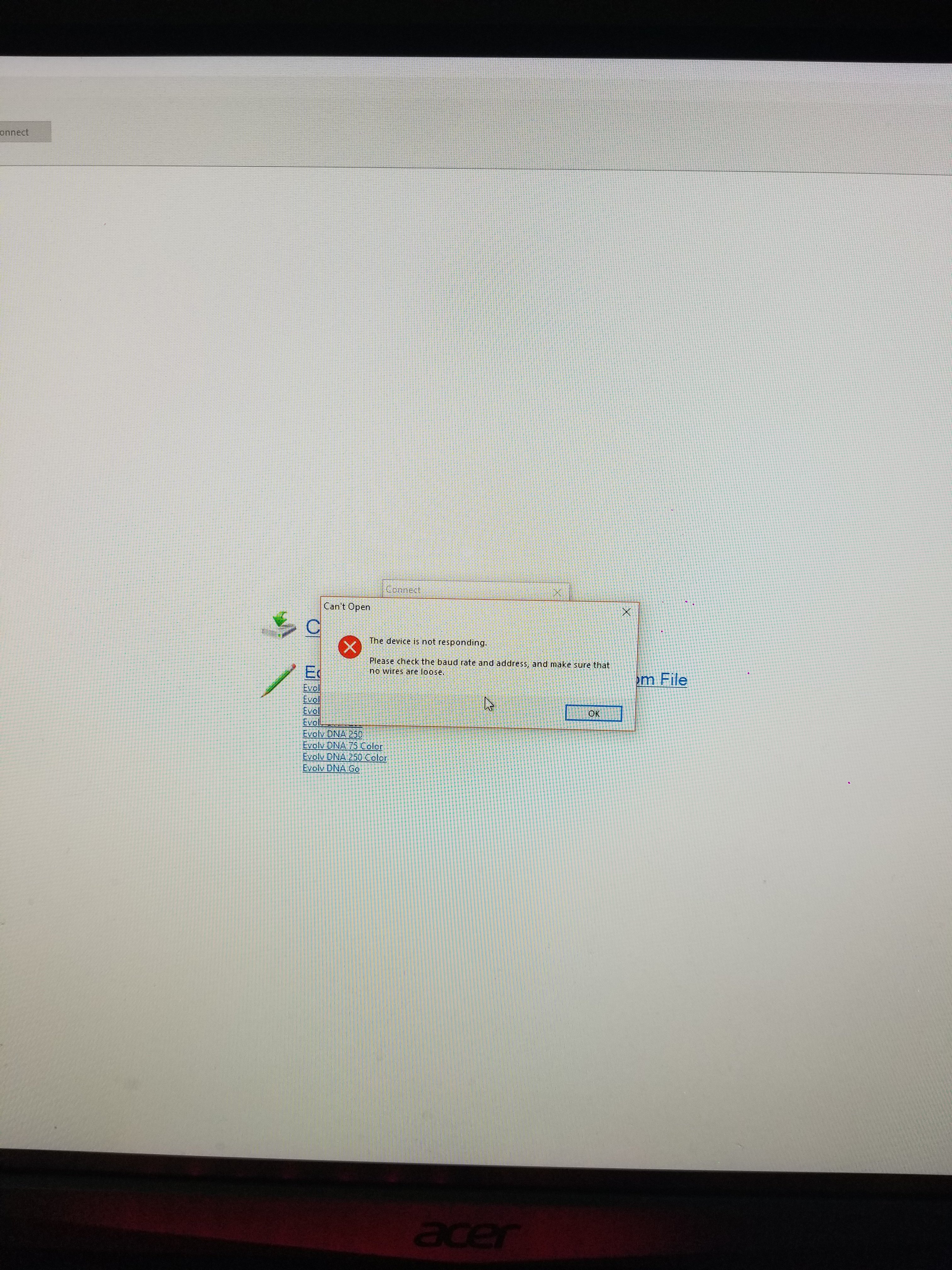

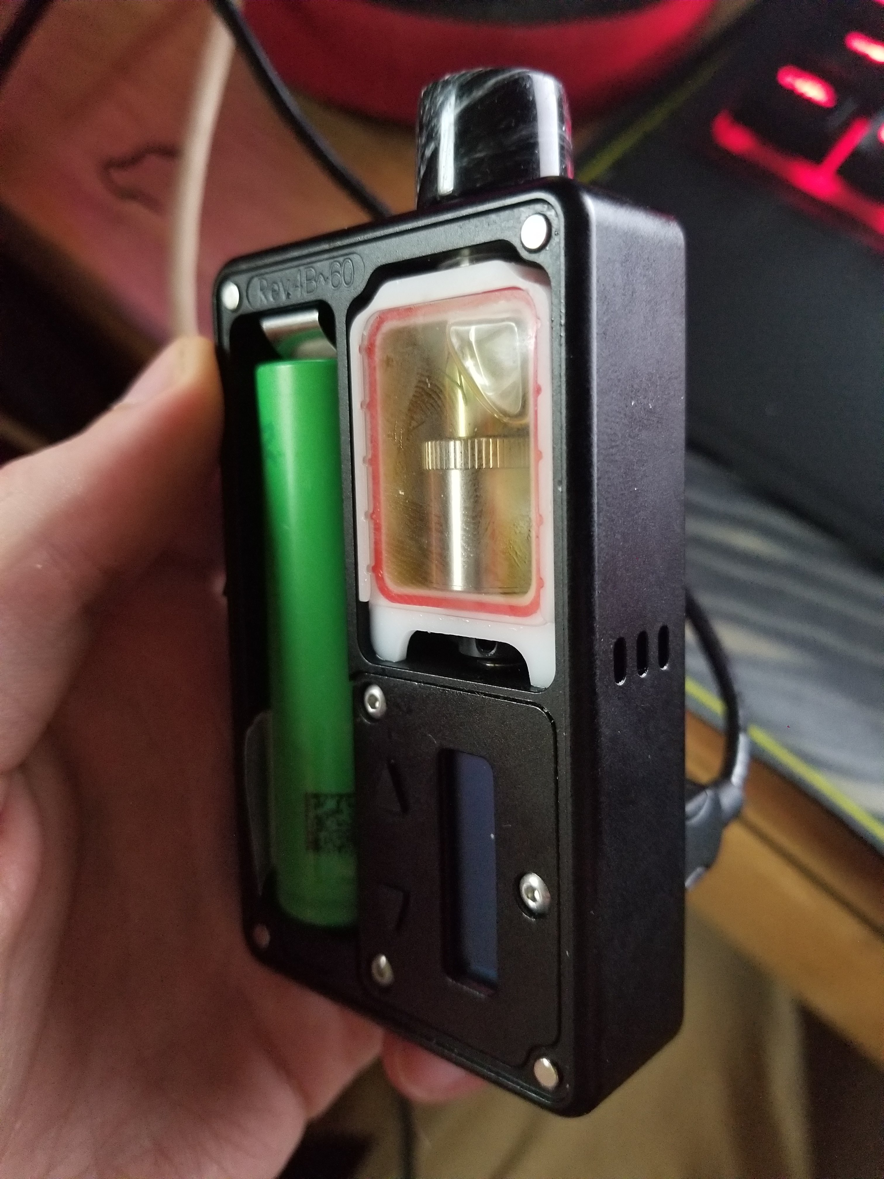

Hi guys, I have a serious problem and I don't know how to fix it. I was performing an update on my DNA 60 billet box and it failed half way through. Now my mod will not turn on, light up, or vape. It will not show up in escribe and the only thing that happens is a small led next to the usb turns on when I plug it in. Is there anything I can do to fix the mod or is it bricked? Please help!

I just tried to apply the service pack and it did not work.
This is the info the dialogue box gave back to me:

Okay guys i figured it out. Using a USB 3.0 port was the issue. I tried to fix the mod all last night and was unable to do a thing to it. Wake up this morning, try switching it over to a USB 2.0 port and boom, service pack applied without a hitch and now my device is back to its usual self.
