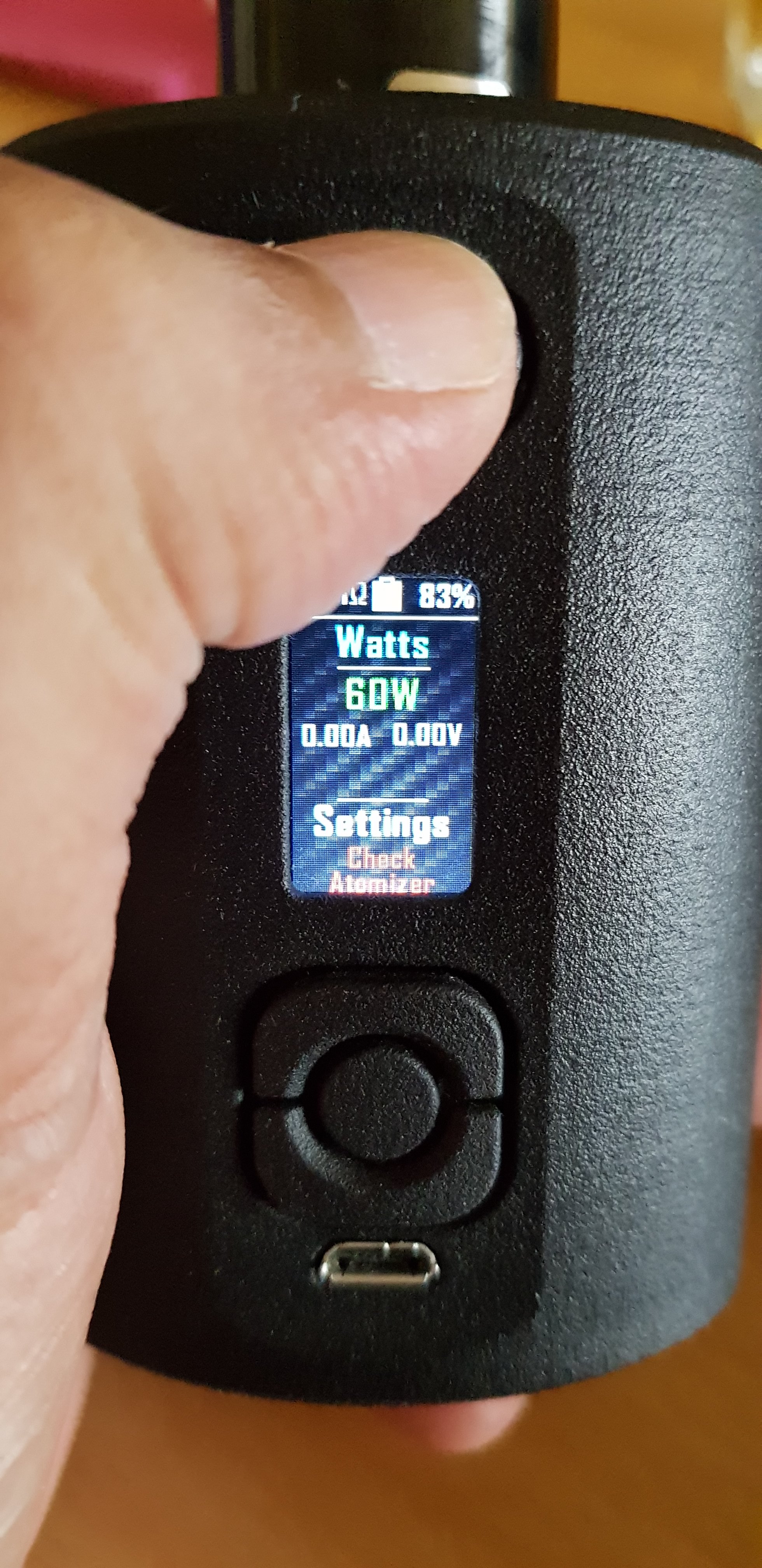

drmaz2000 Posted September 2, 2018 Report Share Posted September 2, 2018 Hello .. My Boxer DNA250c showing me ( check atomizer ) when pressing the Fire bottom. The RDA's coil is perfect and works on my other mod !! What's the problem and how can i solve it ? Thank you .. Link to comment Share on other sites More sharing options...
dwcraig1 Posted September 2, 2018 Report Share Posted September 2, 2018 Generally "check atomizer" means no connection between the board and coil. Check to see if the 510 center pin on the mod's 510 is farther down than it should be, compare to your other mod. Using Escribe's Atomizer analyzer would also be helpful to figure out why. Does the use of other atomizers on the Boxer result in the same? Link to comment Share on other sites More sharing options...
drmaz2000 Posted September 2, 2018 Author Report Share Posted September 2, 2018 46 minutes ago, dwcraig1 said: Generally "check atomizer" means no connection between the board and coil. Check to see if the 510 center pin on the mod's 510 is farther down than it should be, compare to your other mod. Using Escribe's Atomizer analyzer would also be helpful to figure out why. Does the use of other atomizers on the Boxer result in the same? yes , it gives the same result. But .. i tried to loose somehow the center pin of the RDA and it worked good. It seems like you said, the 510 connection is more down and i don't know why !! should i disassemble the mod itself and manipulate the 510 connector form inside ? 1 Link to comment Share on other sites More sharing options...

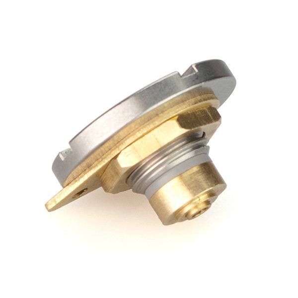

dwcraig1 Posted September 2, 2018 Report Share Posted September 2, 2018 If you think you can and won't void any warranty. (Boxer's, that won't effect Evolv's) I don't know which 510 socket they used but some have a threaded plastic insulator that can be pushed downward, Loctite can be applied to the insulator threads to help hold it in place. I used Super Glue Gel to keep the one that I have like that in place. ( a tiny speck applied with a tooth pick) With seeing it you''ll have a better idea as to the fix I suppose. Below is Fatdaddy Vapes v3 that I'm referring to. Link to comment Share on other sites More sharing options...
