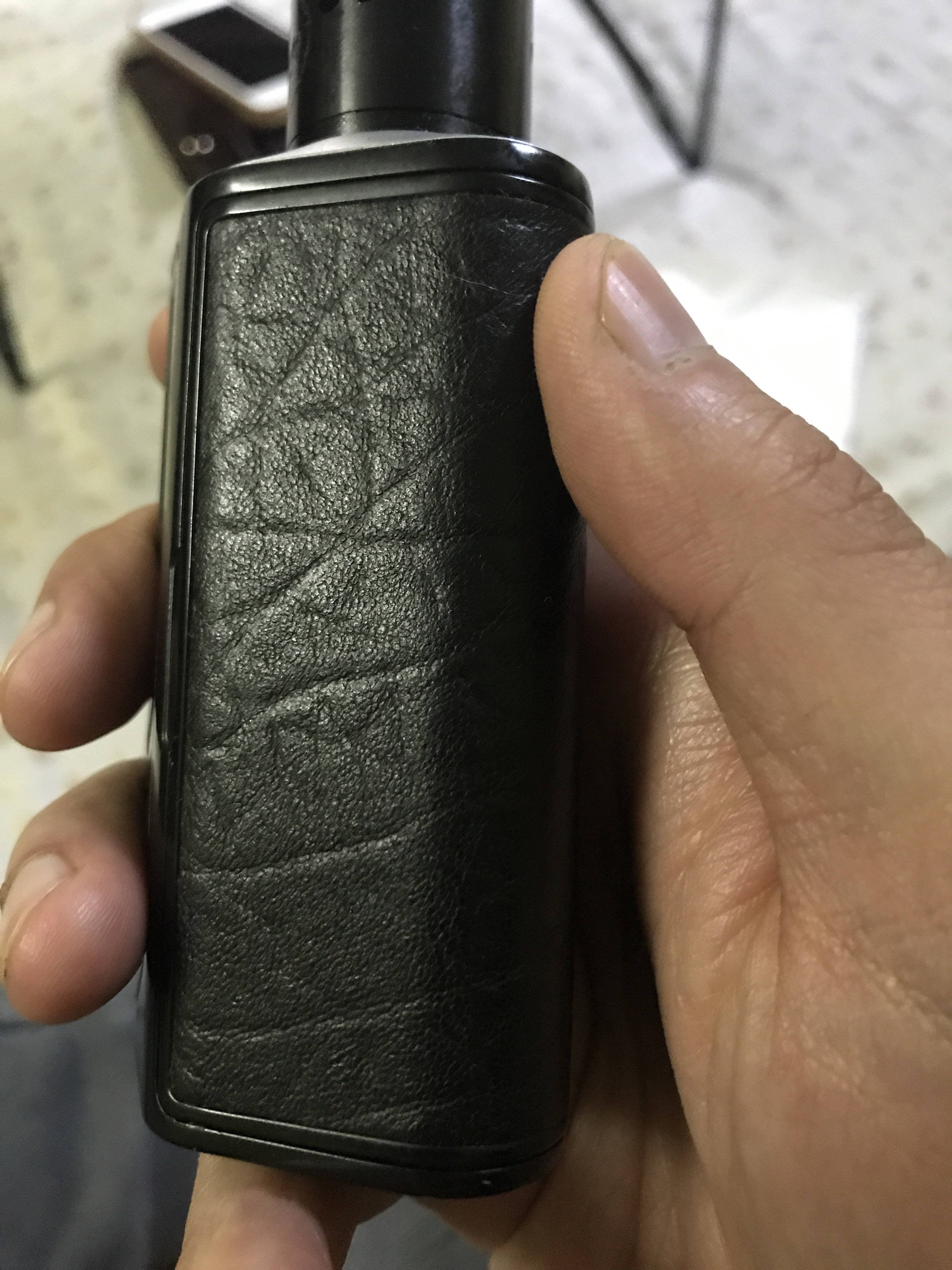

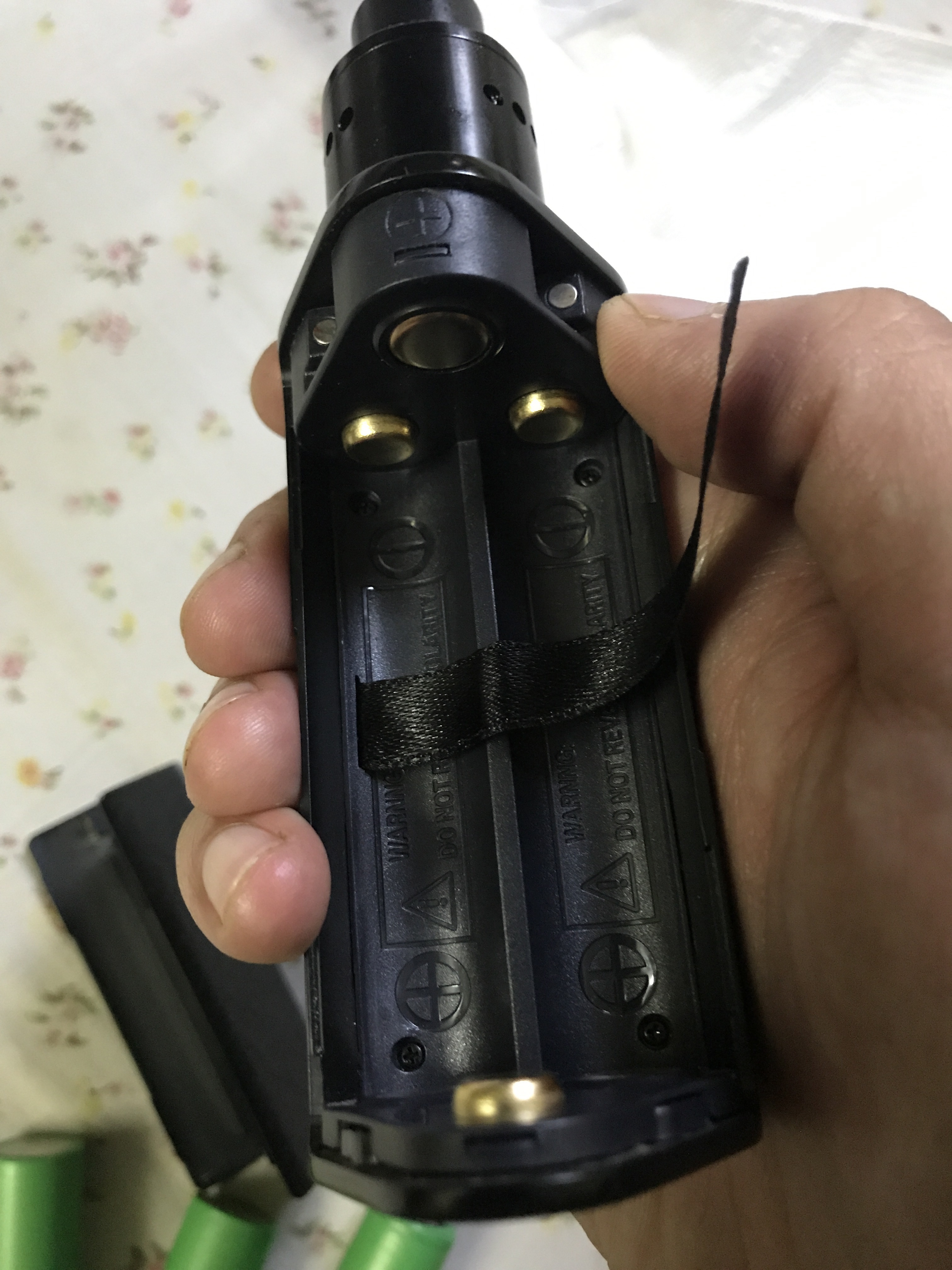

Longlobster Posted November 10, 2017 Author Report Share Posted November 10, 2017 Yes it fits like a new I guess. I am going to post two photos. Can you please look at it? Link to comment Share on other sites More sharing options...
dwcraig1 Posted November 11, 2017 Report Share Posted November 11, 2017 Frame appears good, did you try cleaning the sled contacts? (even though they appear clean) Link to comment Share on other sites More sharing options...
