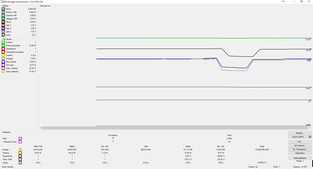

Posdnaco Posted October 27, 2017 Report Share Posted October 27, 2017 Hi guys! I always been more than happy with my VT250S DNA 250 but now i have a problem... My box wont charge using usb charger or computer usb port. The only way is using an external 18650 charger... Do you have any ideas? As you can see in the image there are no charge current (and in the dispay the little "thunder" wont appear) the bow wont charge. Link to comment Share on other sites More sharing options...
Abdul0786 Posted October 30, 2017 Report Share Posted October 30, 2017 First save your profile. Restore everything to default. Check your mod with different USb cable. Remove the batteries from the mod and try connecting the USB and check if it shows any power input . If it shows power input in device monitor , there might be the battery connector or wiring problem . Really I don't know if the issue is with the USB connector or battery connector . Link to comment Share on other sites More sharing options...
