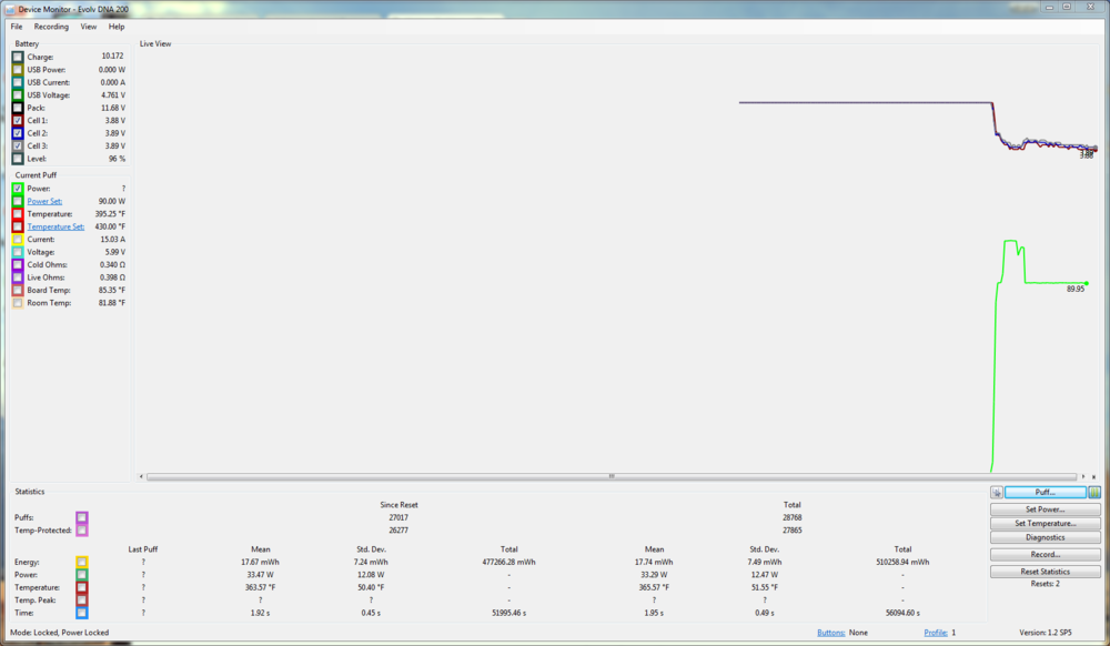

dwcraig1 Posted October 18, 2017 Report Share Posted October 18, 2017 Using Device Monitor in Escribe take note of the voltage drop on the cells when firing. Here is an example, in my case the voltage dropped from 4.1 volts to 3.88 volts. If yours is dropping to/below cell soft cutoff the board will reduce power. 1 Link to comment Share on other sites More sharing options...
